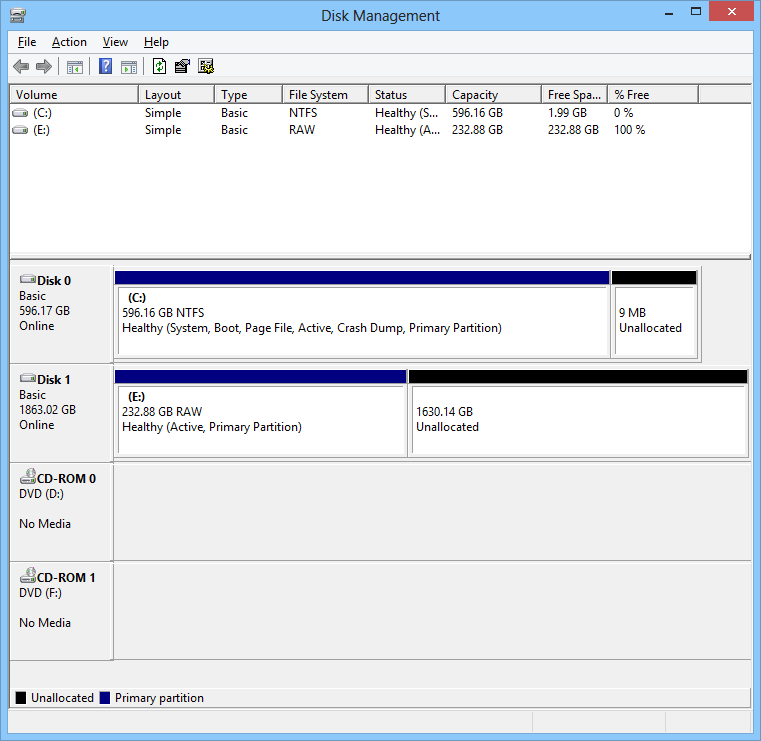

I've been looking everywhere, but for the life of me can't figure out what to do. Ran Photorec for a couple of weeks with months estimated to go so decided to abort, hoping to fix my 2TB external disk (one single partition) and save my data with Testdisk.
The disk shows up in Disk Management, part RAW and part unallocated.

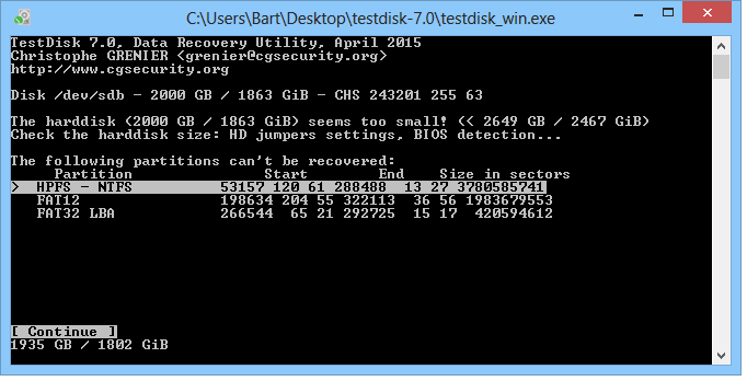

After a deep search with Testdisk I see 3 partitions: NTFS, FAT12 and FAT32 and it tells me "the harddisk seems too small" .
After continuing with any of the partitions selected I get no info whatsoever and am forced to start a quick search again.

Please post the testdisk.log file content including the result of Deeper Search.
