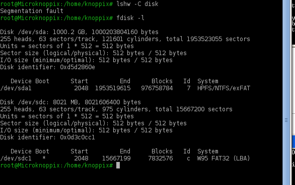

When I attempt to follow the instructions in your link, I get the error "Segmentation fault" when typing lshw -C disk and when typing fdisk -l, it only shows my flash drive (that I'm booting up from).
terrorist96
Posts: 6
Joined: 09 Oct 2015, 05:03
Re: Can't write to partition [log]
#4 Post by terrorist96 »
The 1000GB you see listed is an external I've attached for the purposes of cloning.
