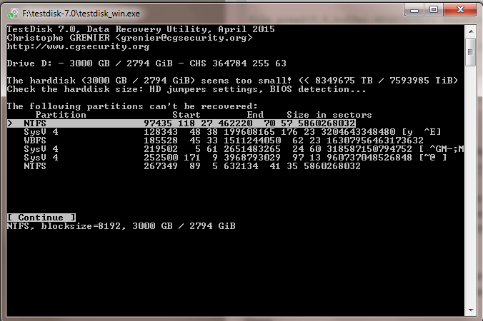

Hello there,
My 3TB Toshiba HDD on MS Windows 7 computer all of a sudden became RAW.
Testdisk found only FAT16 partition (which is incorrect - there is NTFS). I follow an advice from the forum topic and perform RebuildBS from advanced menu. After that I could see my NTFS partition, but there are no files listed in there.
I used testdisk to run deeper search (it took about 3 days), and got a list of 7 (or so) partitions with 2 NTFS and warning "the following partitions can't be recovered" before the list. The only option was "continue". After I continued, I got a list (longer than before) of partitions, all marked as P. I put cursor on what I thought is the best match for my data and press Enter (maybe this was a mistake). Eventually I found myself in the main menu with no deeper search result (frustrating!!).
So, I'm quite puzzled. Is it impossible to recover the data from the disk? If it possible, what should I do and what was my mistake? Should I run deepersearch again? Could you please advise my steps?
Thank you!
The log from testdisk is below the cristaldisk report.
CristalDiskInfo shows no errors

Sun Oct 18 18:31:10 2015
disk_get_size_win32 IOCTL_DISK_GET_LENGTH_INFO(/dev/sdb)=500103634432
disk_get_size_win32 IOCTL_DISK_GET_LENGTH_INFO(/dev/sdd)=801569726464
disk_get_size_win32 IOCTL_DISK_GET_LENGTH_INFO(/dev/sde)=801569726464
disk_get_size_win32 IOCTL_DISK_GET_LENGTH_INFO(\\.\PhysicalDrive1)=500103634432
disk_get_size_win32 IOCTL_DISK_GET_LENGTH_INFO(\\.\PhysicalDrive3)=801569726464
disk_get_size_win32 IOCTL_DISK_GET_LENGTH_INFO(\\.\PhysicalDrive4)=801569726464
disk_get_size_win32 IOCTL_DISK_GET_LENGTH_INFO(\\.\C:)=120031478784
disk_get_size_win32 IOCTL_DISK_GET_LENGTH_INFO(\\.\D:)=3000457232384
disk_get_size_win32 IOCTL_DISK_GET_LENGTH_INFO(\\.\E:)=500105217024
disk_get_size_win32 IOCTL_DISK_GET_LENGTH_INFO(\\.\F:)=500080539136
disk_get_size_win32 IOCTL_DISK_GET_LENGTH_INFO(\\.\G:)=3000458729472
filewin32_getfilesize(\\.\J:) GetFileSize err Incorrect function.
filewin32_setfilepointer(\\.\J:) SetFilePointer err Incorrect function.
Disk /dev/sda - 120 GB / 111 GiB - CHS 14593 255 63, sector size=512
Disk /dev/sdb - 500 GB / 465 GiB - CHS 60800 255 63, sector size=512
Disk /dev/sdc - 500 GB / 465 GiB - CHS 60801 255 63, sector size=512
Disk /dev/sdd - 801 GB / 746 GiB - CHS 97451 255 63, sector size=512
Disk /dev/sde - 801 GB / 746 GiB - CHS 97451 255 63, sector size=512
Drive C: - 120 GB / 111 GiB - CHS 14592 255 63, sector size=512
Drive D: - 3000 GB / 2794 GiB - CHS 364784 255 63, sector size=512
Drive E: - 500 GB / 465 GiB - CHS 60800 255 63, sector size=512
Drive F: - 500 GB / 465 GiB - CHS 60797 255 63, sector size=512
Drive G: - 3000 GB / 2794 GiB - CHS 364784 255 63, sector size=512
Partition table type: None
Analyse Drive D: - 3000 GB / 2794 GiB - CHS 364784 255 63
NTFS at 0/0/1
filesystem size 5860268032
sectors_per_cluster 16
mft_lcn 393216
mftmirr_lcn 1
clusters_per_index_record -12
NTFS at 0/0/1
P NTFS 0 0 1 364784 207 31 5860268032
NTFS at 0/0/1
mft_lcn 393216
mftmirr_lcn 1
NTFS, blocksize=8192, 3000 GB / 2794 GiB
Write isn't available because the partition table type "None" has been selected.
Failed to open inode: Input/output error.
NTFS at 0/0/1
mft_lcn 393216
mftmirr_lcn 1
NTFS at 0/0/1
dir_partition inode=5
ntfs_readdir failed for cluster 5: Input/output error

NTFS at 364784/207/31
mft_lcn 393216
mftmirr_lcn 1
NTFS found using backup sector, blocksize=8192, 3000 GB / 2794 GiB
The harddisk (3000 GB / 2794 GiB) seems too small! (< 8349675 TB / 7593985 TiB)
NTFS 97435 118 27 462220 70 57 5860268032
SysV 4 128343 48 38 199608165 176 23 3204643348480 [yВ ДF]
SysV4, 1640 TB / 1492 TiB
WBFS 185528 45 33 1511244050 62 23 16307956463173632
WBFS, 8349673 TB / 7593984 TiB
SysV 4 219502 5 61 2651483265 24 60 318587150794752 [кn»за]
SysV4, 163116 TB / 148353 TiB
SysV 4 252500 171 9 3968793029 97 13 960737048526848 [Ђ ]
SysV4, 491897 TB / 447378 TiB
NTFS 267349 89 5 632134 41 35 5860268032
P FAT12 529 142 30 529 188 11 2880 [EFISECTOR]
P FAT12 1961 187 19 1961 232 63 2880 [EFISECTOR]
P NTFS 1961 247 34 1962 90 33 6174
P NTFS 1962 90 33 1962 188 32 6174 [Boot]
P FAT12 2339 115 49 2339 161 30 2880 [EFISECTOR]
P FAT12 2339 161 31 2339 207 12 2880 [EFISECTOR]
P FAT12 2341 31 11 2341 76 55 2880 [EFISECTOR]
P NTFS 2341 91 38 2341 189 37 6174
P NTFS 2341 189 37 2342 32 36 6174 [Boot]

As I mentioned in the previous message, I RebuildBSed boot sector, and after that testdisk could see the NTFS partition (actually, the disk has no partitions, as I recall, just the plain disk) .
Here is the screenshot I took after the deepersearch has conducted.
Screenshot after DepperSearch has been conducted.
Screenshot 2015-10-21 10.00.42.png (35.29 KiB) Viewed 4618 times
I have no idea what are the listed partitions came from (except NTFS). Which of the NTFS partition I should "restore"? Which seems more likely as "right" one from the numbers on the screenshot? I'm not good with disks and filesystems at all, just followed "Step-by-step"guide and the forum posts.

Re: the following partitions can't be recovered
#4 Post by Fiona »
Under TestDisk / disk selection, you should select Disk instead of a drive and have another try.
Only disk contains a partition table, which would be available under the menu Advanced.

Fiona, thank you for the advice. I think, I finally figured out what I shoud do.
Alas, my BIOS is not capable to determine 3TB disk (shows 801GB instead and no BIOS update for my Asus p5q-e...).
So, the list of files (in Advanced->List) shows nothing, but for another 3TB disk (healthy) it reflects actual file list. Maybe BIOS is not a problem.
I started another Quick Search (chose disk instead of drive, as you suggested), it will take about 12-15 hours and probably helps to get filelist to recover.

Seems like I reached the impasse.
My BIOS has no update (last was in 2009) and don't allow to properly analyse the disk (not drive) since shows only 801GB instead of 3TB.
Performing DeeperSearch on drive (not disk) results two partitions: NTFS (matching size) and FAT32(smaller size, never existed on the disk) And even DeeperSearch detects NTFS table (appears in results), when continue it shows only FAT32 partition ( with voulme lower than 3TB). Marking FAT table to delete results no partitions.
Advanced menu shows some bogus partitions with filesystems I don't even know exist and strange volumes.
My idea to remove the disk and run TestDisk on the laptop will not works: as I understand, TestDisk only allow to copy files, not to restore the files on the disk. Since my laptop has 256GB disk (free about 20Gb), no place to copy.
So, I started "chkdsk /f d:" as cgrenier suggested, and if it doesn't helps, than ... Just format it with all data lost.
