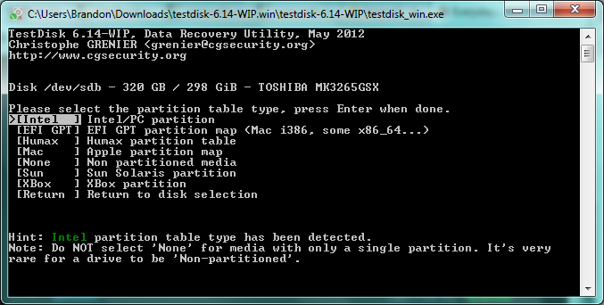

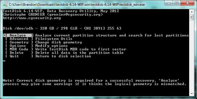

Oh, of course. Sorry; I'm a little sleep deprived. Here's the screenshots. If I've given you the wrong information (again), let me know.
- TestDisk3.png (39.5 KiB) Viewed 18815 times
- TestDisk2.png (38.27 KiB) Viewed 18815 times
- TestDisk1.png (41.7 KiB) Viewed 18815 times

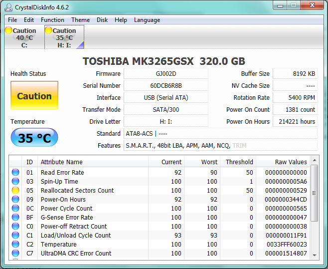

Also check your status of your disk using CrystalDiskInfo.
Because there is still a description about checking your current partition table.
Would it be possible just two wait up to 2 minutes.
If you don't get any info and TestDisk still hangs, please let me know .
It's not possible to make a boot sector diagnose if you have no partition, because the first sector of a partition is the boot sector.
Dysharmonic
- Posts: 8
- Joined: 23 May 2012, 12:00
Re: RAW Hard Drive
I've waited hours, and it only goes to 5% before hanging. Here's what CrystalDisk says.
- CrystalDisk.png (82.17 KiB) Viewed 18809 times

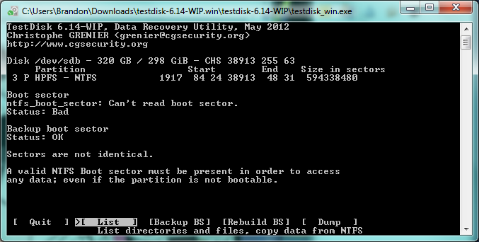

Re: RAW Hard Drive
Well, looks like that I need to sleep too!Just noticed the Edit post function. I need sleep...
Because I found a screen with your current partition table here;
http://forum.cgsecurity.org/phpBB3/down ... php?id=551
Your partition diplays that your boot sector is not valid.
Select your affectedpartition and upload a screen.
Confirm at Boot.
If you see the menu list, please check it and press p to list your files.
If your files are not listed but an error message or TestDisk hangs, please let me know.
Please let us know, do you see your data or an error message.
Infos will follow.

Re: RAW Hard Drive
How do I know which partition is the affected one?
[EDIT] Nevermind; the one that showed up twice in the earlier step, I think. What's my next step?
- TestDisk7.png (41.04 KiB) Viewed 18800 times
- TestDisk6.png (30.71 KiB) Viewed 18805 times
