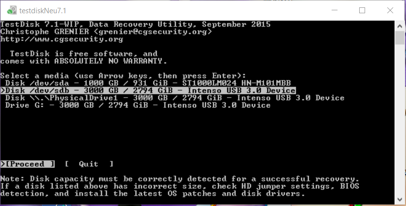

Can you run TestDisk on your disk instead of a drive?
Drive is like a partition.
Only a disk has a partition table and delivers correct results.
Please use the latest version of TestDisk 7.1WIP and 32bit.
Your disk should be available under disk selection and looks like:
Disk / dev / sd* (*=a,b,c).
Can you repeat your diagnose and copy and paste the content of your testdisk.log into your next post?
You'll find it within your testdisk folder.
Select found partitions by TestDisk and press p on your keyboard to have a try to lisdt your files.

Re: You need to format the disk in drive before you can use
Posted: 21 Nov 2015, 16:00
No, there is no necessity to run your windows explorer.
After starting TestDisk, the first display is log file creation.
Pressing enter takes you to your disk selection.
At this display you should select your affected Disk instead of your drive.
You can watch it here as an example:
My selected Disk is "Disk /dev/sdb".
It's my Intenso USB 3.0 Device.
The last Device is Drive G: and also my Intenso USB 3.0 Device.
At this display you should select your Disk and not your Drive.
Posted: 21 Nov 2015, 16:53
Don't use TestDisk 64bit.
There is a description that some features are missing.
It's only intended for genuine 64bit computer like Itanium etc..
Here is your download link:
http://www.cgsecurity.org/Download_and_ ... IP.win.zip
Then, I open it in my Computer downloads folder (it's correct then to run test disk in my computer "C:" disk?
Yes you can run it within your download folder.
It doesn't matter, because I run testdisk within my download folder too!
But you should unzip it.
