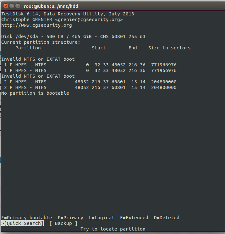

Hello, I am trying to use Testdisk to recover an NTFS HDD used as a backup drive from Windows, it has two partitions, one of 100GB and another using the rest of the 500GGB drive. I think it was damaged because the caddy seemed to have a dodgy power connection. (I no longer use that caddy!)
The result of Analyse under TestDisk is:
Screenshot from 2015-12-01 23-04-04.png (63.33 KiB) Viewed 8050 times
This appears to be correct, though each partition is listed twice.
I then run Quick Search and then deeper search, each time it finds just one partition and gives the error message "The following partition can't be recovered."

Re: The following partition can't be recovered
Posted: 02 Dec 2015, 08:16
When a message like "invalid NTFS or exFAT boot" appears, testdisk displays the message and the affected partition.
That's why they appear twice!

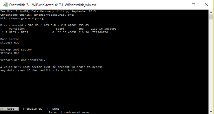

I downloaded the 7.1WIP 32bit version and followed your instructions:
This shows the output of Testdisk / Advanced / Boot on the first (larger) partition:

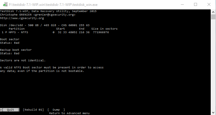

I then selected Rebuild BS (as both the boot sector and backup have Status: Bad), this ran overnight, in the morning it had returned me to an identical screen, I took a screenshot but it is identical to the one above:
What should I do now?
