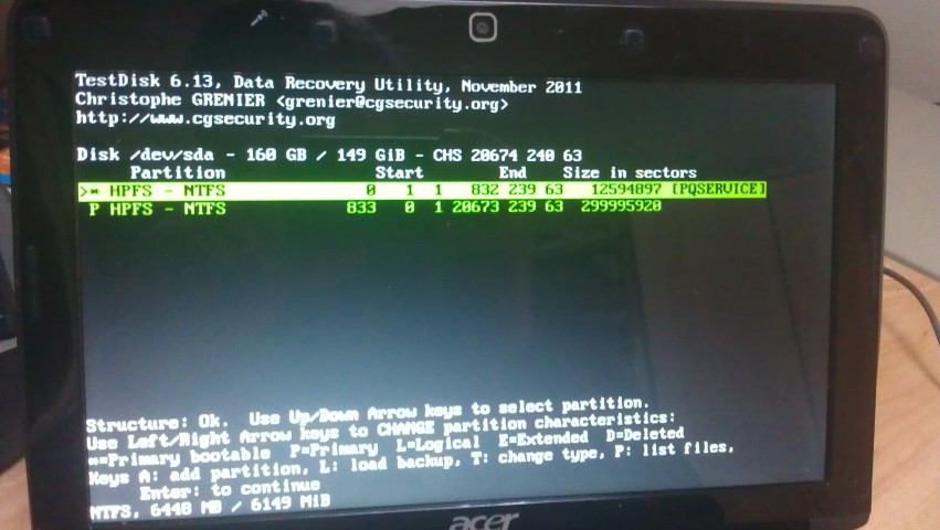

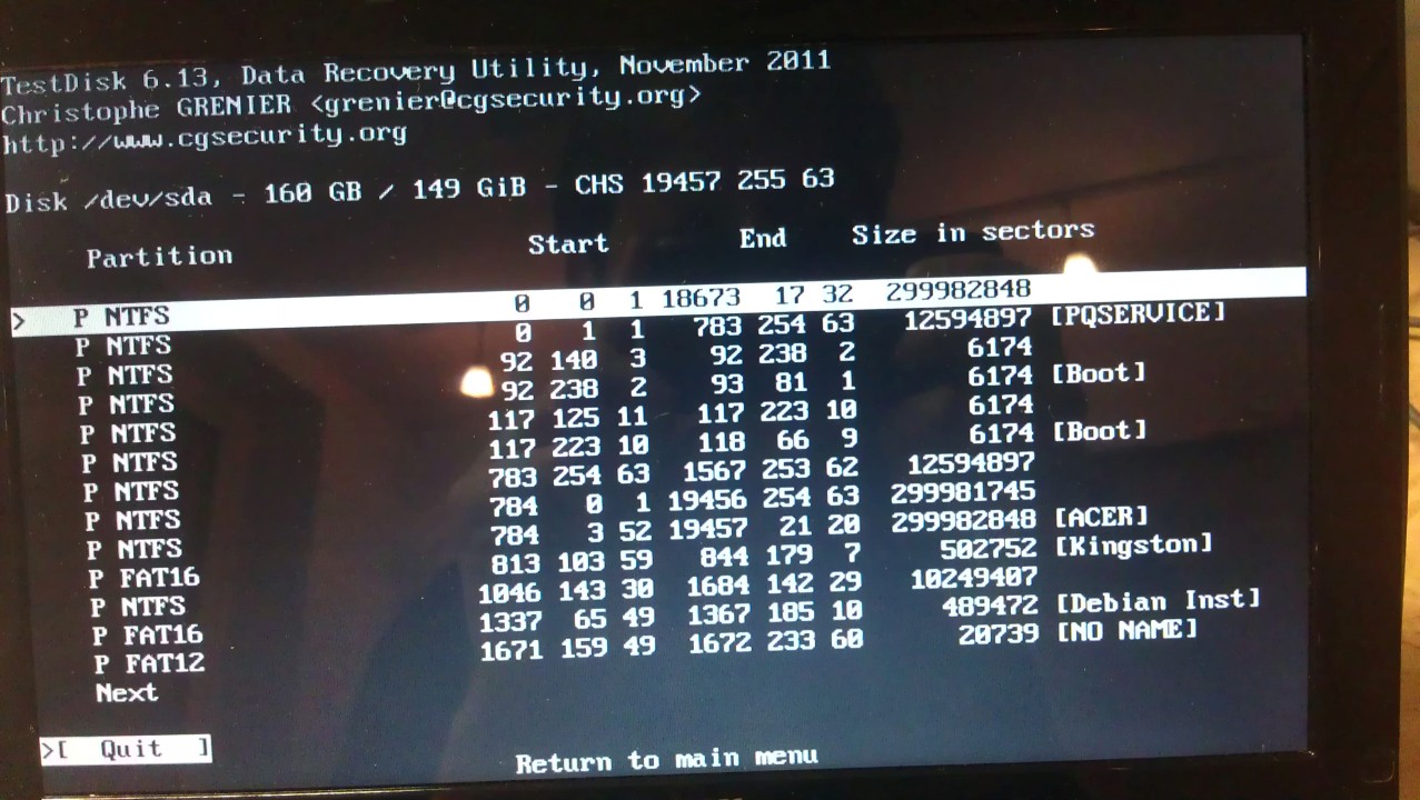

Thanks Fiona, attached are some photos of different results.
I'm not sure what you mean by 'how your disk is listed', I hope the attached files do show the required information.

Re: Partition found table type None, but not using NTFS
Posted: 03 Mar 2012, 19:43
On this screen;
http://forum.cgsecurity.org/phpBB3/down ... .php?id=42
Your Acer-partition is listed.
Did you try to list your data and from that partition above too?
As far as I've seen, your partition table contains one partition using the complete space.
Your PQService partiton doesn't matters at the moment.
It'll be considered when your acer partition is found correctly.

- NTFS - Quick Search
- None - Deeper Search
And ACER (the one with the label) on image 5-None-deep-result.jpg, start [784, 3, 52], only with None - Deeper Search

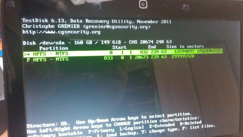

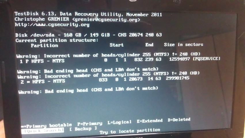

Using partition table type Intel, and changing the Heads to 240 in geometry, these are the results.
I still can browse the found PQService partition, but not the other one.
When starting the Quick Search or the Deeper Search I also get a warning
"Warning: the current number of headers per cylinder is 250 but the correct value may be 255. You can use the Geometry menu to change this value. (...)"
