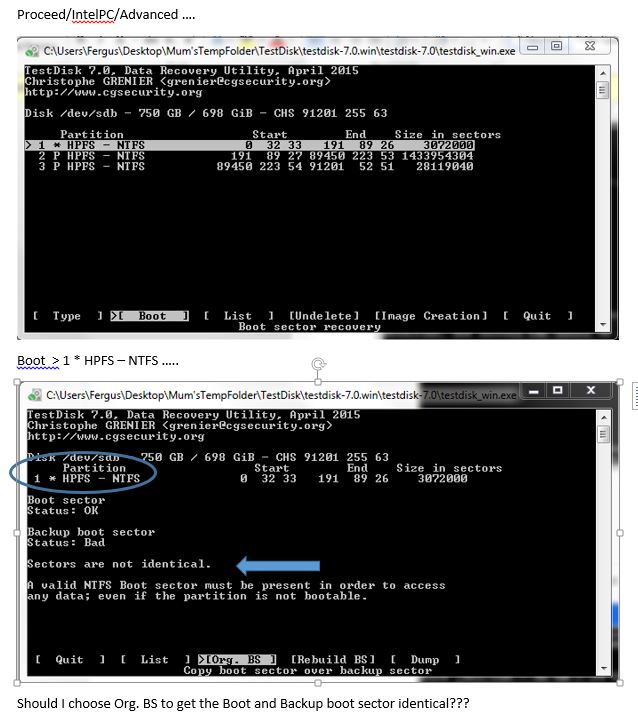

When I first used TestDisk to view the hard drive's contents, it identified the hard disk correctly as Drive F with a capacity of 750GB [Unfortunately, I chose not to create a log - big mistake#1] with a Partition Type of "Intel/PC".
Following the TestDisk Step by Step Guide, I then chose to "Analyse" the disk and it resulted in listing 3 partitions (even though the list did not actually say Partition 1, Partition 2 etc).
The first (the smallest) was listed with an asterick showing it was bootable - a list of the files showed boot folder etc, so appeared OK (from this novice's perspective)
The second (the largest) was listed with a "P" showing it as primary - a list of files showed what looked like my disk contents, so I was ecstatic thinking I was on the right track.
The third was also listed with a "P" showing as primary - a list of files showed also a boot folder and I think a recovery folder, so wasn't quite sure what this was for.
Since the partitions did not list as Partition 1, Partition 2 and Partition 3 respectively, I thought I would have to WRITE the partition table and then reboot [big mistake#2].

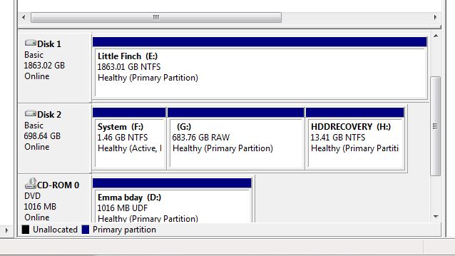

After rebooting, I ran TestDisk again and then found that the three "partitions" now showed up as three separate drive letters F, G & H (see attachment of Disk Management Image).
Now when I run TestDrive on each of the three drives, the Partition Type comes up as "None" and Analysis comes back with errors.

Without more information, the only problem I see is that G: is listed as RAW.
H: (HDDRECOVERY) was probably hidden before using TestDisk, so let's ignore it for the moment.
Is F: (System) ok ?

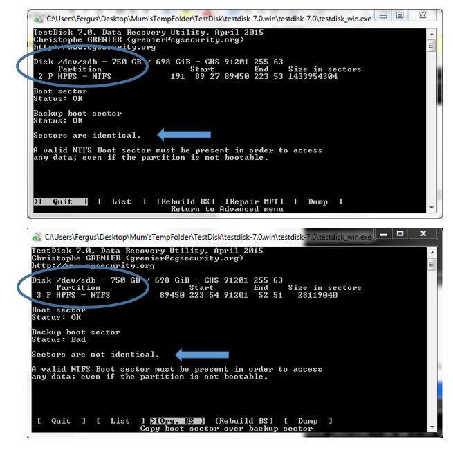

If you run TestDisk, select /dev/sdb, PC/Intel, Advanced, select the second partition (G:), Boot, List. Do you see your files ? If it's ok, if available, choose BackupBS and confirm, Quit

I can see my files on the second partition G to some extent. When I look into the Document and Settings folder, there is nothing present (see attachment).
The BackupBS is not available.
I have selected all files on the 2nd partition (G) and copied them, but this does not give me my documents etc...only what I can see in TestDisk.
Not sure what to do from here? Is the problem with G: listed as RAW have anything to do with why I cannot see my documents and files further?
Also, when I analyse each of the partitions.....the 1st (F:) and 3rd (H:) partitions have damaged backup boot sectors but the 2nd (G:) partition have identical Boot and Backup Boot Sectors. Not sure if this is significant? See screenshots below
I am about to start a Deeper Search on the 2nd (G:) partition to see if that shows up any of my files.
If it doesn't, I am thinking of using PhotoRec to try to recover my files - do you think this will work given the above info?
