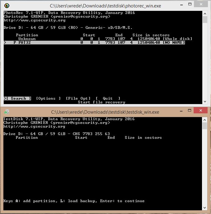

i need some help. today i had my samsung micro sd card (64GB) which usually is used by my mobile phone, plugged in my notebook (win8.1) in order to delete and copy some files. after doing so i disconnected the device and put it back to my mobile. unfortunately the micro sd did not show up, so i tried it with my notebook again: "Insert Disk". OMG!
I managed to restore thousands of files with photorec, but without any directory or file name, moreover most of them where deleted files i do not want to recover.
however testdisk fails to find any partition, as well with "quick search" as with "deep search".
please look at the screenshots - can you give any advice how to restore the old partition?
thank a lot!
thank a lot!
- screenshot of testdisk and photorec
- td_pr.JPG (72.36 KiB) Viewed 18338 times

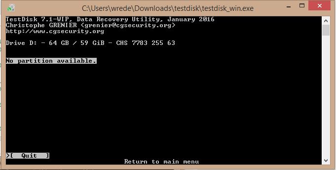

Re: Micro SD lost Partition
Hi Fiona,
thank you very much for your reply, unfortunatly i don`t see this option.
I attached a screenshot of my 4 steps and a log - what shall i do different?
thanks a lot & greets!
Fri Jan 15 08:43:24 2016
TestDisk 7.1-WIP, Data Recovery Utility, January 2016
OS: Windows 8 (9200)
Compiler: GCC 4.9, Cygwin32 2002.0
Compilation date: 2016-01-07T18:42:01
disk_get_size_win32 IOCTL_DISK_GET_LENGTH_INFO(\\.\D:)=64020807680
Drive D: - 64 GB / 59 GiB - CHS 7783 255 63, sector size=512 - Generic- xD/SD/M.S., FW:1.00
Drive D: - 64 GB / 59 GiB - Generic- xD/SD/M.S.
Analyse Drive D: - 64 GB / 59 GiB - CHS 7783 255 63
file_win32_pread(444,2,buffer,125040639(7783/107/4)) read err: read after end of file
- advanced dialog
- advanced.JPG (35.62 KiB) Viewed 18328 times
- regular analyse
- 1-4.JPG (101.68 KiB) Viewed 18329 times
Did you use TestDisk 64bit?
TestDisk 7.1WIP 32bit is recommended.
Actually all disks should be listed and not your SD Card as a Drive only?
I'll download the latest release and test it too.
It's unusual?
Edit:
Already tested and it works.
See attachment I've selected an 64 GB USB flash drive.
It's unusual?
Edit:

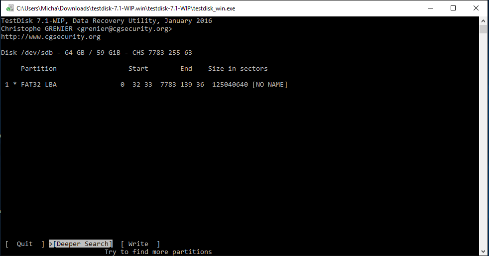

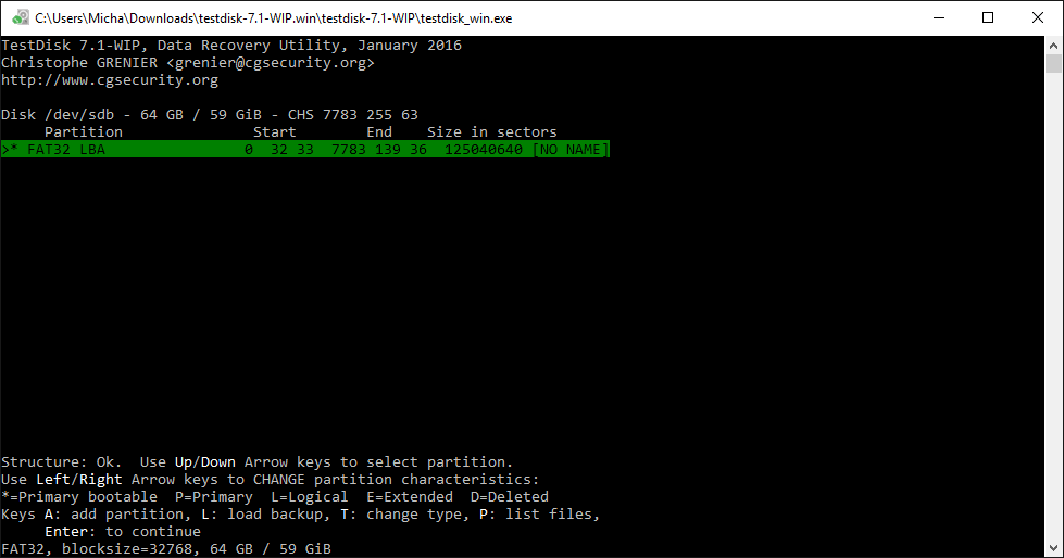

Hey Fiona,
das sieht m.E. schon besser aus. Soll ich einfch mal auf "write" klicken oder lieber nicht?
DANKE DIR!!
DANKE DIR!!
- n1.PNG (26.06 KiB) Viewed 18306 times
- n2.PNG (22.49 KiB) Viewed 18306 times
- n3.PNG (19.05 KiB) Viewed 18306 times
Hattest du deine Daten anschauen können?
Wenn die Partition markiert ist, geht es mit p drücken.
yep, das klappt problemlos.
An deiner Stellle würde ich ertsmal alle Daten und Ordner kopieren.
Beim Listen der Daten werden unten am Screen alle Befehle angezeigt.
Hinterher sollte versucht werden die Karte zu Formatieren um sie wieder einsatzfähig zu bekommen.
