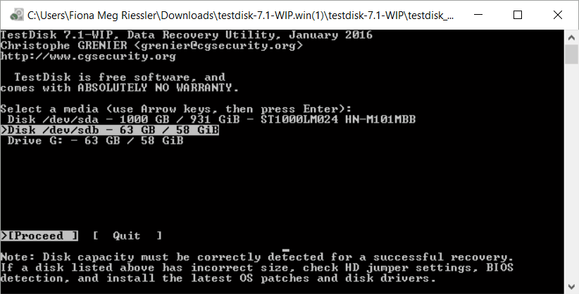

Can you repeat your diagnose and can you select your card as disk instead of a drive?
It looks like Disk /dev/sd* (*=a, b, c, etc..).
Only disk displays your partition table at Analyse and your current partition structure.

Did you use TestDisk 64bit?
TestDisk 7.1WIP 32bit is recommended.
Actually all disks should be listed and not your SD Card as a Drive only?
I'll download the latest release and test it too.
It's unusual?
Edit:
Already tested and it works.
See attachment
I've selected an 64 GB USB flash drive.
