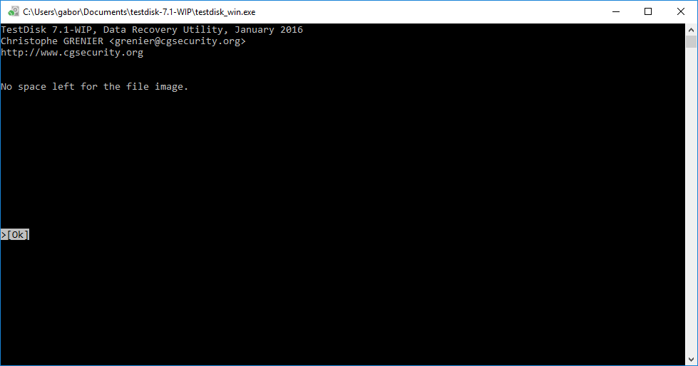

After the image creation stops, the image will be saved. Everything is fine, if the destination directory is the current "testdisk-7.1-WIP".
If the destination directory is changed to an another, e.g. up one folder, error message comes up, after image creation ends.
This:
But there is enough space on drive.

#4 Post by szg0000 »
The problem remains.

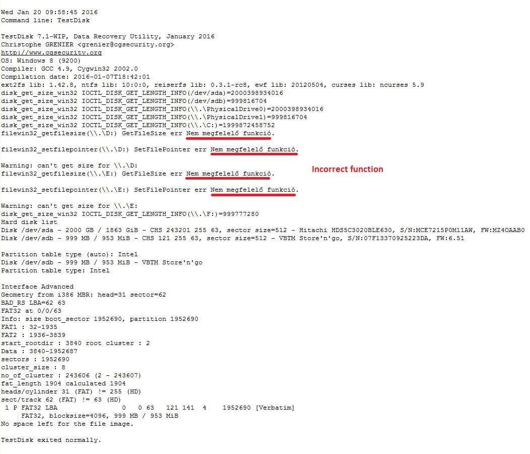

I was not able to upload TXT file, because "The extension log is not allowed." error message comes up when I tried.
I attached in JPG file, with some error message translation, because my windows is speaking hungarian. I am using windows 10, 64bit, this is not in the log file.

So, I downloaded the latest, as you mentioned. The logfile has differecies.
The diff. is:
disk_image pwrite() failed: Illegal seek
This error message in ~7500 lines.
After 7500 line of this message comes:
No space left for the file image.

Still some error messages in the logfile,
filewin32_getfilesize(\\.\D:) GetFileSize err Nem megfelelő funkció.
filewin32_setfilepointer(\\.\D:) SetFilePointer err Nem megfelelő funkció.
filewin32_getfilesize(\\.\E:) GetFileSize err Nem megfelelő funkció.
filewin32_setfilepointer(\\.\E:) SetFilePointer err Nem megfelelő funkció.
But no problem with "Image creation" function.
