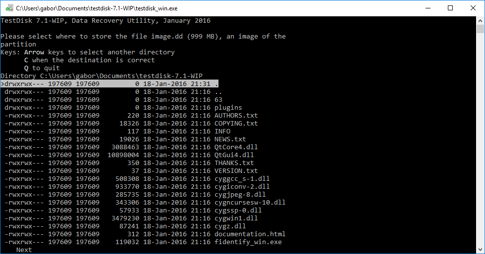

After entering into "Image creation" tool, you can choose the destination directory of the image.
Here:
2016-01-18 (1).png (44.21 KiB) Viewed 7790 times
After the image creation stops, the image will be saved. Everything is fine, if the destination directory is the current "testdisk-7.1-WIP".

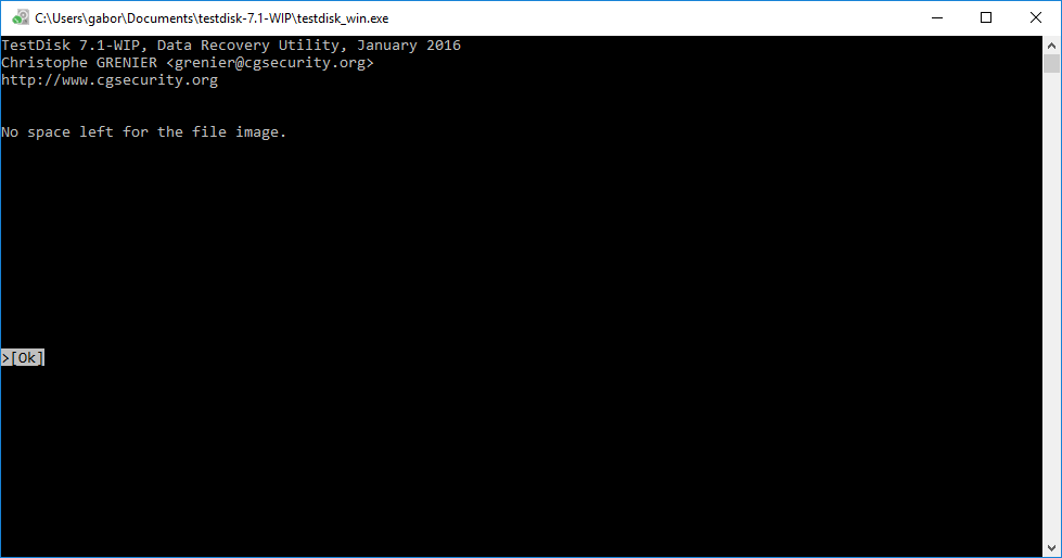

If the destination directory is changed to an another, e.g. up one folder, error message comes up, after image creation ends.
This:
But there is enough space on drive.

Standard path as the destination is the testdisk folder.
When you'd like to change the directory, you can mark these two dots at the upper area of the display and pressing enter?
Each time you'll get 1 directory up until you see all drives.
There you can choose another drive and when you'd like to copy your image to another folder, you can select a folder and enter it using the right arrow key on your keyboard and starting the copying process.

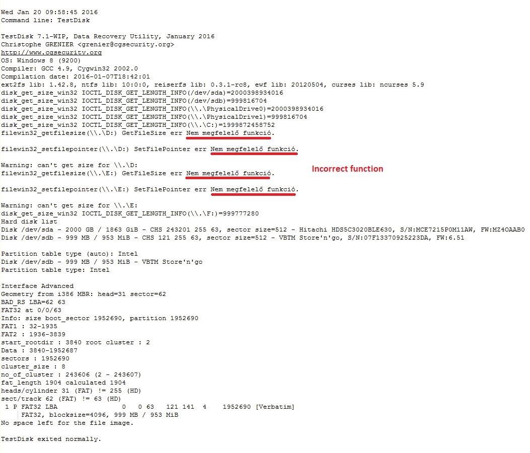

I was not able to upload TXT file, because "The extension log is not allowed." error message comes up when I tried.
I attached in JPG file, with some error message translation, because my windows is speaking hungarian. I am using windows 10, 64bit, this is not in the log file.

So, I downloaded the latest, as you mentioned. The logfile has differecies.
The diff. is:
disk_image pwrite() failed: Illegal seek
This error message in ~7500 lines.
After 7500 line of this message comes:
No space left for the file image.
