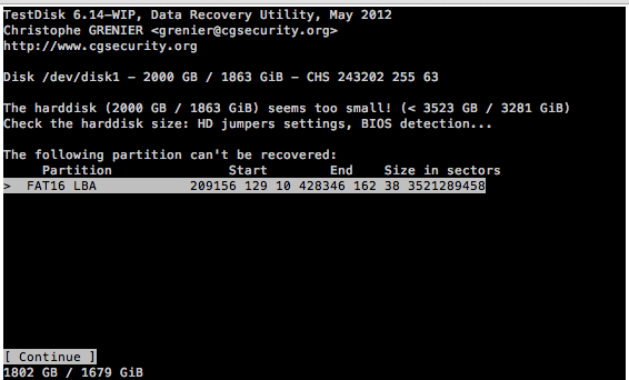

Hi all, I have a problem with external 2TB Western Digital drive.
I was coping one file when it stopped and doesn't mount either in windows and in mac os.
I analyzed unsuccessfully 2 times, this is the message.
I changed the geometry of heads and sectors.
What you suggest?
Thank you.
Christian.
WD 2TB external drive unrecoverable
- message after 10 hours on deep search
- Screen Shot 2012-05-26 at 11.07.49 AM.png (31.15 KiB) Viewed 8739 times

Did you select intel or EFI ?
What's on the next screen (after continue ?)
Re: WD 2TB external drive unrecoverable
Yes I selected intel, cause it's formatted ntfs.
When I continue it says it's too damaged.
Yes of course, if a file system is seriously damaged, you can use PhotoRec to recover files.
But your message or screen only displays an unrecoverable FAT16 partition.
It looks wrong and has no significance.
Probably you should run Deeper Search?

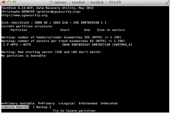

Hi Fiona, it seems strange to me too.
I changed geometry from 1 to 255 and from 16 to 63.
This was the status before I changed.
I launched 2 times deeper search with the same result.
I thought I could try with photorec, but I need another drive to copy such big files.
What do you suggest ti do before?
Thank you.
Thank you.
- Screen Shot 2012-06-11 at 5.45.08 PM.png (47.42 KiB) Viewed 8653 times
