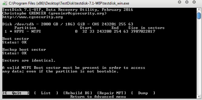

Thanks for the reply Admin. Appreciate that.
So I followed all the steps that you suggested me to do. And finally i got the result (see first attachment below)
Testdisk New.JPG (44.56 KiB) Viewed 10964 times
and then i reboot my computer. waiting for it to start.. and run chkdsk under admin rights. and still. no signs of hope yet. it still stuck at the blinking '-' (see second attachment)
with this i attached my testdisk log file.

68 dr-xr-xr-x 0 0 0 29-Oct-2015 22:20 $RECYCLE.BIN
16365 dr-xr-xr-x 0 0 0 7-Feb-2016 23:01 Hitachi Red
367 dr-xr-xr-x 0 0 0 28-Feb-2016 00:16 MV
368 dr-xr-xr-x 0 0 0 7-Feb-2016 22:58 Muse
627 dr-xr-xr-x 0 0 0 28-Feb-2016 00:16 New folder
640 dr-xr-xr-x 0 0 0 29-Feb-2016 08:09 Pirates Of The Carribean
172042 dr-xr-xr-x 0 0 0 28-Feb-2016 00:13 RECYCLER
16324 dr-xr-xr-x 0 0 0 4-Jan-2016 08:03 System Volume Information
67 dr-xr-xr-x 0 0 0 7-Feb-2016 23:03 Transcend
103434 dr-xr-xr-x 0 0 0 7-Feb-2016 23:14 VAIO Drive RED
601 -r--r--r-- 0 0 93953810 13-Feb-2016 11:41 -Over You- - Blake Shelton Live.mp4
601 -r--r--r-- 0 0 26 13-Feb-2016 11:41 -Over You- - Blake Shelton Live.mp4:Zone.Identifier
594 -r--r--r-- 0 0 39358492 13-Feb-2016 11:26 Cassadee Pope Over You The Voice Full HD.mp4
594 -r--r--r-- 0 0 26 13-Feb-2016 11:26 Cassadee Pope Over You The Voice Full HD.mp4:Zone.Identifier
380 -r--r--r-- 0 0 85637008 13-Feb-2016 12:15 Kelly Moncado - Please Forgive Me (Bryan Adams cover).mp4
380 -r--r--r-- 0 0 26 13-Feb-2016 12:15 Kelly Moncado - Please Forgive Me (Bryan Adams cover).mp4:Zone.Identifier
595 -r--r--r-- 0 0 79914794 13-Feb-2016 11:36 Miranda Lambert - Over You.mp4
595 -r--r--r-- 0 0 26 13-Feb-2016 11:36 Miranda Lambert - Over You.mp4:Zone.Identifier
593 -r--r--r-- 0 0 8379621 13-Feb-2016 10:57 Nidji - Hapus Aku.mp3
593 -r--r--r-- 0 0 26 13-Feb-2016 10:57 Nidji - Hapus Aku.mp3:Zone.Identifier
filesystem size 3907022017 3907028992
sectors_per_cluster 8 8
mft_lcn 786432 786432
mftmirr_lcn 2 2
clusters_per_mft_record -10 -10
clusters_per_index_record 1 1
Write new boot!
ntfs_boot_sector
1 * HPFS - NTFS 0 32 33 243200 254 63 3907022017
NTFS at 0/32/33
NTFS at 0/32/33
mftmirr_lcn 2
Status: OK
Status: OK
Sectors are identical.
