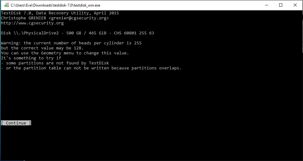

A Quick Search will not run but gives me the following error:
2 Quick Search
2 Quick Search

Also a Deeper Search with TestDisk got me the same error message as above with the wrong number of heads per cylinder.
