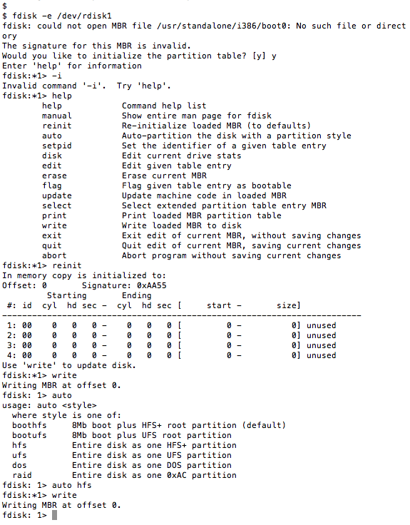

Thank you Fiona.
Yes, this is an EXT 1TB drive.
After I recovered the data with Testdisk, I attempted to format the drive with Disk Utilites in OSX. The process was partially completed, then failed with the error noted above.
I then tried Drive Genius and it failed to initialize the drive also. Techtools did not recognize the drive beyond indicated and ext drive was connected.
I then moved to terminal and tried to run Fdisk procedures shown in the attachment.
Test disk analysis shows the drive contains no partitions, so there is not much to work on.
Perhaps I need to look at another command line formating tool? Any suggestions?

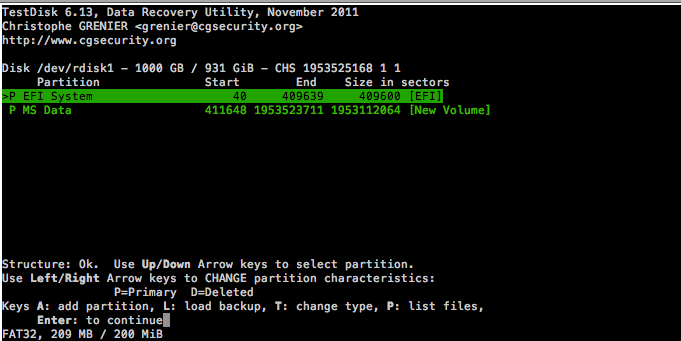

UPDATE:
I am able to mount this drive on a PC and format as NTFS. This newly formatted drive will mount on my mac as a generic empty drive.
However, when I try to format as HFS+ with disktutil or GUI app, the format fails, and the procedure renders the drive unreadable to the mac again.
But, I can now go back into test disk. This is what I get:
At this point, I'm not sure how to proceed.
- Testdisk sees the drive at /dev/rdisk1 (1000GB)
- Testdisk sees the partition table as [EFI GPT]
- Analysis produces the following errors:
"Warning: Incorrect number of heads/cylinder 255 (NTFS) != 1 (HD)
"Warning: Incorrect number of sectors per track 63 (NTFS) != 1 (HD)
(see below for screen caps)
/P on EFI presents another error: No file found, file system may be damaged.
