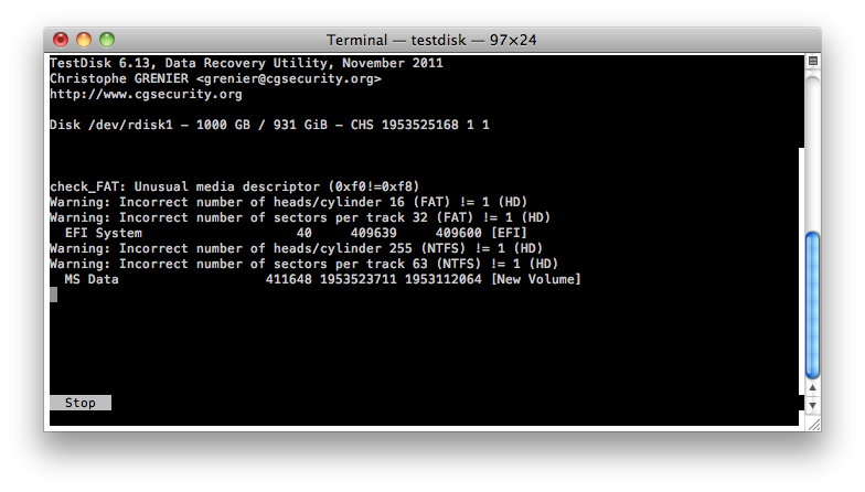

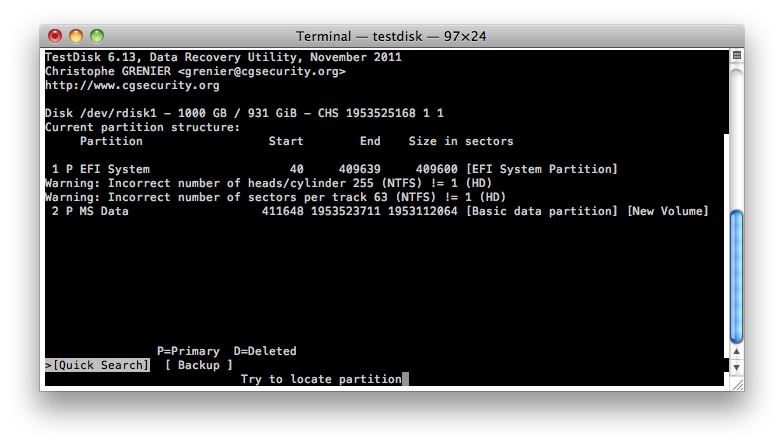

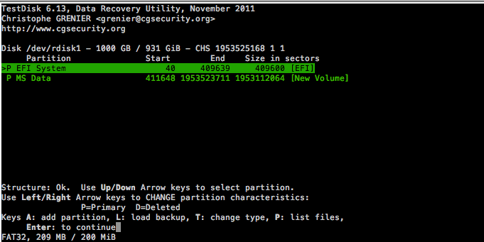

But, I can now go back into test disk. This is what I get:
  • Testdisk sees the drive at /dev/rdisk1 (1000GB)
  • Testdisk sees the partition table as [EFI GPT]
  • Analysis produces the following errors:
    "Warning: Incorrect number of heads/cylinder 255 (NTFS) != 1 (HD)
    "Warning: Incorrect number of sectors per track 63 (NTFS) != 1 (HD)
    (see below for screen caps)

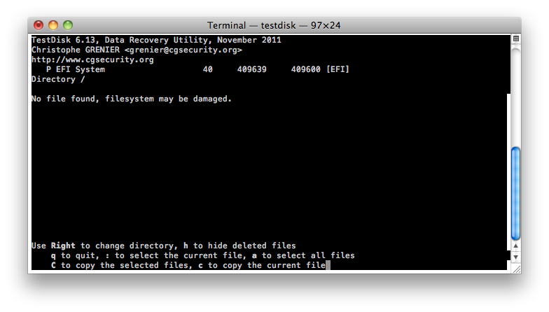

    /P on EFI presents another error: No file found, file system may be damaged.

Lastly Files on the EFI partition:
