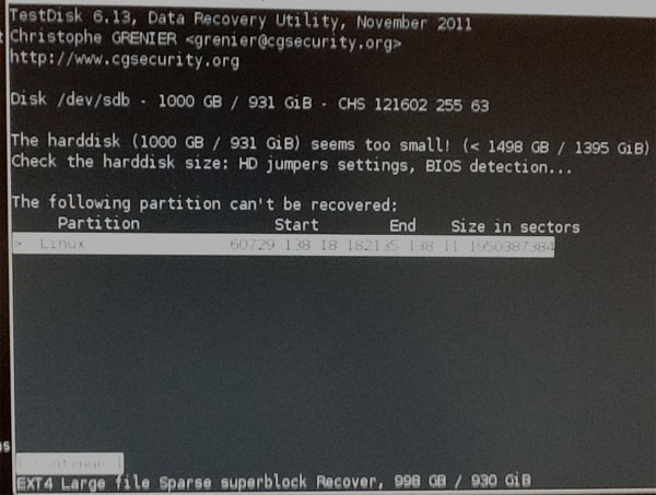

i had 1 disk in my Qnap 219 working as standalone disk with ext4 FS. I put in another disk "to be safer..." and than probably qnap had quick formated my disk and change "standalone" do raid1. After 4% progress I have stoped the process, turn off the qnap and get out the disks.
After I plug the disks to another computer with TestDisk I can't see my folders. What should I do ?. Im in trouble because till tomorow i have to recover those files...
br
NAbil and thanks for your help.
after analize, the harddisk seems too small ????

To find your initial partition, try "none" table type, options > align : no, quicksearch / deepersearc, and give feedback.
If a partition is found, do not use write, but try to list using "P" key.
Please use testdisk 6.14, last beta.
What is your operating system ?

thanks, chacking... but now i can see older structure of folders, now deepsearch
Re: problem with ext4
#4 Post by Fiona »
Did you already run deeper search?
If deeper search is finished, please check your found partitions pressing p to have a try to list your data.
