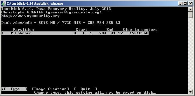

I put a card reader in my front USB 2.0 port. It was slow to respond. It didn't seem like it was writing or doing anything. So, I took it out. That proved to be a mistake. Now, my flash card is raw with a status of "Unknown partition". I made an image of the card with Testdisk. Here are my attempts so far.
-I have run Advanced setting. I set partition to None. I have set the card type at FAT32.
Step 3.jpg (76.83 KiB) Viewed 6512 times

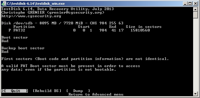

Step 4.jpg (102.1 KiB) Viewed 6512 times
Step 6.jpg (48.2 KiB) Viewed 6512 times
I also used Analyse and I received the error "Partition sector doesn't have the endmark 0xAA55".
I tried to rebuild the boot sector. Final result: Can't find cluster size. I did a boot sector dump. I don't know how to output the boot sector into text form so I will attach pictures in the next post.
