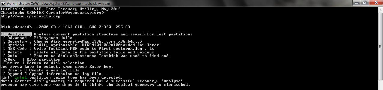

Terminals and consoles are often limited in lines and width.
TestDisk is based on ncurses.
This is a text user interface (TUI) like BIOS and Norton commander.
So it's not a CLI (command line interface) because it works using your arrow keys.
The advantage of a TUI is, it's easy portable to other operating systems.
Also, ncurses is limited in lines and width.
As far as I can remember, even Apple terminals are a little bit smaller?
In case you should ask the developer!

Thanks for the reply, Fiona. :) I understand that it's not a CLI program and works using arrow keys. Problem is, non-standard Elevated Command Prompt window sizes seem to throw off the program and successive options overwrite older ones instead of the lines being cleared properly first. If that's hard to understand, here's a screenshot (that I ought to have provided in my first post itself I guess):
See how the text from successive screen is all jumbled up? It gets so bad that a few screens in the program becomes unusable because I can't figure out what's going on!

Each report of problems related to TestDisk are highly appreciated.
If I see any problem related to TestDisk and PhotoRec I'll immediately forward it.
But before, I'd like to exclude any other problem.
Did you already restore the default values of your command prompt?
You should execute it as administrator.
Run your command prompt as an administrator.
Go to Start.
Write cmd in search programs and files.
Press both, the Ctrl-key and Shift and press enter.
Confirm to proceed your command prompt as administrator.
Uncheck the Quick Edit Mode from the properties and test it again.
Please let me know.

An Elevated Command Prompt window of the default size does not exhibit the problem noted above. As mentioned, only non-standard window sizes seem to trigger this issue. If there's anything else the devs would like to know, I'd be happy to oblige.
