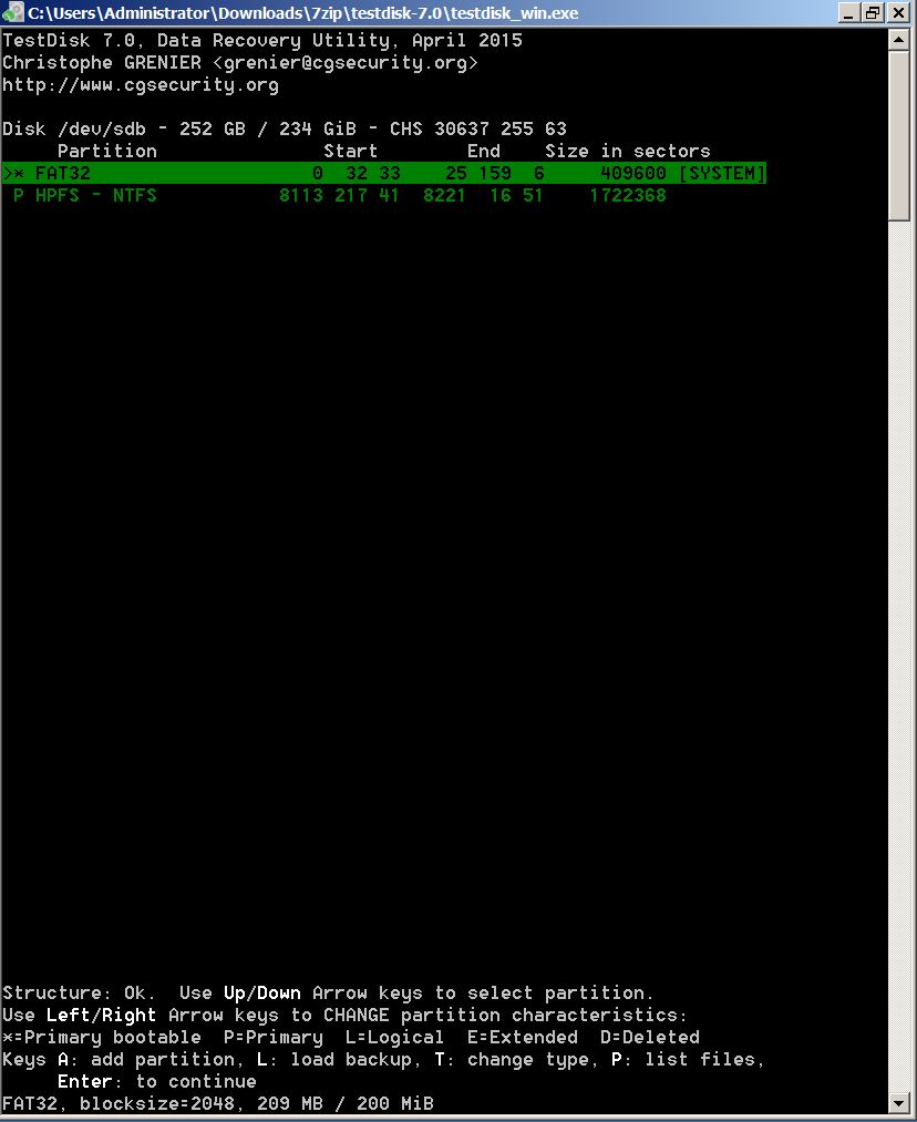

Unfortunately, I made a mistake while trying to reinstall windows in my primary partition (SSD). I use the command CLEAN, and of course the partitions disappear.
At that moment mi disk had:
Partition C - With OS and programs
Partition D - With All the files
I'm running test disk in a laptop with the SSD Drive connected in an external case
When analyse I saw the following
1) Analyse
01 - Analyse.JPG (92.37 KiB) Viewed 1598 times
I entered in the founded partitions and I saw that probably are not the ones that I'm looking for

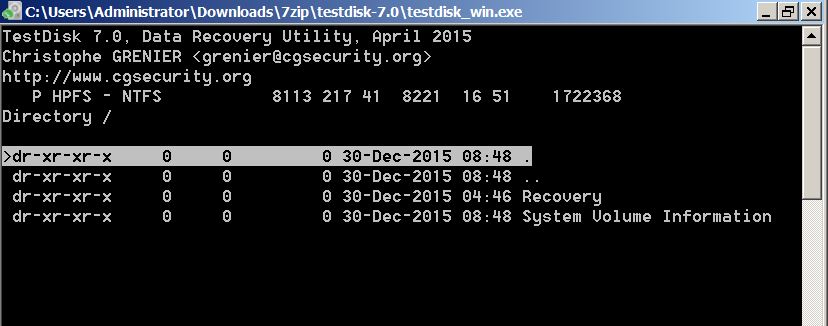

3) Files in NTFS Partition (I assume that was the original recovery partition that comes with the Asus UX31 Ultrabook)
03 - Files on NTFS Partition.JPG (52.3 KiB) Viewed 1598 times
I tried to find more partitions (ENTER when the analyse process finishes) but I couldn't
Really I don't know how to continue... Can somebody help me?
Re: HELP - SSD Disk Partition Lost after Windows CLEAN
If the partitions are not found by Analyse, Quick Search, Deeper Search, use photorec instead.
https://www.cgsecurity.org/wiki/PhotoRec_Step_By_Step
