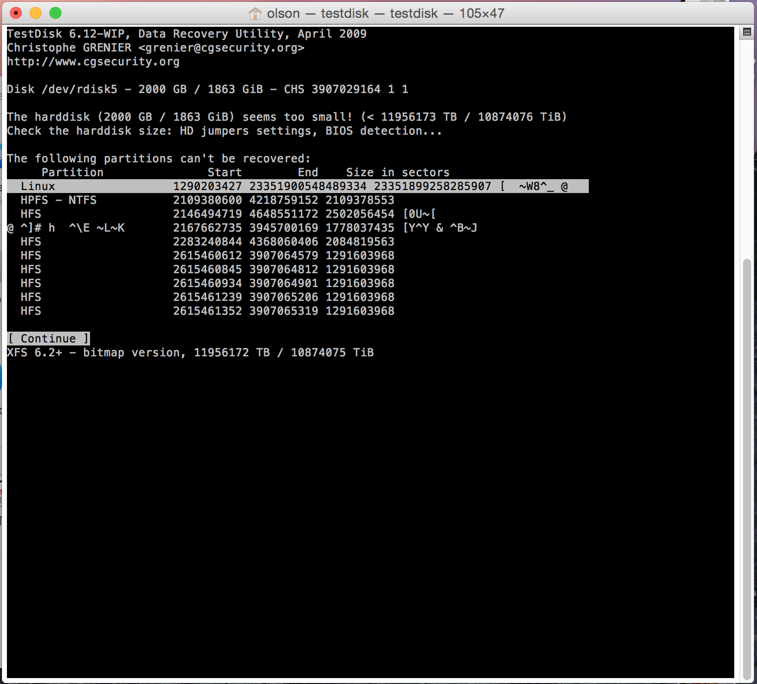

This was result in terminal, and I had no idea what to do and could not find answer anywhere:
partition scan.png (254.84 KiB) Viewed 2476 times
I feel like this was a waste of time if I want to recover partition table though? I'm not sure what that means, I am pretty scared by many of the possible commands I can select in testdisk. I feel like I am only understanding fragments of the problem or solution at a time and thus could easily make a detrimental mistake.

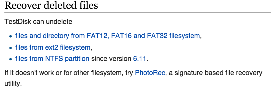

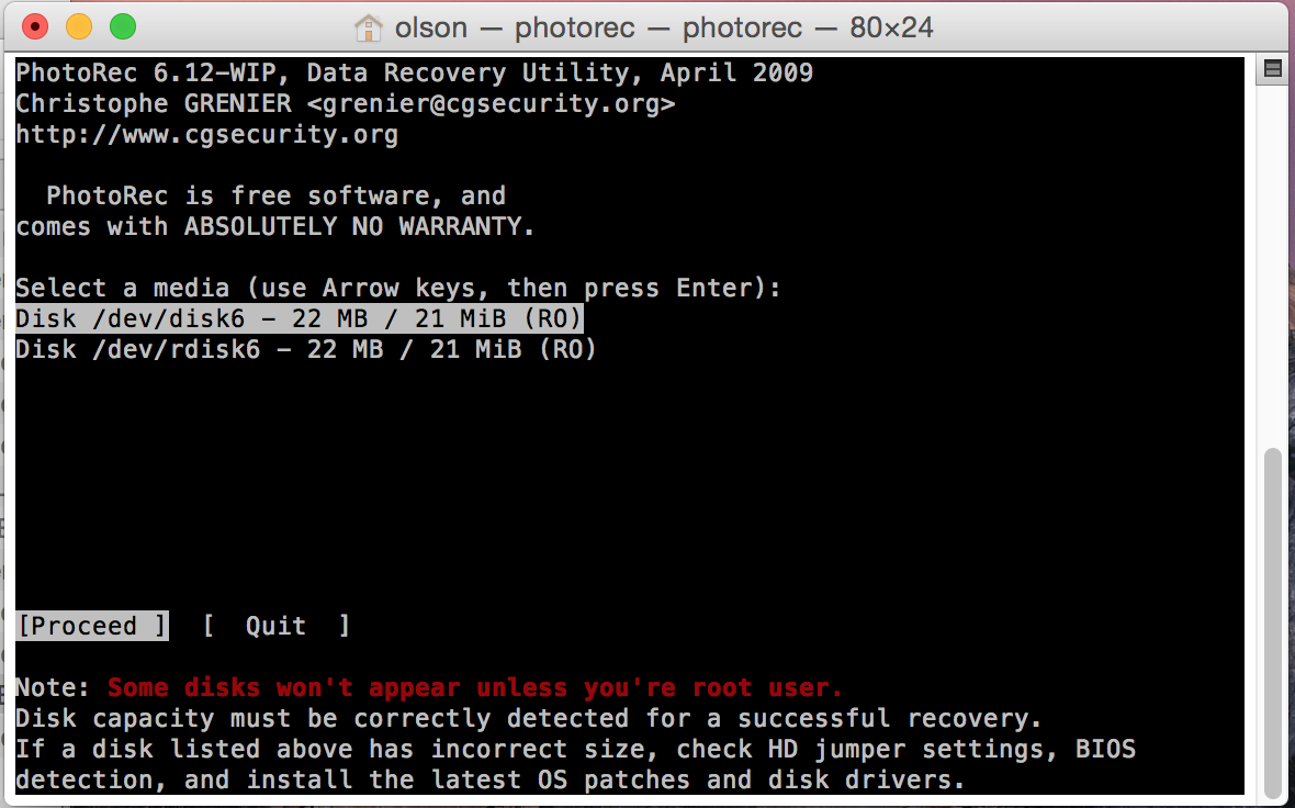

At one point I followed a guide to use photorec, and it didn't get me anywhere. I am pretty sure I have to in order to do file recovery since I read that testdisk is not the tool for it on a mac os extended? Photorec doesn't seem to run with root though and none of the disks show up. Unlike testdisk it does not give me option to run sudo.
photorec wont work.png (155.66 KiB) Viewed 2476 times
can I use testdisk for mac os extended, assuming no.png (72.14 KiB) Viewed 2476 times

Re: Errors/Warnings Galore: # of heads, cylinders, sectors per track, bad start sector, seems too small!
It seems the device disconnects after the deeper search. It may be caused by bad sectors.
You should clone the disk to a new empty one using ddrescue. Once it's done, remove the original disk and try to recover your data from the clone.

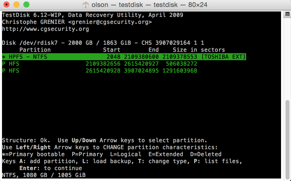

It's strange because the first time, using my macbook, I was able to run a deeper search on full drive... but following typical process now on the imac does not give me that option. I check now, and I AM able to see the full disk and deeper search it while on macbook after the quick search analysis:
on imac
quick search results imac.png (141.08 KiB) Viewed 2460 times
on macbook
quick search on macbook shows 4.png (59.85 KiB) Viewed 2460 times
The highlighted partition is the one I am trying to recover... its the most important one actually. I care so much less about the other two, and the smallest, the 3rd one I made, is worthless.
