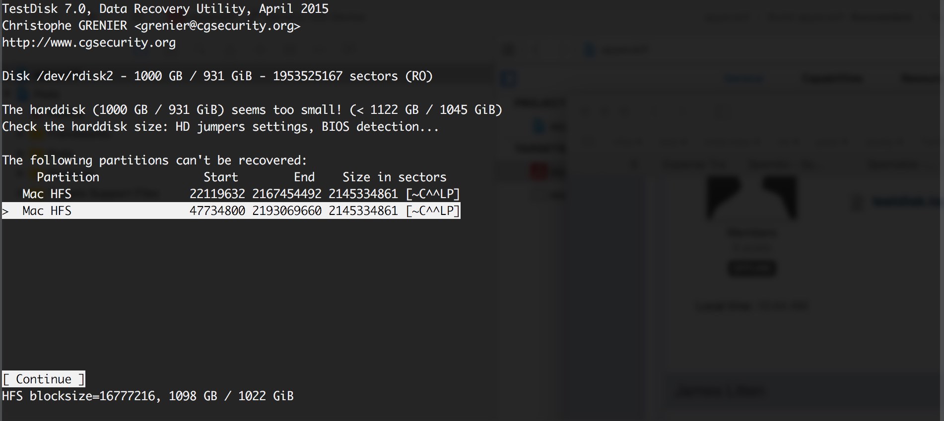

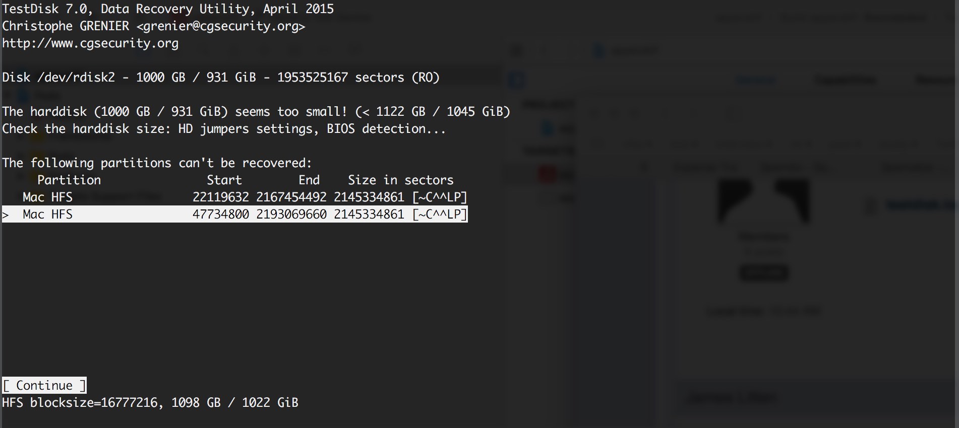

Warning after "Deep Search" completion

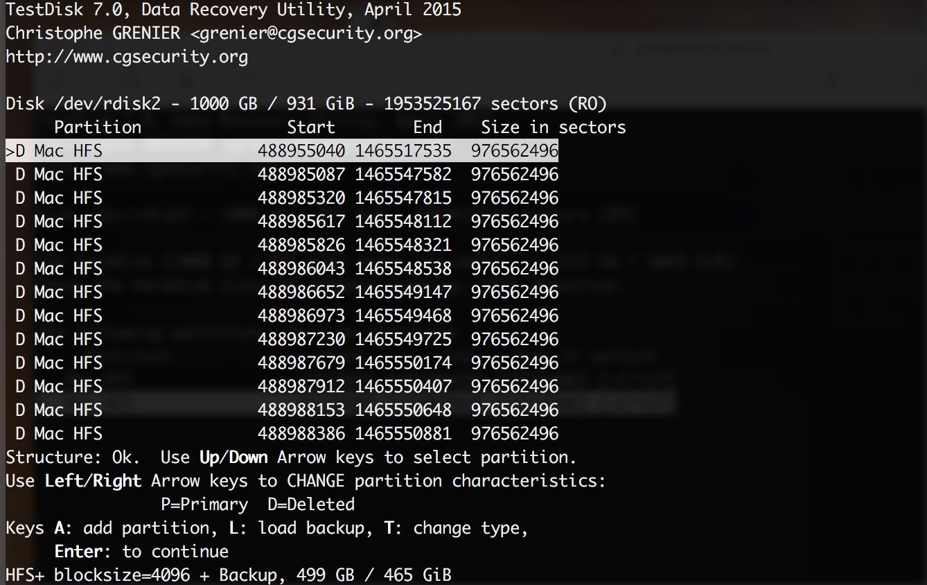

Result of "Deep Search"
Re: Deep Search shows tons of deleted partitions
Posted: 15 Aug 2016, 21:27
To find the correct HFS+ partition, you should try the partition where "+ Backup" is listed on the last line of the screen when highlighted.

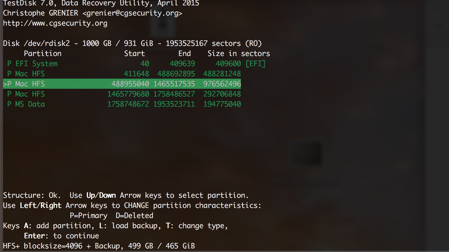

So I'll move with the following partitions:
>P EFI System                    40     409639     409600 [EFI] (Which can list files via "p" button)
>P Mac HFS                   411648  488692895  488281248 (HFS+ blocksize=4096 + Backup, 249 GB / 232 GiB)
>P Mac HFS                488955040 1465517535  976562496 (HFS+ blocksize=4096 + Backup, 499 GB / 465 GiB)
>P Mac HFS               1465779680 1758486527  292706848 (HFS+ blocksize=4096 + Backup, 149 GB / 139 GiB)
>P MS Data               1758748672 1953523711  194775040 (exFAT, blocksize=131072, 99 GB / 92 GiB) (Which can list files via "p" button)
Changing these from Deleted to Primary and then continuing would be enough right?

I've tried to write new partition table but write failed with "write error" message.
By the way, I see that the above partition table which I selected from deleted partitions seems to be exactly the same with current partition structure, which is the folowing:
 1 P EFI System                    40     409639     409600 [EFI System Partition]
 2 P Mac HFS                   411648  488692895  488281248 [Apple_HFSX_Untitled_2]
 3 P Mac HFS                488955040 1465517535  976562496 [TimeMachine]
 4 P Mac HFS               1465779680 1758486527  292706848 [MacMini]
 5 P MS Data               1758748672 1953523711  194775040 [windows]
What should I do to be able to correctly write deleted partition and reach the files?
