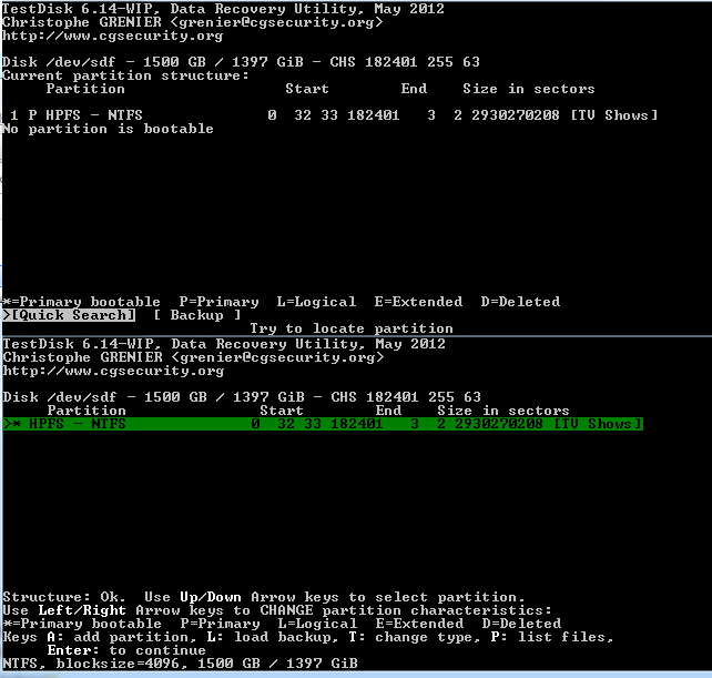

Hi, it's my first time using TestDisk, and I'm kind of desperate because the data on my drive is rather important. Trying to open the drive gives me a CRC error under Windows, and when I analyse using TestDisk, I get the message as attached.
Hope you guys can help me! Really appreciate any assistance you guys can give!

Important is the menu Analyse (your current partition table), your found partition and to list your data.
If testdisk would found your cause (example partition table is wrong), it would be possible to write your partition to your partition table and your problem should be fixed.

Hi, I've attached a screenshot of the Analyse and Quick Search results.
What should I do to fix the partition?
