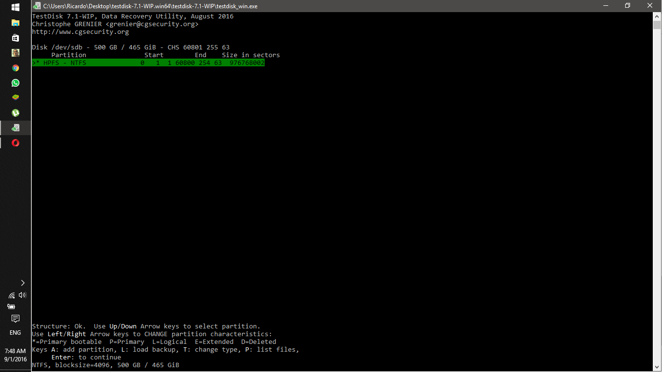

So, the problem is greater than what I thought, I downloaded the latest testdisk and photorec at the time and started using it. I'm familiar with it since I've used testdisk before to recover data from my own laptops hard disk drive. When I use photrec, I can recover the data as I tested it and can see some of the pictures and so, but thing is the file structure and names are missing.
I used testdisk and when adviced on partition it said "None". So I picked that, analysed the disk and I found some partitions but when I wanted to list the files, I couldn't do so. It said something like the structure is corrupted or something. I read one of Fiona's post and it said I should check the Boot part, and it was not identical so I made it identical. And I started my deep search, but now it stuck on 81%. The deep search shows alot of different partitions like exFat, NTSF etc and they have the wrong cylinder, head, sector for each. So I don't know how to change that number for each individual partition.

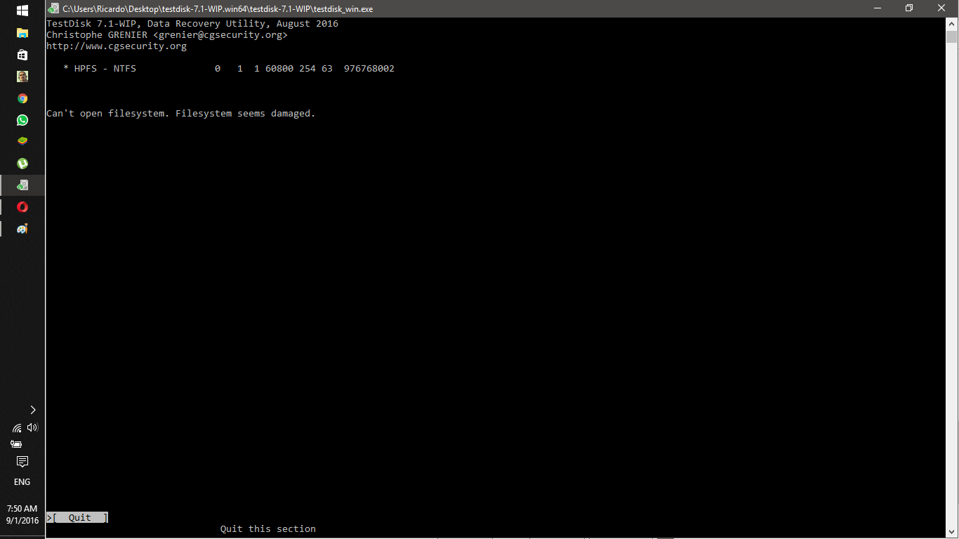

Thank you for you reply, but this didn't work. The Boot was identical. And I can see a partition, but when I tried to access it by pressing "P", I cannot list the files because I get this error: "Can't open file system. Filesystem seems damaged"

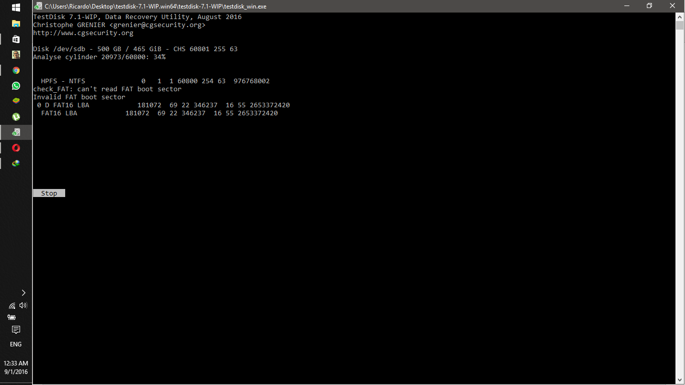

When I analyzed using the version 7.0, I received lots of "geometry" errors, like sector, cylinders etc do not match. Could this be the problem? And if so, could you please help me with the changes needed to make in the "Geometry" in order to be able to access my files?
I recently downloaded 7.1, and analyzed it again and instead, I'm receiving this error:"check_FAT: can't read FAT boot sector Invalid FAT boot sector"
Which is different from the error in 7.0, less explicative on the error, so I don't know, what do you think I should do? Please would you assist me with abit of information on what Geometry changes I would need to make?

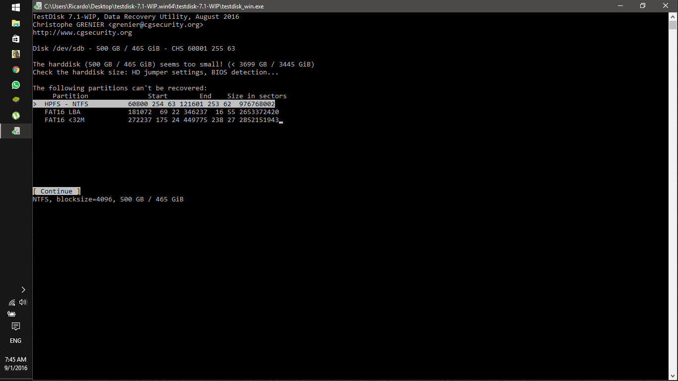

This is the warning message I get after the analysis. How can this be fixed? Geometry?

I don't know if this is the correct partition, so I try to list the files.

Then I get this error.
