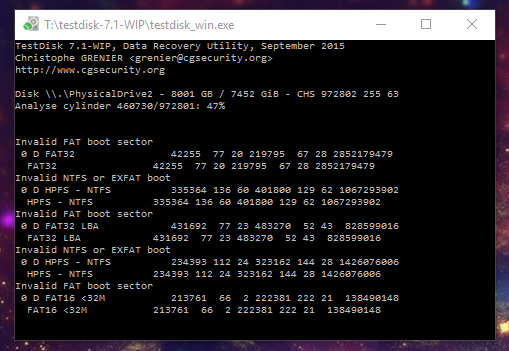

Also I ran deeper scan and its currently at 47% after all night running

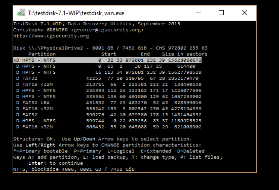

Here is the log after the full deep scan completed, this took about 10 hours to complete:
Thu Oct 20 00:52:26 2016
TestDisk 7.1-WIP, Data Recovery Utility, September 2015
OS: Windows 8 (9200)
Compiler: GCC 4.9, MinGW 3.11
disk_get_size_win32 IOCTL_DISK_GET_LENGTH_INFO(\\.\PhysicalDrive0)=512110190592
disk_get_size_win32 IOCTL_DISK_GET_LENGTH_INFO(\\.\PhysicalDrive1)=4000787030016
disk_get_size_win32 IOCTL_DISK_GET_LENGTH_INFO(\\.\PhysicalDrive2)=8001569161216
disk_get_size_win32 IOCTL_DISK_GET_LENGTH_INFO(\\.\PhysicalDrive3)=2000365289472
disk_get_size_win32 IOCTL_DISK_GET_LENGTH_INFO(\\.\C:)=510612471808
disk_get_size_win32 IOCTL_DISK_GET_LENGTH_INFO(\\.\T:)=4000650887168
Disk \\.\PhysicalDrive0 - 512 GB / 476 GiB - CHS 62260 255 63, sector size=512 - SAMSUNG MZHPU512HCGL-00004, S/N:S1NDNYAF901109, FW:UXM6501Q
Disk \\.\PhysicalDrive1 - 4000 GB / 3726 GiB - CHS 486401 255 63, sector size=512 - WDC WD4003FZEX-00Z4SA0, S/N:WD-WMC130D646U2, FW:01.01A01
Disk \\.\PhysicalDrive2 - 8001 GB / 7452 GiB - CHS 972802 255 63, sector size=512 - Intel Raid 0 Volume, S/N:Valhalla, FW:1.0.
Disk \\.\PhysicalDrive3 - 2000 GB / 1862 GiB - CHS 243197 255 63, sector size=512 - WD Elements 10B8, S/N:WX21E94EAJUK, FW:1012
Disk \\.\PhysicalDrive2 - 8001 GB / 7452 GiB - Intel Raid 0 Volume
Analyse Disk \\.\PhysicalDrive2 - 8001 GB / 7452 GiB - CHS 972802 255 63
NTFS at 0/32/33
filesystem size 15628060672
mftmirr_lcn 2
HPFS - NTFS 0 32 33 972801 232 39 15628060672
NTFS, blocksize=4096, 8001 GB / 7452 GiB
* HPFS - NTFS 0 32 33 972801 232 39 15628060672
Not an exFAT boot sector.
1 * HPFS - NTFS 0 32 33 972801 232 39 15628060672
NTFS at 0/32/33
mftmirr_lcn 2
NTFS at 0/65/2
filesystem size 614400
mft_lcn 25600
mftmirr_lcn 2
HPFS - NTFS 0 65 2 38 127 25 614400
NTFS, blocksize=4096, 314 MB / 300 MiB
NTFS at 16/113/34
filesystem size 15627798528
mftmirr_lcn 2
HPFS - NTFS 16 113 34 972801 232 39 15627798528
NTFS, blocksize=4096, 8001 GB / 7451 GiB
BAD_RS LBA=678831445 4251870
FAT32 42255 77 20 219795 67 28 2852179479
BAD_RS LBA=1092663991 1028185
HPFS - NTFS 335364 136 60 401800 129 62 1067293902
BAD_RS LBA=2640169557 2743124
FAT32 LBA 431692 77 23 483270 52 43 828599016
BAD_RS LBA=3765530624 12852034
HPFS - NTFS 234393 112 24 323162 144 28 1426076006
BAD_RS LBA=3434074624 6854420
FAT16 <32M 213761 66 2 222381 222 21 138490148
BAD_RS LBA=1044952789 10874696
HPFS - NTFS 599744 0 22 673256 83 37 1180975525
BAD_RS LBA=892852003 653309
FAT32 590276 42 10 679380 178 13 1431464332
BAD_RS LBA=1152398972 1060951
FAT16 >32M 606432 55 20 645088 59 29 621008902
LVM magic value at 482920/1/1
BAD_RS LBA=24803157 13269729
FAT16 <32M 536242 159 3 802547 230 43 4278194339
NTFS at 972801/232/39
mftmirr_lcn 2
NTFS found using backup sector, blocksize=4096, 8001 GB / 7452 GiB
mftmirr_lcn 2
NTFS: Can't read MFT
HPFS - NTFS 972801 232 39 1945603 177 45 15628060672
This partition ends after the disk limits. (start=15628062719, size=15628060672, end=31256123390, disk end=15628064768)
file_win32_pread(272,2,buffer,2743162879(972802/10/8)) read err: read after end of file
The harddisk (8001 GB / 7452 GiB) seems too small! (< 16 TB / 14 TiB)
HPFS - NTFS 234393 112 24 323162 171 17 1426077696
HPFS - NTFS Failed to startup volume: Invalid argument.
dir_partition inode=0
177251901 -rwxr-xr-x 0 0 421267302 ‰@£²‹.ÓF§
111280369 -r-xr-xr-x 0 0 177966552 26-Jan-2032 08:23 T$«qb‚R.
264452715 drwxr-xr-x 0 0 941527742 8-Mar-2008 20:34 õ%"0ö‡.‘õ
268370614 -rwxr-xr-x 0 0 1457206406 27-May-1971 00:35 ä Ââìþ´`.~
21498394 dr-xr-xr-x 0 0 4070750330 8-Jan-1998 19:27 ­ÀÂ>J.¬\R
249466385 -rwxr-xr-x 0 0 3307868563 »"Xl„¨*
.tÑå
117728401 drwxr-xr-x 0 0 1414411884 -ApS¦pŠ.°Û
35502681 -rwxr-xr-x 0 0 3350813330 b?Ðg.“Ž(
20846002 -r-xr-xr-x 0 0 2587665886 13-Dec-2030 06:24 ¸¸¢%R]J.Fäm
14615088 -r-xr-xr-x 0 0 668136972 14-Apr-2036 06:02 J;µ¾Õ.‚tö
88759095 dr-xr-xr-x 0 0 2982445212 ¢x~Hàý8„.bØZ
63572174 drwxr-xr-x 0 0 1000136824 É‚<£â.Câ*
256281106 -r-xr-xr-x 0 0 3324894585 20-Jan-2016 07:35 ­…(
t¨/
.Æt®
X240204008 drwxr-xr-x 0 0 1518998331 19-Feb-1992 20:31 _~.tv%m.ü
125619298 dr-xr-xr-x 0 0 1237473622 7-Apr-2025 20:01 l‘OçïÊ.Ç
T
222838310 dr-xr-xr-x 0 0 3247860756 gA3ÿÿÿß}.÷ß}
222708145 drwxr-xr-x 0 0 1367729672 &ŠÄo§˜–¾.ô<
211745703 -rwxr-xr-x 0 0 1457430792 hqtböŒì.Ä|j
60622989 drwxr-xr-x 0 0 2755353476 s#,È¿zÓ.Mô¶
84961220 drwxr-xr-x 0 0 558168902 ç°øYk-.”x”
6811196 drwxr-xr-x 0 0 2443206693 S'œL6Ö.ÎÆO
147923523 drwxr-xr-x 0 0 591816218 5-Feb-2001 06:11 8xÈZÚÚ„ý.§S±
163320582 dr-xr-xr-x 0 0 1858872054 ì%݃>¢.lAŒ
7617056 dr-xr-xr-x 0 0 463813141 u}&:1³Ml.P
86976354 dr-xr-xr-x 0 0 1436633852 10-Aug-1998 18:23 î´†_{I.aÞ
254229537 dr-xr-xr-x 0 0 3598439188 Ú–UÑ
î·8.ÃSˆ
131931043 drwxr-xr-x 0 0 4058273012 12-Feb-2031 02:08 ’Ó)(¡Ã?.«à³
118495329 drwxr-xr-x 0 0 2123646672 Û7;7ëV.à
232424071 -r-xr-xr-x 0 0 1959890846 7-Apr-1982 17:54 ác.Éî'
252149087 -r-xr-xr-x 0 0 1385198762 ƒšKÔÎY¦p.Z1¼
170934852 -r-xr-xr-x 0 0 472130754 Í%\i;®ž.Ù¢Ð
106578112 drwxr-xr-x 0 0 3237744629 ‘ýÀÉbhZU.UTS
140116096 -rwxr-xr-x 0 0 1 ¿üÏ
kRý.óòó
FAT: Can't list files, bad cluster size.

Please note the above is all using Intel as the option, should I of chosen GPT as the option? The raid 0 is two 4tb drives using intel raid array (hardware) on my motherboard, and in windows it was a single partition Z: drive with lots of files.
Here is the screenshot for the above log of what I can see after deep scan:
Re: Raid 0 lost after MB Bios Update -Need help as made mistakes
#8 Post by cgrenier »
The correct partition table type is EFI GPT.
There is a single NTFS partition using the whole Raid,there is no need to search for partitons.
The NTFS filesystem is corrupted. Try TestDisk, Advanced, Boot, RepairMFT.
