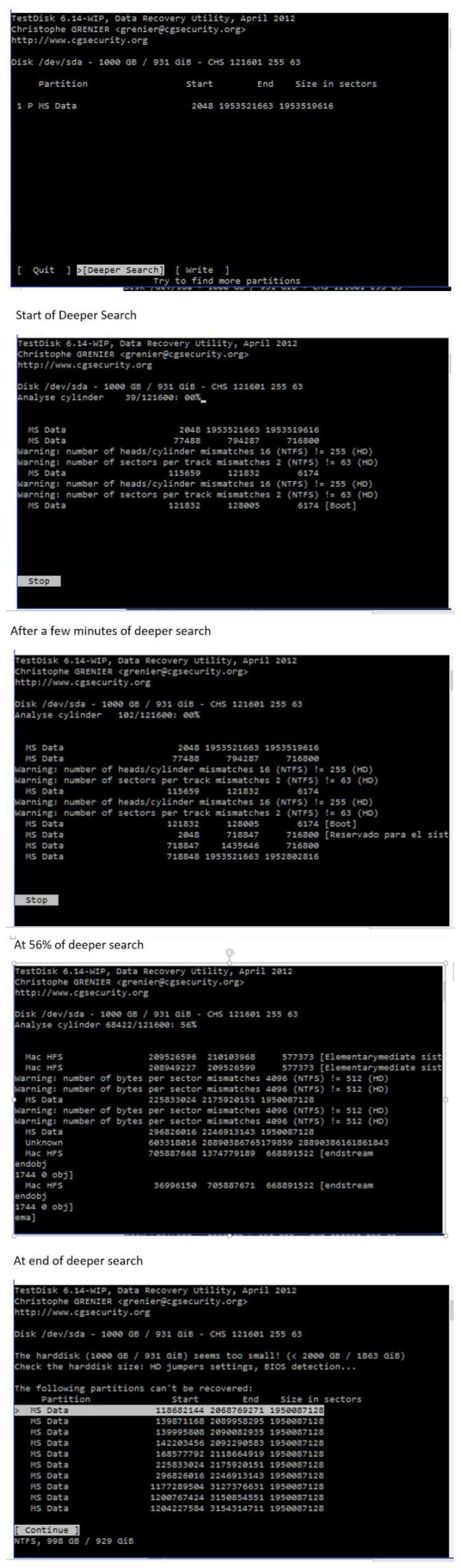

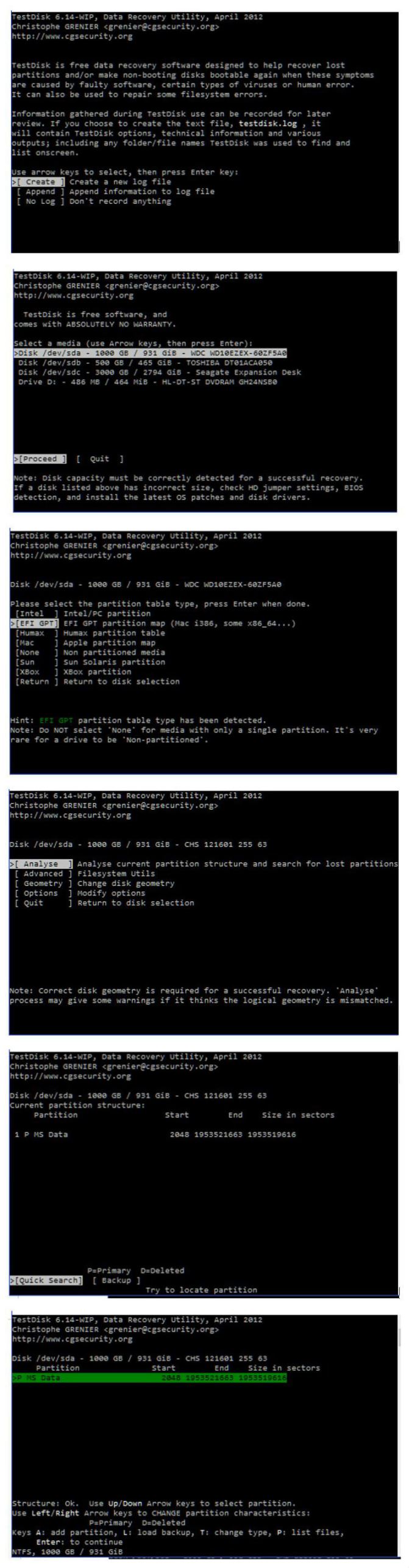

Attached is the testdisk log file (zipped), and two collages of screenshots of the deep search results. I took 11 screenshots at various stages of the search. I'd like to ask if someone can guide me through the rest of the procedure in order to make an attempt to recover the original structure of the folder and files as they were before the HDD (data) turned RAW, then back again to NTFS (after I took it out of the pc and installed it in a usb enclosure). None of my computers can see the files on the drive. Now it's back in the original pc, back to NTFS somehow, and I used PhotoRec to recover to files to a separate external drive, but the folder structure is lost. I've got 1 tb of renamed and shuffled files. A real nightmare. I'd sure like to get back the folders and files as they were before the crash. It's a data drive, so no OS on it. Any help on my next move? Thanks .

- screenshots 7 thru11.jpg (189.87 KiB) Viewed 4378 times
- screenshots 1 thru 6.jpg (196.78 KiB) Viewed 4378 times
