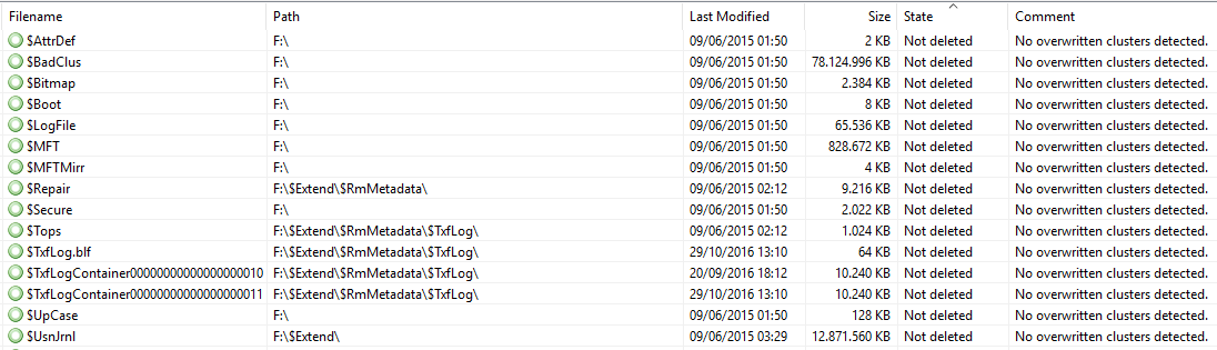

I did another recovery using Recuva to maintain folder structure and while looking at the state of the files, I bumped on this:
$BadClus has actually the size of the partition which 'became' empty. (Date is incorrect but I believe the data is there.)
My question now is: should I backup the entire disk before attempting to recover and/or rebuild NTFS boot sector/MFT of this partition or it's safe to do as it is?
