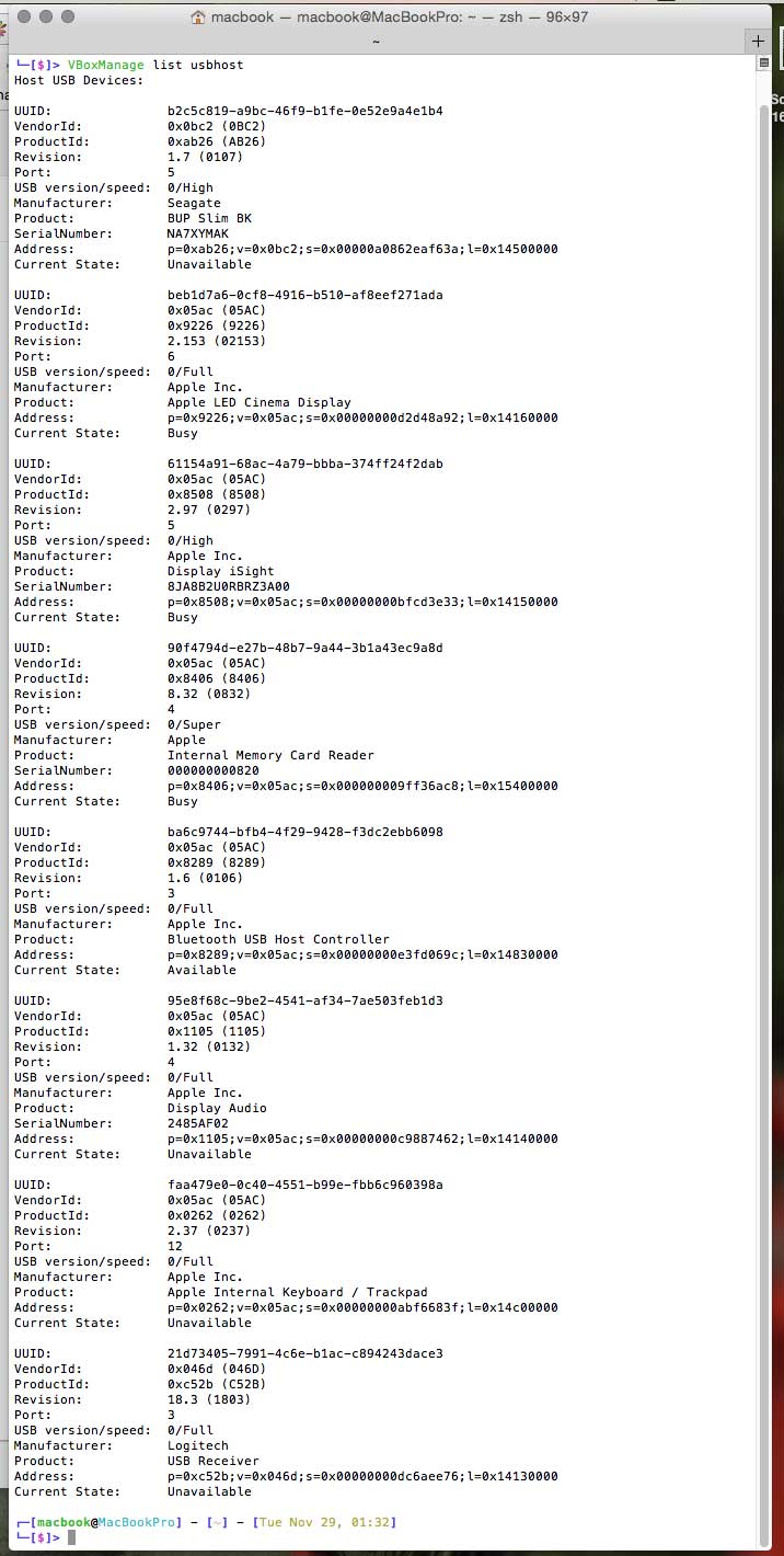

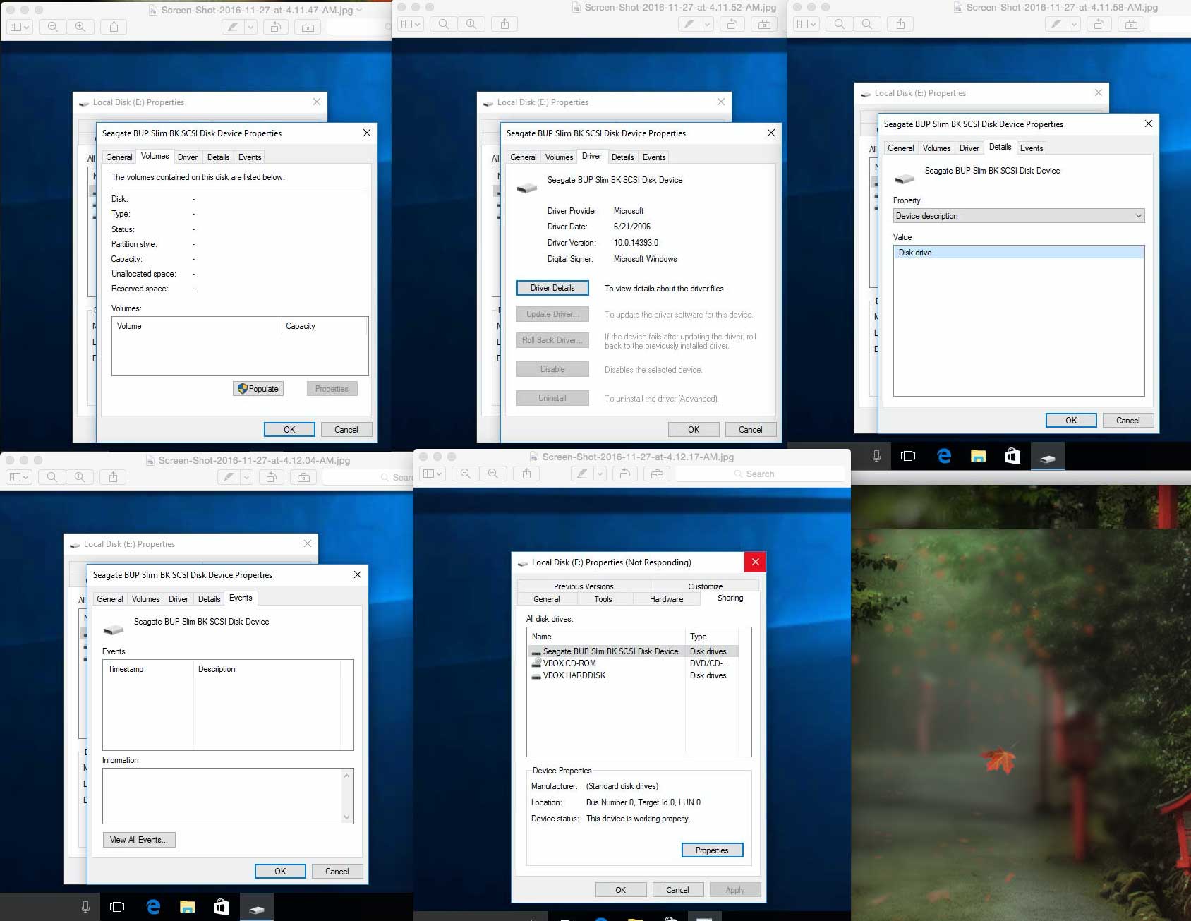

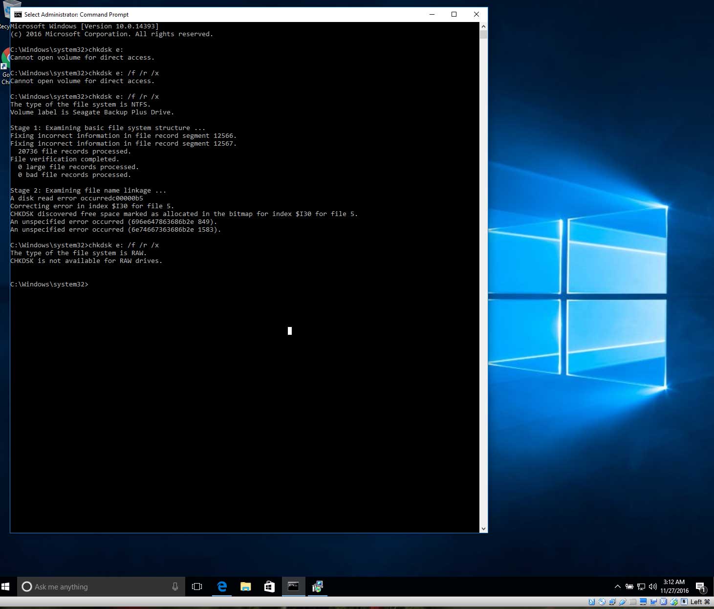

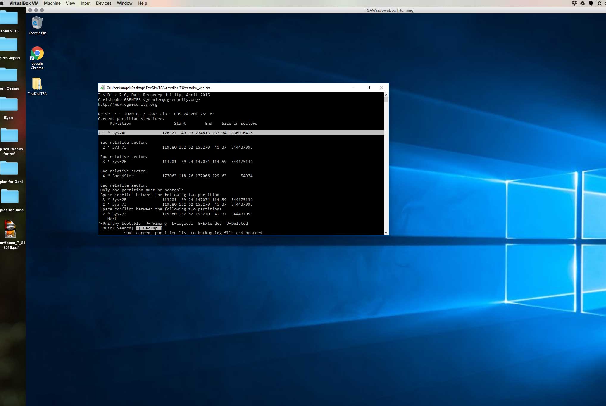

Since I could not see any data on the disk, I thought it best to work in the Windows 10 environment for trying any recovery/rebuild ... so, I fired up VirtualBox, installed Windows 10 and started poking around.
From VirtualBox I was able to see the disk, and after fiddling about with trying to look at properties etc and get it recognized etc. ... but, I had to keep unmounting from Mac system and mounting to Windows. The drive would respond intermittently but eventually went from NTFS to RAW ... probably between the cable disconnecting itself and trying to get the drive defaulting to the VirtualBox there was an incorrect unmount that triggered this ( guessing of course ). Here is where I started snapping some screenshots:
... not able to attach additional screenshots here so posting and then posting followup to continue ...

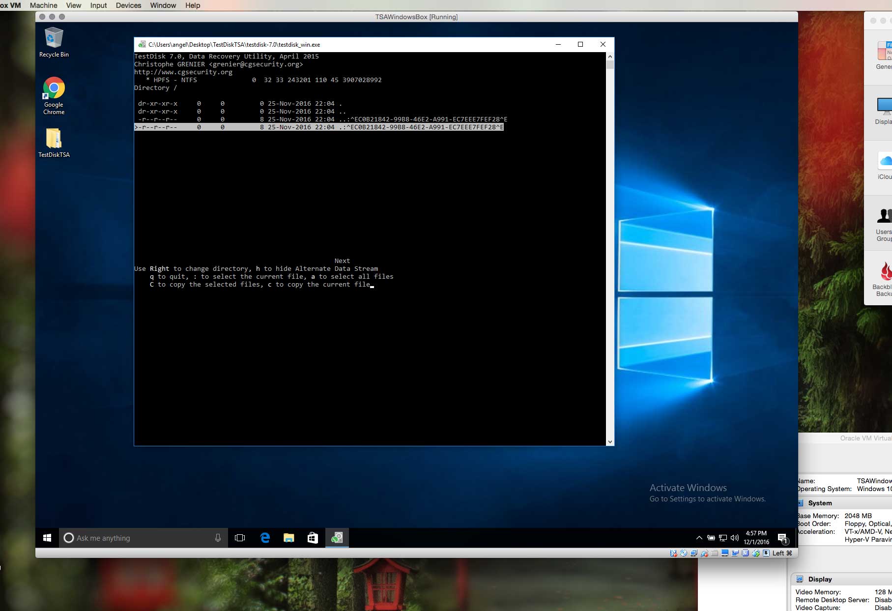

Hi cgrenier and thank you for your response ;-) ... I'm actually stuck in a testdisk function right now and in order to display this fact, and where I am actually at in this process currently, I need to post the additional pics inline with the explanation, but, it would seem that I can only post three images per post ... so, I am going to just post everything up as allowable and apologize for it being so choppy ... I think your advice may hinge on having this info ...
... continuing from previous post ...
... continued in next post ...

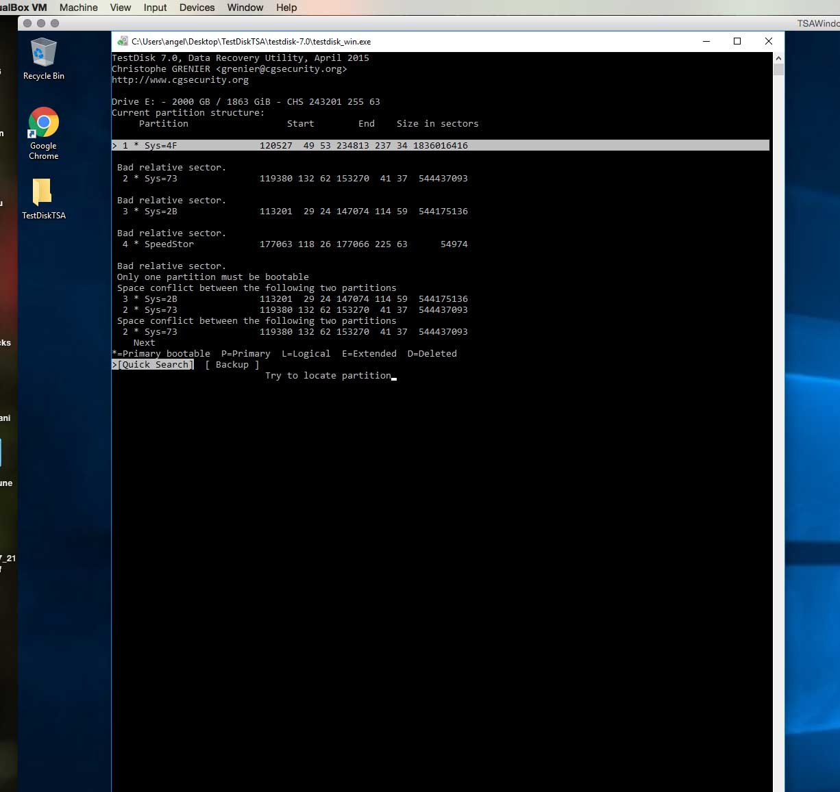

I am not a Windows user, so, working from that system is very foreign to me ... this adds its own set of disadvantages ... but, at this point I went to Google and learned of TestDisk and found an online guide regarding fixing the RAW issue and no data showing up, so I installed TestDisk and was attempting to follow that ... on first run of testdisk this was what I saw ...
The guide said to do a Quicksearch so that is what I did from this point ... it ran for hours but just as it was coming up to 90% done, the cable disconnected … so I repeated the process … and again selected Quicksearch …
... continuing in next post ...

I believe the result of the second run was that it said No Partition found … even after doing a Deeper Search … all of this took about two days of running TestDisk … I don’t have any screenshots and can’t access logs at this point because I am now running on Mac and stuck … hence this post begging for help … ;-)
At some point to avoid the disconnect and mounting issues I also set his drive to default to mounting to the VB instead of my mac as well … using this info …
At some point, I was also able to see this list …
… but, it obviously wasn’t anything to do with the image files so I tried again to find partitions … however at this point it began reporting this …
... continuing in final post ...

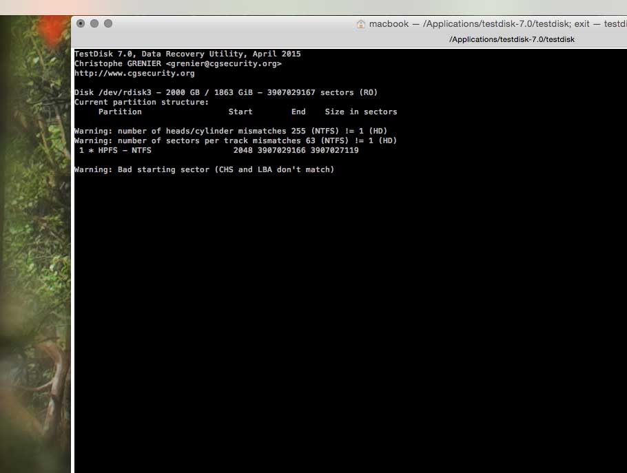

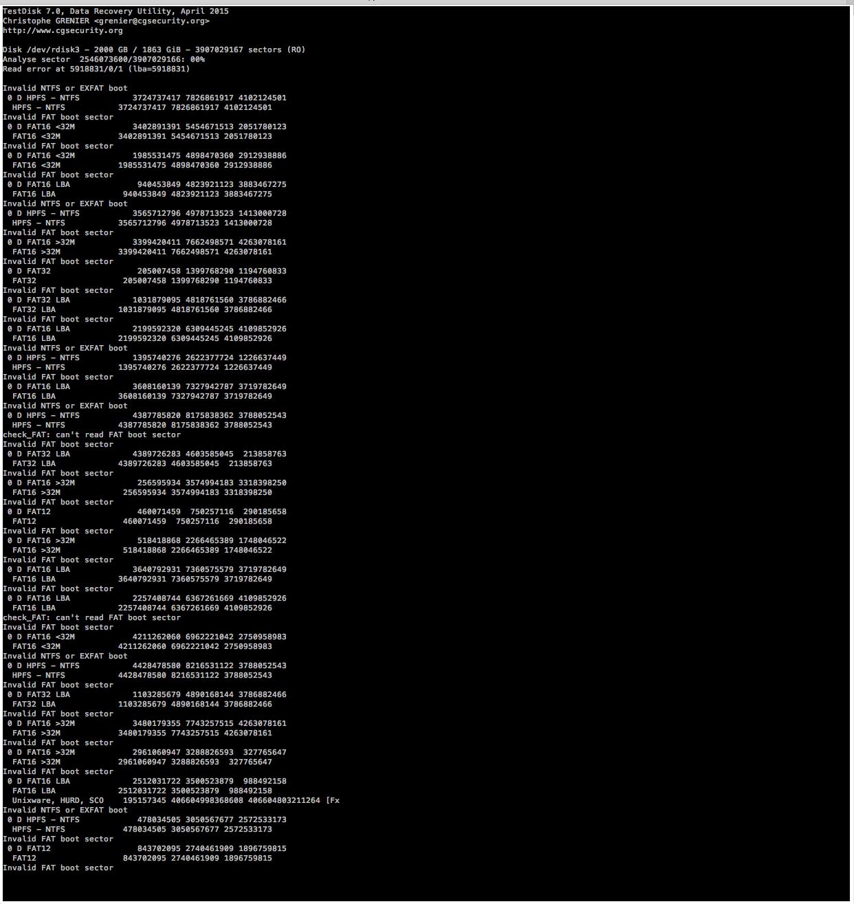

… I thought perhaps I should go back into familiar territory and try further diagnosing from my mac using some sort of LiveCD ( in my case Live USB ) so I unmounted and quit the VirtualBox, created a bootable Ubuntu USB Flash Drive … this gave me the same results as my OS X … basically a disk shows with no files and since I didn’t have test disk on the USB Flash drive etc. I went back to my mac and installed Test Disk there to continue … I haven’t yet made NTFS writable in my system but went forward with running TestDisk in Read Only mode not knowing what I was getting myself into.
I was happy to see that it appeared to at least recognize that there was a partition and I believe I have only selected QuickSearch at this point where I now am … to be honest I’ve kind of lost my mind on this already and really need some guidance as the more forensic aspect of drive inner workings with cylinders, sectors and such is out of my realm.
… and now I find myself on day 5 of this process with this in my terminal … I have no idea if I should just continue letting this run … if this is a waste of time because it says 00% even though the numbers are moving up on the sectors being analyzed … or since it is in read only mode … I’m just lost on this at this point and could really use some expert guidance and how to proceed if anyone is willing to take me on here ;-)
As of right now ... six days later :-\
Thanks so much again in advance …

Current Log File
Fri Dec 2 16:13:00 2016
OS: Darwin, kernel 14.5.0 (Darwin Kernel Version 14.5.0: Sun Sep 25 22:07:15 PDT 2016; root:xnu-2782.5
Compiler: GCC 4.0
Compilation date: 2015-04-18T13:01:34
Disk /dev/disk0 - 500 GB / 465 GiB - 977105060 sectors (RO), sector size=512
Disk /dev/disk2 - 7927 MB / 7560 MiB - 15482880 sectors (RO), sector size=512
Disk /dev/disk3 - 2000 GB / 1863 GiB - 3907029167 sectors (RO), sector size=512
Disk /dev/rdisk0 - 500 GB / 465 GiB - 977105060 sectors (RO), sector size=512
Disk /dev/rdisk1 - 499 GB / 464 GiB - 974716712 sectors, sector size=512
Disk /dev/rdisk2 - 7927 MB / 7560 MiB - 15482880 sectors (RO), sector size=512
Disk /dev/rdisk3 - 2000 GB / 1863 GiB - 3907029167 sectors (RO), sector size=512
Media is opened in read-only.
Disk /dev/rdisk3 - 2000 GB / 1863 GiB (RO)
Analyse Disk /dev/rdisk3 - 2000 GB / 1863 GiB - 3907029167 sectors (RO)
NTFS at 2048/0/1
heads/cylinder 255 (NTFS) != 1 (HD)
sect/track 63 (NTFS) != 1 (HD)
get_geometry_from_list_part_aux head=1 nbr=2
Warning: number of heads/cylinder mismatches 255 (NTFS) != 1 (HD)
Warning: number of sectors per track mismatches 63 (NTFS) != 1 (HD)
1 * HPFS - NTFS 2048 3907029166 3907027119
Warning: Bad starting sector (CHS and LBA don't match)
NTFS at 2048/0/1
filesystem size 3907027119
mftmirr_lcn 2
NTFS part_offset=1048576, part_size=2000397884928, sector_size=512
NTFS at 2048/0/1
mftmirr_lcn 2
* HPFS - NTFS 2048 3907031039 3907028992
1 * HPFS - NTFS 2048 3907031039 3907028992
ntfs_attr_pread_i: ntfs_pread failed: Input/output error
Failed to read index block: Input/output error
NTFS at 2048/0/1
NTFS Volume is dirty.
dir_partition inode=5
file_pread(10,16,buffer,563696(563696/0/1)) read err: Input/output error
file_pread(10,1,buffer,563696(563696/0/1)) read err: Input/output error
ntfs_readdir failed for cluster 5: Input/output error

file_pread(10,1,buffer,563701(563701/0/1)) read err: Input/output error
file_pread(10,16,buffer,563702(563702/0/1)) read err: Input/output error
file_pread(10,1,buffer,563702(563702/0/1)) read err: Input/output error
file_pread(10,16,buffer,563703(563703/0/1)) read err: Input/output error
file_pread(10,1,buffer,563703(563703/0/1)) read err: Input/output error
file_pread(10,16,buffer,563685(563685/0/1)) read err: Input/output error
file_pread(10,16,buffer,563686(563686/0/1)) read err: Input/output error
file_pread(10,16,buffer,563687(563687/0/1)) read err: Input/output error
file_pread(10,16,buffer,563688(563688/0/1)) read err: Input/output error
file_pread(10,16,buffer,563689(563689/0/1)) read err: Input/output error
file_pread(10,16,buffer,563690(563690/0/1)) read err: Input/output error
file_pread(10,16,buffer,563681(563681/0/1)) read err: Input/output error
file_pread(10,16,buffer,563693(563693/0/1)) read err: Input/output error
file_pread(10,16,buffer,563684(563684/0/1)) read err: Input/output error
file_pread(10,7,buffer,563691(563691/0/1)) read err: Input/output error
file_pread(10,1,buffer,563698(563698/0/1)) read err: Input/output error
file_pread(10,16,buffer,563699(563699/0/1)) read err: Input/output error
file_pread(10,1,buffer,563699(563699/0/1)) read err: Input/output error
file_pread(10,16,buffer,563700(563700/0/1)) read err: Input/output error
file_pread(10,1,buffer,563700(563700/0/1)) read err: Input/output error
file_pread(10,16,buffer,563701(563701/0/1)) read err: Input/output error
file_pread(10,16,buffer,563697(563697/0/1)) read err: Input/output error
file_pread(10,1,buffer,563697(563697/0/1)) read err: Input/output error
file_pread(10,16,buffer,563698(563698/0/1)) read err: Input/output error
file_pread(10,16,buffer,563682(563682/0/1)) read err: Input/output error
file_pread(10,16,buffer,563692(563692/0/1)) read err: Input/output error
file_pread(10,16,buffer,563691(563691/0/1)) read err: Input/output error
file_pread(10,6,buffer,563694(563694/0/1)) read err: Input/output error
file_pread(10,16,buffer,563694(563694/0/1)) read err: Input/output error
file_pread(10,16,buffer,563695(563695/0/1)) read err: Input/output error
file_pread(10,16,buffer,563683(563683/0/1)) read err: Input/output error
file_pread(10,2,buffer,563697(563697/0/1)) read err: Input/output error
file_pread(10,3,buffer,563699(563699/0/1)) read err: Input/output error
file_pread(10,3,buffer,563697(563697/0/1)) read err: Input/output error
file_pread(10,3,buffer,563700(563700/0/1)) read err: Input/output error
file_pread(10,4,buffer,563697(563697/0/1)) read err: Input/output error
file_pread(10,3,buffer,563701(563701/0/1)) read err: Input/output error
file_pread(10,5,buffer,563697(563697/0/1)) read err: Input/output error
file_pread(10,3,buffer,563702(563702/0/1)) read err: Input/output error
file_pread(10,6,buffer,563697(563697/0/1)) read err: Input/output error
file_pread(10,3,buffer,563703(563703/0/1)) read err: Input/output error
BAD_RS LBA=4017989412 664
FAT32 4017989412 5355373461 1337384050
This partition ends after the disk limits. (start=4017989412, size=1337384050, end=5355373461, disk end=3907029167)
file_pread(10,16,buffer,5920871(5920871/0/1)) read err: Input/output error
file_pread(10,16,buffer,5920872(5920872/0/1)) read err: Input/output error
file_pread(10,1,buffer,5920872(5920872/0/1)) read err: Input/output error
file_pread(10,16,buffer,5920873(5920873/0/1)) read err: Input/output error
file_pread(10,1,buffer,5920873(5920873/0/1)) read err: Input/output error
file_pread(10,16,buffer,5920874(5920874/0/1)) read err: Input/output error
file_pread(10,1,buffer,5920874(5920874/0/1)) read err: Input/output error
file_pread(10,16,buffer,5920875(5920875/0/1)) read err: Input/output error
file_pread(10,1,buffer,5920875(5920875/0/1)) read err: Input/output error
file_pread(10,16,buffer,5920876(5920876/0/1)) read err: Input/output error
file_pread(10,1,buffer,5920876(5920876/0/1)) read err: Input/output error
file_pread(10,1,buffer,5920877(5920877/0/1)) read err: Input/output error
file_pread(10,1,buffer,5920878(5920878/0/1)) read err: Input/output error
file_pread(10,1,buffer,5920879(5920879/0/1)) read err: Input/output error
file_pread(10,16,buffer,5920857(5920857/0/1)) read err: Input/output error
file_pread(10,16,buffer,5920858(5920858/0/1)) read err: Input/output error
file_pread(10,16,buffer,5920859(5920859/0/1)) read err: Input/output error
file_pread(10,16,buffer,5920860(5920860/0/1)) read err: Input/output error
file_pread(10,16,buffer,5920861(5920861/0/1)) read err: Input/output error
file_pread(10,16,buffer,5920862(5920862/0/1)) read err: Input/output error
file_pread(10,16,buffer,5920869(5920869/0/1)) read err: Input/output error
file_pread(10,16,buffer,5920870(5920870/0/1)) read err: Input/output error
file_pread(10,16,buffer,5920864(5920864/0/1)) read err: Input/output error
file_pread(10,4,buffer,5920874(5920874/0/1)) read err: Input/output error
file_pread(10,16,buffer,5920868(5920868/0/1)) read err: Input/output error
file_pread(10,16,buffer,5920866(5920866/0/1)) read err: Input/output error
file_pread(10,5,buffer,5920872(5920872/0/1)) read err: Input/output error
file_pread(10,16,buffer,5920877(5920877/0/1)) read err: Input/output error
file_pread(10,16,buffer,5920879(5920879/0/1)) read err: Input/output error
file_pread(10,16,buffer,5920863(5920863/0/1)) read err: Input/output error
file_pread(10,16,buffer,5920878(5920878/0/1)) read err: Input/output error
file_pread(10,16,buffer,5920865(5920865/0/1)) read err: Input/output error
file_pread(10,16,buffer,5920867(5920867/0/1)) read err: Input/output error
file_pread(10,3,buffer,5920874(5920874/0/1)) read err: Input/output error
file_pread(10,2,buffer,5920873(5920873/0/1)) read err: Input/output error
file_pread(10,3,buffer,5920875(5920875/0/1)) read err: Input/output error
file_pread(10,3,buffer,5920873(5920873/0/1)) read err: Input/output error
file_pread(10,3,buffer,5920876(5920876/0/1)) read err: Input/output error
10SexyApples
Posts: 8
Joined: 07 Dec 2016, 19:15
Re: Out of My Comfort Zone Partition Recovery Issue
#9 Post by 10SexyApples »
... continued ...
file_pread(10,4,buffer,5920873(5920873/0/1)) read err: Input/output error
file_pread(10,3,buffer,5920877(5920877/0/1)) read err: Input/output error
file_pread(10,5,buffer,5920873(5920873/0/1)) read err: Input/output error
file_pread(10,3,buffer,5920878(5920878/0/1)) read err: Input/output error
file_pread(10,6,buffer,5920873(5920873/0/1)) read err: Input/output error
file_pread(10,3,buffer,5920879(5920879/0/1)) read err: Input/output error
BAD_RS LBA=2952818444 315
FAT16 LBA 2952818444 6250274398 3297455955
This partition ends after the disk limits. (start=2952818444, size=3297455955, end=6250274398, disk end=3907029167)
BAD_RS LBA=78320276 809
FAT12 78320276 4313063489 4234743214
This partition ends after the disk limits. (start=78320276, size=4234743214, end=4313063489, disk end=3907029167)
BAD_RS LBA=3641334403 931
FAT16 LBA 3641334403 5643548315 2002213913
This partition ends after the disk limits. (start=3641334403, size=2002213913, end=5643548315, disk end=3907029167)
BAD_RS LBA=1889719100 893
HPFS - NTFS 1889719100 6061562442 4171843343
This partition ends after the disk limits. (start=1889719100, size=4171843343, end=6061562442, disk end=3907029167)
BAD_RS LBA=2112476397 362
FAT12 2112476397 4064830968 1952354572
This partition ends after the disk limits. (start=2112476397, size=1952354572, end=4064830968, disk end=3907029167)
BAD_RS LBA=219802542 462
FAT32 219802542 3353037889 3133235348
BAD_RS LBA=812665196 1256
FAT32 LBA 812665196 3005565699 2192900504
BAD_RS LBA=2148484782 947
FAT32 LBA 2148484782 3375283938 1226799157
BAD_RS LBA=3573386808 400
HPFS - NTFS 3573386808 5689299346 2115912539
This partition ends after the disk limits. (start=3573386808, size=2115912539, end=5689299346, disk end=3907029167)
BAD_RS LBA=3573449208 400
HPFS - NTFS 3573449208 5689361746 2115912539
This partition ends after the disk limits. (start=3573449208, size=2115912539, end=5689361746, disk end=3907029167)
BAD_RS LBA=2388271771 438
FAT16 <32M 2388271771 3125945368 737673598
BAD_RS LBA=4200967613 988
FAT16 <32M 4200967613 5752059007 1551091395
This partition ends after the disk limits. (start=4200967613, size=1551091395, end=5752059007, disk end=3907029167)
BAD_RS LBA=1134318532 1191
HPFS - NTFS 1134318532 4862089901 3727771370
This partition ends after the disk limits. (start=1134318532, size=3727771370, end=4862089901, disk end=3907029167)
BAD_RS LBA=3572889643 471
FAT16 <32M 3572889643 6748644462 3175754820
This partition ends after the disk limits. (start=3572889643, size=3175754820, end=6748644462, disk end=3907029167)
BAD_RS LBA=1509984666 450
FAT32 1509984666 5769399629 4259414964
This partition ends after the disk limits. (start=1509984666, size=4259414964, end=5769399629, disk end=3907029167)
BAD_RS LBA=3340437571 1118
FAT16 >32M 3340437571 7603515731 4263078161
This partition ends after the disk limits. (start=3340437571, size=4263078161, end=7603515731, disk end=3907029167)
BAD_RS LBA=3751150947 384
FAT12 3751150947 4626472515 875321569
This partition ends after the disk limits. (start=3751150947, size=875321569, end=4626472515, disk end=3907029167)
BAD_RS LBA=4074164330 731
FAT32 LBA 4074164330 7016588023 2942423694
This partition ends after the disk limits. (start=4074164330, size=2942423694, end=7016588023, disk end=3907029167)
BAD_RS LBA=3072192899 432
FAT16 <32M 3072192899 3088938449 16745551
BAD_RS LBA=2814972299 207
FAT16 >32M 2814972299 3142737945 327765647
BAD_RS LBA=4097467460 1027
FAT16 <32M 4097467460 6848426442 2750958983
This partition ends after the disk limits. (start=4097467460, size=2750958983, end=6848426442, disk end=3907029167)
BAD_RS LBA=4222933453 988
FAT16 <32M 4222933453 5774024847 1551091395
This partition ends after the disk limits. (start=4222933453, size=1551091395, end=5774024847, disk end=3907029167)
BAD_RS LBA=3706046362 459
FAT12 3706046362 7098203943 3392157582
This partition ends after the disk limits. (start=3706046362, size=3392157582, end=7098203943, disk end=3907029167)
BAD_RS LBA=2864025012 510
HPFS - NTFS 2864025012 3320498008 456472997
BAD_RS LBA=3212912847 182
HPFS - NTFS 3212912847 7431232210 4218319364
This partition ends after the disk limits. (start=3212912847, size=4218319364, end=7431232210, disk end=3907029167)
BAD_RS LBA=3869752442 240
FAT16 <32M 3869752442 8095771240 4226018799
This partition ends after the disk limits. (start=3869752442, size=4226018799, end=8095771240, disk end=3907029167)
BAD_RS LBA=130178633 394
FAT16 LBA 130178633 3307203498 3177024866
BAD_RS LBA=3548434916 409
FAT16 <32M 3548434916 3958013746 409578831
This partition ends after the disk limits. (start=3548434916, size=409578831, end=3958013746, disk end=3907029167)
BAD_RS LBA=1943964668 203
HPFS - NTFS 1943964668 2240665519 296700852
BAD_RS LBA=2744173549 1072
FAT32 2744173549 3478987311 734813763
BAD_RS LBA=1551828845 872
FAT16 >32M 1551828845 1602787216 50958372
BAD_RS LBA=3386239707 405
FAT16 LBA 3386239707 7613437809 4227198103
This partition ends after the disk limits. (start=3386239707, size=4227198103, end=7613437809, disk end=3907029167)
BAD_RS LBA=3424778497 301
FAT16 >32M 3424778497 5749611521 2324833025
This partition ends after the disk limits. (start=3424778497, size=2324833025, end=5749611521, disk end=3907029167)
BAD_RS LBA=3484959599 199
FAT32 LBA 3484959599 5889353563 2404393965
This partition ends after the disk limits. (start=3484959599, size=2404393965, end=5889353563, disk end=3907029167)
BAD_RS LBA=3724737417 875
HPFS - NTFS 3724737417 7826861917 4102124501
This partition ends after the disk limits. (start=3724737417, size=4102124501, end=7826861917, disk end=3907029167)
BAD_RS LBA=3402891391 837
FAT16 <32M 3402891391 5454671513 2051780123
This partition ends after the disk limits. (start=3402891391, size=2051780123, end=5454671513, disk end=3907029167)
BAD_RS LBA=1985531475 1067
FAT16 <32M 1985531475 4898470360 2912938886
This partition ends after the disk limits. (start=1985531475, size=2912938886, end=4898470360, disk end=3907029167)
BAD_RS LBA=940453849 810
FAT16 LBA 940453849 4823921123 3883467275
This partition ends after the disk limits. (start=940453849, size=3883467275, end=4823921123, disk end=3907029167)
BAD_RS LBA=3565712796 533
HPFS - NTFS 3565712796 4978713523 1413000728
This partition ends after the disk limits. (start=3565712796, size=1413000728, end=4978713523, disk end=3907029167)
BAD_RS LBA=3399420411 1118
FAT16 >32M 3399420411 7662498571 4263078161
This partition ends after the disk limits. (start=3399420411, size=4263078161, end=7662498571, disk end=3907029167)
BAD_RS LBA=205007458 974
FAT32 205007458 1399768290 1194760833
BAD_RS LBA=1031879095 1087
FAT32 LBA 1031879095 4818761560 3786882466
This partition ends after the disk limits. (start=1031879095, size=3786882466, end=4818761560, disk end=3907029167)
BAD_RS LBA=2199592320 334
FAT16 LBA 2199592320 6309445245 4109852926
This partition ends after the disk limits. (start=2199592320, size=4109852926, end=6309445245, disk end=3907029167)
BAD_RS LBA=1395740276 406
HPFS - NTFS 1395740276 2622377724 1226637449
BAD_RS LBA=3608160139 858
FAT16 LBA 3608160139 7327942787 3719782649
This partition ends after the disk limits. (start=3608160139, size=3719782649, end=7327942787, disk end=3907029167)
BAD_RS LBA=92818524 1008
HPFS - NTFS 4387785820 8175838362 3788052543
This partition ends after the disk limits. (start=4387785820, size=3788052543, end=8175838362, disk end=3907029167)
BAD_RS LBA=94758987 514
FAT32 LBA 4389726283 4603585045 213858763
This partition ends after the disk limits. (start=4389726283, size=213858763, end=4603585045, disk end=3907029167)
BAD_RS LBA=256595934 550
FAT16 >32M 256595934 3574994183 3318398250
BAD_RS LBA=460071459 339
FAT12 460071459 750257116 290185658
BAD_RS LBA=518418868 872
FAT16 >32M 518418868 2266465389 1748046522
BAD_RS LBA=3640792931 858
FAT16 LBA 3640792931 7360575579 3719782649
This partition ends after the disk limits. (start=3640792931, size=3719782649, end=7360575579, disk end=3907029167)
BAD_RS LBA=2257408744 334
FAT16 LBA 2257408744 6367261669 4109852926
This partition ends after the disk limits. (start=2257408744, size=4109852926, end=6367261669, disk end=3907029167)
BAD_RS LBA=4211262060 1027
FAT16 <32M 4211262060 6962221042 2750958983
This partition ends after the disk limits. (start=4211262060, size=2750958983, end=6962221042, disk end=3907029167)
BAD_RS LBA=133511284 1008
HPFS - NTFS 4428478580 8216531122 3788052543
This partition ends after the disk limits. (start=4428478580, size=3788052543, end=8216531122, disk end=3907029167)
BAD_RS LBA=1103285679 1087
FAT32 LBA 1103285679 4890168144 3786882466
This partition ends after the disk limits. (start=1103285679, size=3786882466, end=4890168144, disk end=3907029167)
BAD_RS LBA=3480179355 1118
FAT16 >32M 3480179355 7743257515 4263078161
This partition ends after the disk limits. (start=3480179355, size=4263078161, end=7743257515, disk end=3907029167)
BAD_RS LBA=2961060947 207
FAT16 >32M 2961060947 3288826593 327765647
BAD_RS LBA=2512031722 206
FAT16 LBA 2512031722 3500523879 988492158
SYSV4 Marker at 195157345/0/1
recover_sysv4
Unixware, HURD, SCO 195157345 406604998368608 406604803211264 [Fx?]
SysV4, 208181 TB / 189340 TiB
This partition ends after the disk limits. (start=195157345, size=406604803211264, end=406604998368608, disk end=3907029167)
BAD_RS LBA=478034505 514
HPFS - NTFS 478034505 3050567677 2572533173
BAD_RS LBA=843702095 776
FAT12 843702095 2740461909 1896759815
BAD_RS LBA=3871423991 974
Buffer can't store more than 200 lines.
FAT32 3871423991 7161060312 3289636322
This partition ends after the disk limits. (start=3871423991, size=3289636322, end=7161060312, disk end=3907029167)
BAD_RS LBA=1074311977 810
FAT16 LBA 1074311977 4957779251 3883467275
This partition ends after the disk limits. (start=1074311977, size=3883467275, end=4957779251, disk end=3907029167)
BAD_RS LBA=3020909162 430
HPFS - NTFS 3020909162 7010271290 3989362129
This partition ends after the disk limits. (start=3020909162, size=3989362129, end=7010271290, disk end=3907029167)
BAD_RS LBA=2584294674 616
FAT16 LBA 2584294674 4388351712 1804057039
This partition ends after the disk limits. (start=2584294674, size=1804057039, end=4388351712, disk end=3907029167)
BAD_RS LBA=3821624112 400
HPFS - NTFS 3821624112 5937536650 2115912539
This partition ends after the disk limits. (start=3821624112, size=2115912539, end=5937536650, disk end=3907029167)
BAD_RS LBA=3182466587 903
FAT12 3182466587 4125502635 943036049
This partition ends after the disk limits. (start=3182466587, size=943036049, end=4125502635, disk end=3907029167)
BAD_RS LBA=3883912492 386
FAT16 LBA 3883912492 5507661321 1623748830
This partition ends after the disk limits. (start=3883912492, size=1623748830, end=5507661321, disk end=3907029167)
BAD_RS LBA=2624415554 206
FAT16 LBA 2624415554 3612907711 988492158
BAD_RS LBA=204494357 1156
FAT16 LBA 4499461653 8684037285 4184575633
This partition ends after the disk limits. (start=4499461653, size=4184575633, end=8684037285, disk end=3907029167)
BAD_RS LBA=3687085333 340
FAT12 3687085333 7488539292 3801453960
This partition ends after the disk limits. (start=3687085333, size=3801453960, end=7488539292, disk end=3907029167)
BAD_RS LBA=3307235539 569
FAT32 LBA 3307235539 4867210954 1559975416
This partition ends after the disk limits. (start=3307235539, size=1559975416, end=4867210954, disk end=3907029167)
BAD_RS LBA=2273452605 853
FAT16 <32M 2273452605 2290205479 16752875
BAD_RS LBA=3003676661 553
HPFS - NTFS 3003676661 7260054394 4256377734
This partition ends after the disk limits. (start=3003676661, size=4256377734, end=7260054394, disk end=3907029167)
BAD_RS LBA=3799604742 841
FAT32 LBA 3799604742 5792819173 1993214432
This partition ends after the disk limits. (start=3799604742, size=1993214432, end=5792819173, disk end=3907029167)
BAD_RS LBA=3755890967 199
FAT32 LBA 3755890967 6160284931 2404393965
This partition ends after the disk limits. (start=3755890967, size=2404393965, end=6160284931, disk end=3907029167)
BAD_RS LBA=200041134 827
HPFS - NTFS 4495008430 5275955854 780947425
This partition ends after the disk limits. (start=4495008430, size=780947425, end=5275955854, disk end=3907029167)
BAD_RS LBA=150551467 865
FAT16 <32M 4445518763 7635545297 3190026535
This partition ends after the disk limits. (start=4445518763, size=3190026535, end=7635545297, disk end=3907029167)
BAD_RS LBA=3708559321 301
FAT16 >32M 3708559321 6033392345 2324833025
This partition ends after the disk limits. (start=3708559321, size=2324833025, end=6033392345, disk end=3907029167)
BAD_RS LBA=3678733315 405
FAT16 LBA 3678733315 7905931417 4227198103
This partition ends after the disk limits. (start=3678733315, size=4227198103, end=7905931417, disk end=3907029167)
BAD_RS LBA=3196405704 713
FAT32 LBA 3196405704 6764361141 3567955438
This partition ends after the disk limits. (start=3196405704, size=3567955438, end=6764361141, disk end=3907029167)
BAD_RS LBA=1176307736 734
FAT16 >32M 1176307736 3785556386 2609248651
BAD_RS LBA=1100555231 240
FAT16 <32M 1100555231 2736471225 1635915995
BAD_RS LBA=429416159 91
HPFS - NTFS 4724383455 4944520613 220137159
This partition ends after the disk limits. (start=4724383455, size=220137159, end=4944520613, disk end=3907029167)
BAD_RS LBA=4122159718 1189
HPFS - NTFS 4122159718 7340968742 3218809025
This partition ends after the disk limits. (start=4122159718, size=3218809025, end=7340968742, disk end=3907029167)
BAD_RS LBA=2041428549 872
FAT16 >32M 2041428549 2092386920 50958372
BAD_RS LBA=3764095755 375
FAT16 >32M 3764095755 7265306809 3501211055
This partition ends after the disk limits. (start=3764095755, size=3501211055, end=7265306809, disk end=3907029167)
BAD_RS LBA=3692936121 782
FAT16 <32M 3692936121 5858320421 2165384301
This partition ends after the disk limits. (start=3692936121, size=2165384301, end=5858320421, disk end=3907029167)
BAD_RS LBA=4176311514 997
FAT32 LBA 4176311514 7161288734 2984977221
This partition ends after the disk limits. (start=4176311514, size=2984977221, end=7161288734, disk end=3907029167)
BAD_RS LBA=3731126103 585
FAT32 3731126103 7705318037 3974191935
This partition ends after the disk limits. (start=3731126103, size=3974191935, end=7705318037, disk end=3907029167)
BAD_RS LBA=3617693685 1072
FAT32 3617693685 4352507447 734813763
This partition ends after the disk limits. (start=3617693685, size=734813763, end=4352507447, disk end=3907029167)
BAD_RS LBA=3744739117 588
FAT16 >32M 3744739117 7970646423 4225907307
This partition ends after the disk limits. (start=3744739117, size=4225907307, end=7970646423, disk end=3907029167)
BAD_RS LBA=1391443170 496
FAT16 >32M 1391443170 3183454378 1792011209
BAD_RS LBA=4199746047 1261
FAT32 LBA 4199746047 4928557555 728811509
This partition ends after the disk limits. (start=4199746047, size=728811509, end=4928557555, disk end=3907029167)
BAD_RS LBA=2329925180 613
FAT16 <32M 2329925180 4654600448 2324675269
This partition ends after the disk limits. (start=2329925180, size=2324675269, end=4654600448, disk end=3907029167)
BAD_RS LBA=1483450384 1016
FAT32 LBA 1483450384 4132253677 2648803294
This partition ends after the disk limits. (start=1483450384, size=2648803294, end=4132253677, disk end=3907029167)
BAD_RS LBA=2868529656 425
FAT16 <32M 2868529656 6922014936 4053485281
This partition ends after the disk limits. (start=2868529656, size=4053485281, end=6922014936, disk end=3907029167)
BAD_RS LBA=1405803057 514
HPFS - NTFS 1405803057 3978336229 2572533173
This partition ends after the disk limits. (start=1405803057, size=2572533173, end=3978336229, disk end=3907029167)
BAD_RS LBA=1077909798 1275
FAT32 5372877094 6991394928 1618517835
This partition ends after the disk limits. (start=5372877094, size=1618517835, end=6991394928, disk end=3907029167)
BAD_RS LBA=148571392 509
FAT16 >32M 4443538688 6537953198 2094414511
This partition ends after the disk limits. (start=4443538688, size=2094414511, end=6537953198, disk end=3907029167)
BAD_RS LBA=2824932588 589
FAT32 LBA 2824932588 6547730522 3722797935
This partition ends after the disk limits. (start=2824932588, size=3722797935, end=6547730522, disk end=3907029167)
BAD_RS LBA=163681862 497
HPFS - NTFS 4458649158 7729926631 3271277474
This partition ends after the disk limits. (start=4458649158, size=3271277474, end=7729926631, disk end=3907029167)
BAD_RS LBA=592921422 786
FAT16 >32M 4887888718 9079239108 4191350391
This partition ends after the disk limits. (start=4887888718, size=4191350391, end=9079239108, disk end=3907029167)
BAD_RS LBA=1607848253 622
FAT16 >32M 5902815549 7218700523 1315884975
This partition ends after the disk limits. (start=5902815549, size=1315884975, end=7218700523, disk end=3907029167)
BAD_RS LBA=2161191615 655
FAT32 LBA 2161191615 5372146826 3210955212
This partition ends after the disk limits. (start=2161191615, size=3210955212, end=5372146826, disk end=3907029167)
BAD_RS LBA=3179688349 909
FAT16 >32M 3179688349 5020411609 1840723261
This partition ends after the disk limits. (start=3179688349, size=1840723261, end=5020411609, disk end=3907029167)
BAD_RS LBA=633815010 329
FAT12 4928782306 8004971239 3076188934
This partition ends after the disk limits. (start=4928782306, size=3076188934, end=8004971239, disk end=3907029167)
BAD_RS LBA=1635459749 988
FAT16 <32M 5930427045 7481518439 1551091395
This partition ends after the disk limits. (start=5930427045, size=1551091395, end=7481518439, disk end=3907029167)
BAD_RS LBA=664474415 610
FAT16 >32M 4959441711 5268538394 309096684
This partition ends after the disk limits. (start=4959441711, size=309096684, end=5268538394, disk end=3907029167)
BAD_RS LBA=193516534 482
FAT16 LBA 4488483830 6907748709 2419264880
This partition ends after the disk limits. (start=4488483830, size=2419264880, end=6907748709, disk end=3907029167)
BAD_RS LBA=1443921106 367
FAT16 LBA 5738888402 7654321901 1915433500
This partition ends after the disk limits. (start=5738888402, size=1915433500, end=7654321901, disk end=3907029167)
BAD_RS LBA=3638128599 552
FAT32 3638128599 5640646445 2002517847
This partition ends after the disk limits. (start=3638128599, size=2002517847, end=5640646445, disk end=3907029167)
BAD_RS LBA=327263240 1053
FAT16 LBA 4622230536 6498997356 1876766821
This partition ends after the disk limits. (start=4622230536, size=1876766821, end=6498997356, disk end=3907029167)
BAD_RS LBA=2812240765 978
FAT16 LBA 2812240765 5454840678 2642599914
This partition ends after the disk limits. (start=2812240765, size=2642599914, end=5454840678, disk end=3907029167)
BAD_RS LBA=3431078573 798
FAT16 <32M 3431078573 6508456439 3077377867
This partition ends after the disk limits. (start=3431078573, size=3077377867, end=6508456439, disk end=3907029167)
BAD_RS LBA=1598024984 254
FAT32 LBA 5892992280 6886863735 993871456
This partition ends after the disk limits. (start=5892992280, size=993871456, end=6886863735, disk end=3907029167)
BAD_RS LBA=1313976796 1149
FAT12 5608944092 7420694607 1811750516
This partition ends after the disk limits. (start=5608944092, size=1811750516, end=7420694607, disk end=3907029167)
BAD_RS LBA=1936603795 971
FAT12 6231571091 9707797349 3476226259
This partition ends after the disk limits. (start=6231571091, size=3476226259, end=9707797349, disk end=3907029167)
BAD_RS LBA=1986412688 614
FAT32 LBA 6281379984 7874627042 1593247059
This partition ends after the disk limits. (start=6281379984, size=1593247059, end=7874627042, disk end=3907029167)
BAD_RS LBA=1983058343 1104
FAT16 <32M 6278025639 9811102085 3533076447
This partition ends after the disk limits. (start=6278025639, size=3533076447, end=9811102085, disk end=3907029167)
BAD_RS LBA=1603923715 1112
FAT16 >32M 5898891011 9531583318 3632692308
This partition ends after the disk limits. (start=5898891011, size=3632692308, end=9531583318, disk end=3907029167)
BAD_RS LBA=3432404666 197
FAT16 <32M 3432404666 7046318307 3613913642
This partition ends after the disk limits. (start=3432404666, size=3613913642, end=7046318307, disk end=3907029167)
BAD_RS LBA=1381729892 409
FAT16 <32M 5676697188 6086276018 409578831
This partition ends after the disk limits. (start=5676697188, size=409578831, end=6086276018, disk end=3907029167)
BAD_RS LBA=261858771 438
FAT16 <32M 4556826067 5294499664 737673598
This partition ends after the disk limits. (start=4556826067, size=737673598, end=5294499664, disk end=3907029167)
BAD_RS LBA=2998803157 1217
HPFS - NTFS 2998803157 6649277285 3650474129
This partition ends after the disk limits. (start=2998803157, size=3650474129, end=6649277285, disk end=3907029167)
BAD_RS LBA=3179061793 394
FAT16 LBA 3179061793 6356086658 3177024866
This partition ends after %
#10 Post by cgrenier »
There are a lot of read errors, so you really need to clone the disk.
You can use ddrescue to create an image file, see "DDRescue: disk to file image" in the pdf
