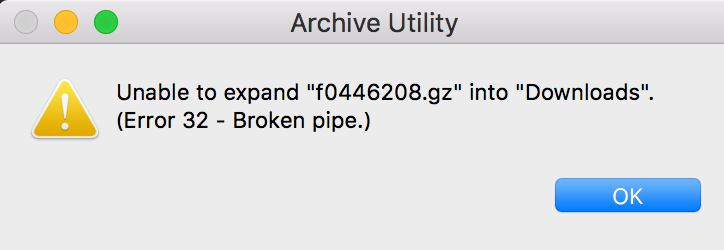

I have exactly the same problem here: formatted the 64gb card by mistake, in the camera menus (Sony a6500 camera).
I was also using the camera to record mp4 videos, in the same format as zhalberd mentioned.
Tried using photorec in MacOS 10.12.6 to try to recover the files.
Ended up with a some nice jpgs and a 64gb .gz file whose contents I can not decompress. Tried by MacOs Archive Utility and also by the Unarchiver app. Both showed error messages. (see attached files)
Is it possible that any of my files are compressed in this gz? Or is it just a corrupted file?
Screen Shot 2017-12-29 at 09.25.16.png (42.29 KiB) Viewed 4248 times
Screen Shot 2017-12-29 at 09.23.49.png (37.23 KiB) Viewed 4248 times
