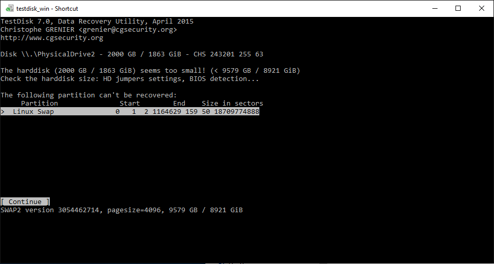

Hello there,
First off, thanks to TestDisk, I managed to avoid formatting and loosing data. Really great.
I have one remaining issue.
I have one 2TB external drive.
It seems that only TestDisk is able to see one Linux SWAP 2 partition available on the HDD.
When I go to "Select Disk" -> "Select Partition Table" (None is by default) -> "Analyse" I see the attached screenshot
On this disk there is another FAT32 partition that works great (the one I managed to fix)
Now, my problem is, I do not know how to remove this partition, the Linux SWAP 2, the one that says it cant be recovered.
I do not need this partition, however, I want the other one, FAT32 left alone.
Can you help me remove this Linux SWAP 2 partition in any way?
Thanks,
S.P.

You can ignore this Linux Swap partition.
After selecting the disk, choose PC Intel or EFI GPT.
Please post the new testdisk.log file.

#4 Post by cgrenier »
The FAT32 is using the whole disk. There is no room for another partition...
