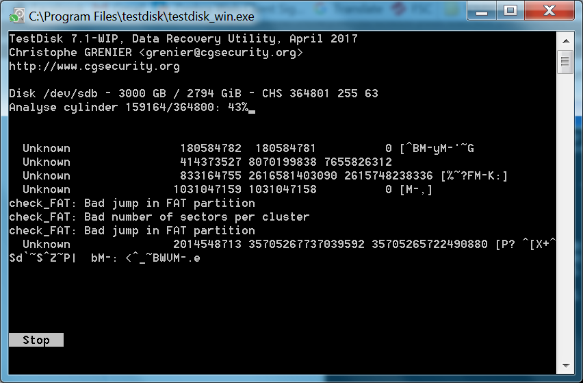

Re: Bad jump in FAT partition

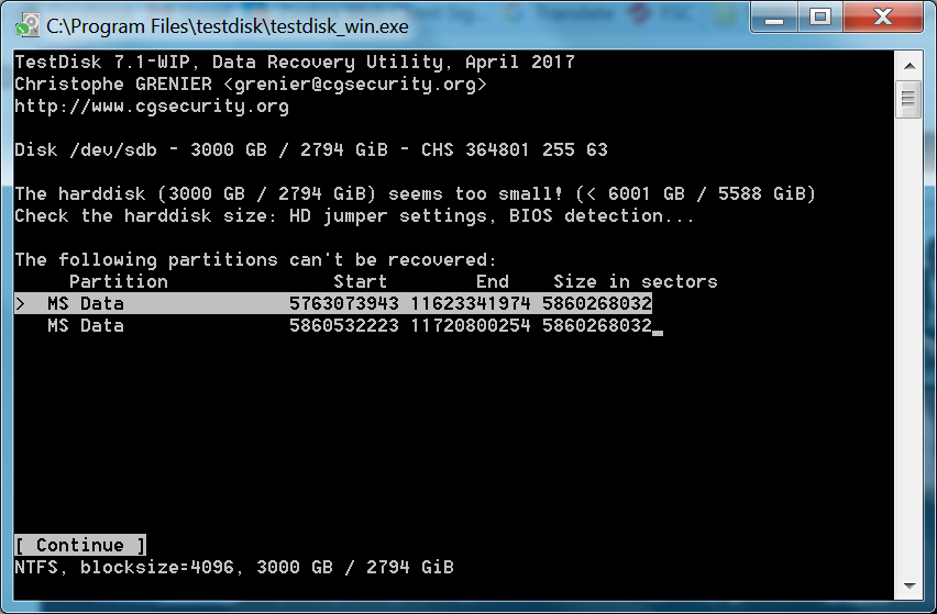

The QUick search is done with a weird result:
TestDisk 7.1-WIP, Data Recovery Utility, April 2017
The harddisk (3000 GB / 2794 GiB) seems too small! (< 6001 GB / 5588 GiB)
> MS Data 5763073943 11623341974 5860268032
MS Data 5860532223 11720800254 5860268032
What's going on here?
Any help?
Any help?
MS Data 264192 5860532223 5860268032
NTFS found using backup sector, blocksize=4096, 3000 GB / 2794 GiB

Disk /dev/sda - 600 GB / 558 GiB - CHS 72961 255 63, sector size=512 - Intel Raid 0 Volume, S/N:VELOCIRAID, FW:1.0.
Disk /dev/sdb - 3000 GB / 2794 GiB - CHS 364801 255 63, sector size=512 - WDC WD30 EZRZ-00WN9B0, S/N:W -DCW4C6EVV9T54, FW:80.0
Disk /dev/sdg - 32 GB / 29 GiB - CHS 3892 255 63, sector size=512 - SanDisk Cruzer Glide, S/N:20051032001AFB12E9DC, FW:2.01
Disk /dev/sdb - 3000 GB / 2794 GiB - WDC WD30 EZRZ-00WN9B0
Partition table type: EFI GPT
hdr_size=92
hdr_lba_self=1
hdr_lba_alt=5860533167 (expected 5860533167)
hdr_lba_start=34
hdr_lba_end=5860533134
hdr_lba_table=2
hdr_entries=128
hdr_entsz=128
2 P MS Data 264192 5860532223 5860268032 [Basic data partition]
LVM magic value at 4951/69/41
SYSV4 Marker at 11240/225/8
recover_sysv4
Unknown 180584782 180584781 0 [Âù§‡Ü]
SysV4, 0 B
Partition not added.
Unknown 414373527 8070199838 7655826312
WBFS, 3919 GB / 3650 GiB
SYSV4 Marker at 51862/27/25
recover_sysv4
Unknown 833164755 2616581403090 2615748238336 [%ÿFßË:]
SysV4, 1339 TB / 1218 TiB
SYSV4 Marker at 64179/182/59
recover_sysv4
Unknown 1031047159 1031047158 0 [¬]âŒIï]
SysV4, 0 B
Unknown 2014548713 35705267737039592 35705265722490880 [PÔ´ÓTX+îd`“|Ý[ Æ€ºì'<‚WV®eÍ]
BeFS blocksize=32768, 18281096 TB / 16626560 TiB
LVM magic value at 146550/128/15
Unknown 2819412314 2819412313 0
WBFS, 0 B
cramfs Marker at 180460/18/57
recover_cramfs
MS Data 2899091090 2900484517 1393427 [tDc§ƒŽSbÐY§_]
cramfs, 713 MB / 680 MiB
cramfs Marker at 196879/208/18
recover_cramfs
MS Data 3162874256 3168501556 5627300 [¬÷@àŠÇºÒÖ?šR½ ç]
cramfs, 2881 MB / 2747 MiB
SYSV4 Marker at 254396/1/3
recover_sysv4
Unknown 4086871805 1275126671100 1271039799296 [Œ±_ê8c]
SysV4, 650 TB / 591 TiB
NTFS at 358734/194/12
filesystem size 5860268032
mftmirr_lcn 2
NTFS part_offset=2950693858816, part_size=3000457232384, sector_size=512
mftmirr_lcn 2
This partition ends after the disk limits. (start=5763073943, size=5860268032, end=11623341974, disk end=5860533168)
The EFI GPT partition table is ok.
Run TestDisk, Advanced, select the last partition, Boot, BackupBS, confirm, Quit and restart your computer.
Once it's done, use "chkdsk /f d:" (right click run as administrator, replace d: by the correct drive letter). What is the result ?

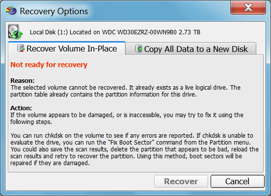

As I was at a loss on how to proceed, I tried some things with 'active partition recovery'.
I tried its 'fix boot sector' option and it copied the boot sector over from a backup. Now all copies look the same. Then I tried to 'recover' the partitions and it gave me the following: I tried to chkdsk but it would say 'Unable to determine volume version and state. CHKDSK aborted.'

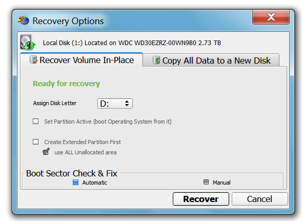

So I followed the instructions and deleted the volume in acronis disk director.
Then I came back to 'active partition recovery', loaded my previous saved scan and it recovered the partition.
For the first time I can see the folder structure shown, but the drive is marked 'BAD'. In windows explorer, I get 'The parameter is incorrect.' instead of 'format the drive' which I remember getting (i think).
Disk management still shows this as a single RAW partition.

This is how I recovered the volume after I deleted it.
This is where I stand before receiving your post.
