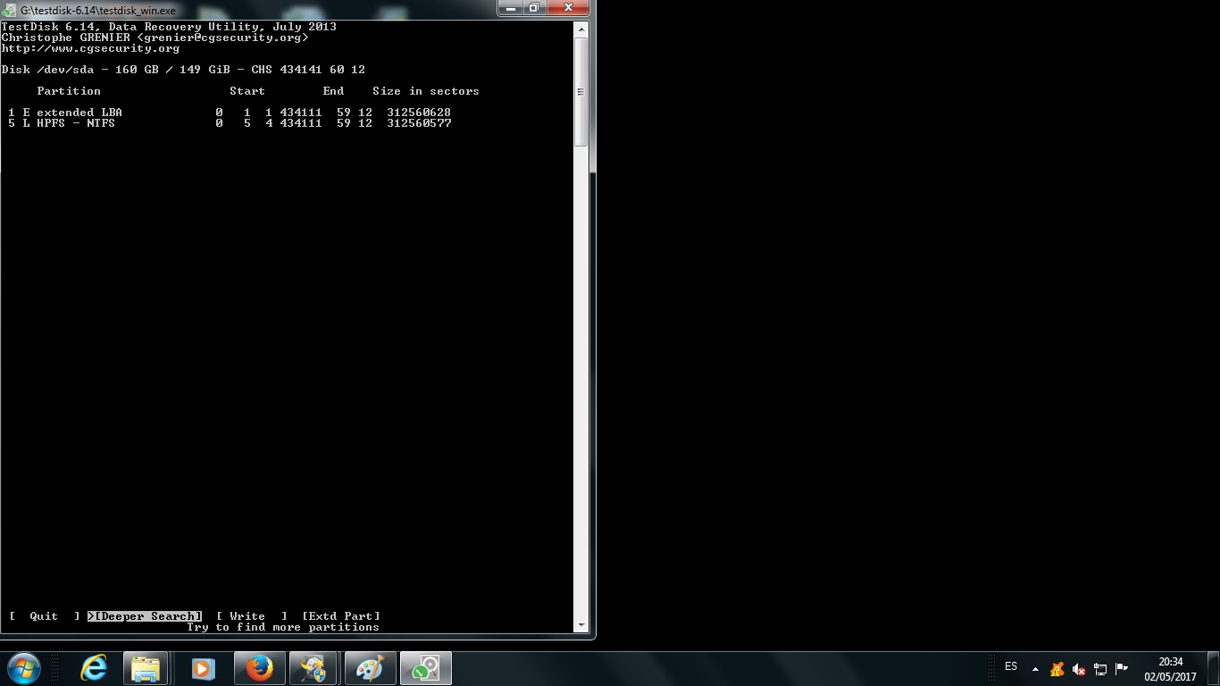

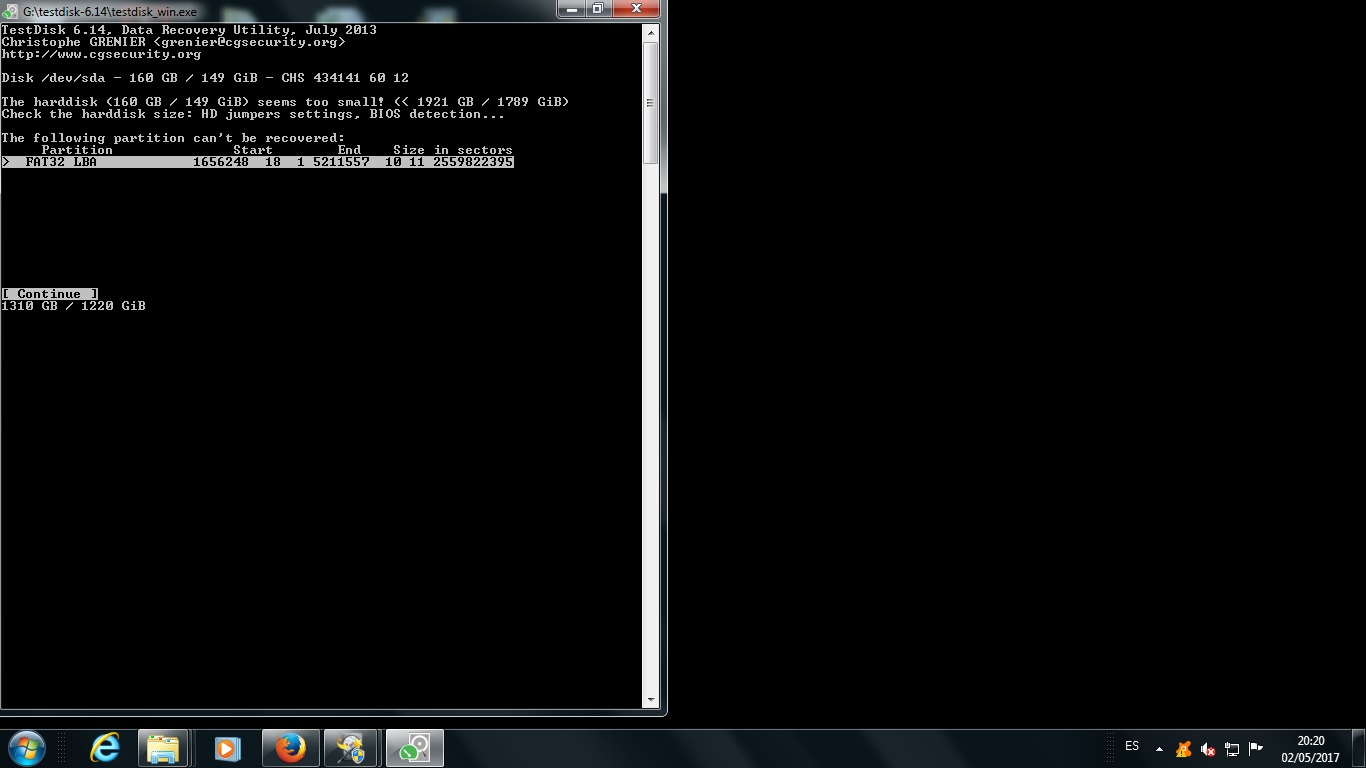

Hello! I accidentally delete a partition and I do not know how to recover it .. testdisk warns me of some errors I do not understand .. then attached in order the screens that came out .. I hope they can help me .. I had two partitions .. the disk c, the Disk b that was the one to eliminate, and a disk reserved for the system. But as I can not see the files I do not know if it is the one that eliminates ...

Please use TestDisk 7.1-WIP instead of an older version.
No free space is visible on your disk, so no there is no deleted partition.
Did you delete the previous partition and create and format another partiton ?
