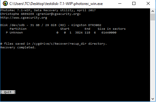

PhotoRec - Couldn't detect anything because USB was raw.

Can you post the results using PhotoRec ?

It says 0 files recovered. (Attached pictures).

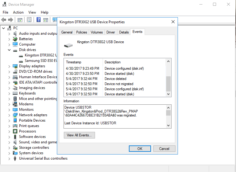

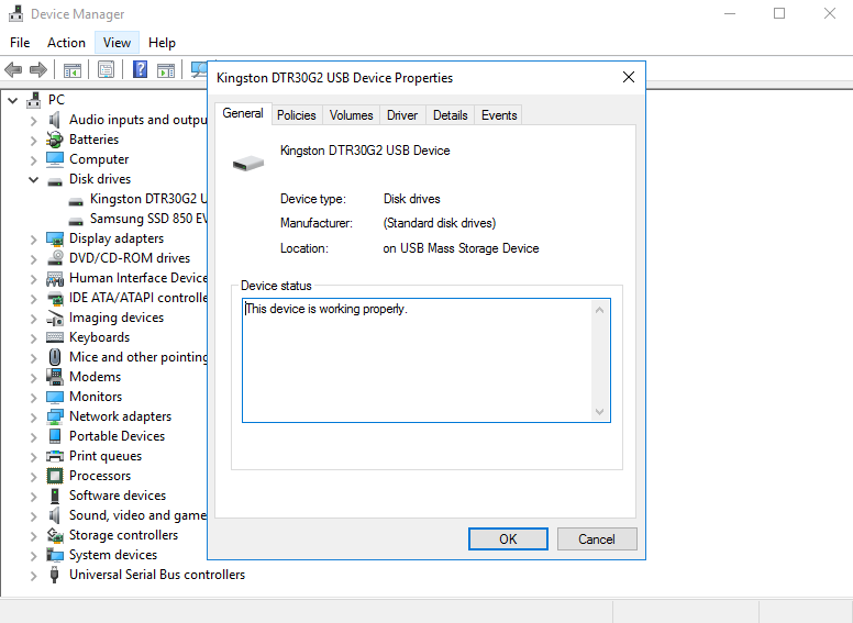

I am not sure what is going on. In device manager, it says my USB is working properly. It says device got deleted on 5/4/2017, how do I undelete it? A random error basically wiped the USB into a RAW USB. What is the best option? I would hate to go to a professional company for a few notepad files.
