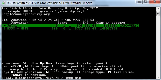

I have gotten as far as the enclosed screen, and would like to know where I go from there, as I have a lot of hugely important work on there (some day, I'll get lucky and only lose files that I don't care about!), and need access to it as soon as possible (my deadline is 18:00 GMT+00, so I'm getting a little nervy at the moment)

Your screen is from Quick Search.
Did you mark your partitions and press p to list your files?
Especially the second partition.
I assume it's the one containing your data?
To compare the difference I'd need another screenshot.
It's from Analyse (if you confirm at analyse and this is your current partition table).

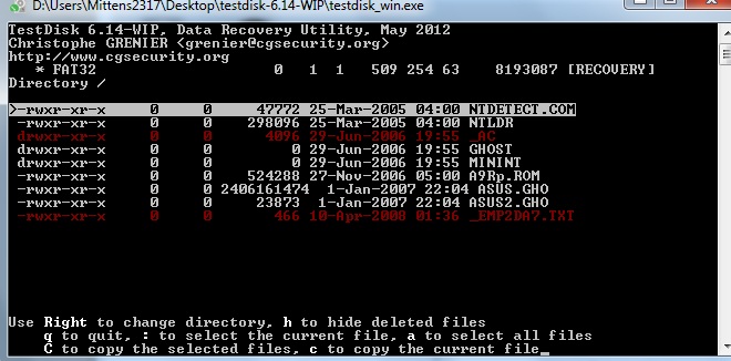

I've pressed P to list files. The second partition reads "Can't open filesystem. Filesystem seems damaged.", and here's a screenshot from the first partition's file list:Fiona wrote:Your screen is from Quick Search.

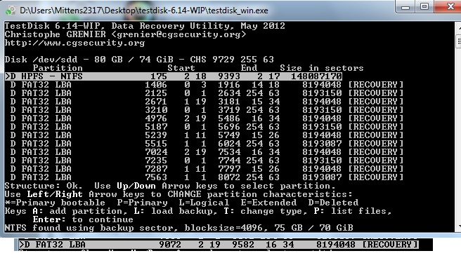

Tried it again and here's what happened: (was sure I posted this a minute ago btw)

Re: Delayed Write Failed/Directory Corrupted or Unreadable..
Did you have a try to list your files from that found NTFS partition?

Yes, it still says "Can't open filesystem. Filesystem seems damaged." As do all the others.
Would it be possible to have a try to diagnose ypir boot sector?
Same procedur like in this case;
Rebuilding a boot sector searches your MFT and cpuld be able to list files.
In this case I don't recommend to restore your partition but to copy/backup your files.
