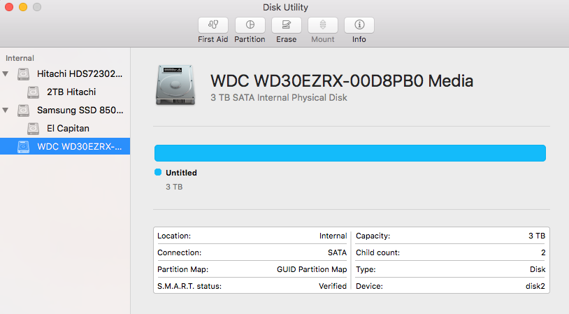

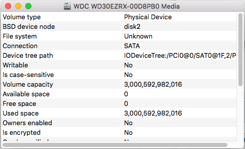

I am running a hackintosh with my 3TB as a slave formatted in exFAT. My partitions have disappeared (I actually only have 1 main exFAT partition on it), but I was able to run TestDisk and it was able to correctly identify the partitions. In fact, it even lists the files correctly. However, when I select "write" and reboot, nothing happens; the disk still does not mount.
During quick search, I get this:
TestDisk 7.1-WIP, Data Recovery Utility, May 2017
Disk /dev/rdisk2 - 3000 GB / 2794 GiB - 5860533168 sectors
Warning: number of heads/cylinder mismatches 16 (FAT) != 1 (HD)
Warning: number of sectors per track mismatches 32 (FAT) != 1 (HD)
EFI System 40 409639 409600 [EFI System Partition]
MS Data 411648 5860532223 5860120576
What should I do?
Thank you.
Screen Shot 2017-06-25 at 10.53.57 AM.png (52.03 KiB) Viewed 1907 times
Screen Shot 2017-06-25 at 10.53.45 AM.png (79.88 KiB) Viewed 1907 times

Can you try to repair the filesystem using "sudo fsck_exfat -y device" ?
If it doesn't work, copy all the files using testdisk on another disk, reformat the original partition, copy the files back to this disk.
