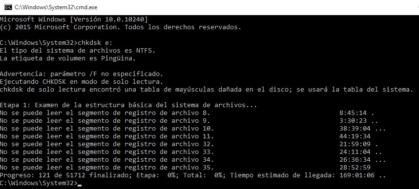

I tell you my dilemma: I have a 1 TB Hitachi hard drive and "someone" unplugged it from a PC with windows 7 without doing the typical "right click, eject". Result: Windows 10 (x64 - other PC) does not recognize it and wants to format it (I have not formatted it. Because it is complete (1TB full of files). I have run the net with "TestDisk" tutorials, apply it and something strange happens: I'll explain them better with screenshots:
1.- This is my windows 10, telling me the HD (E:) is RAW:
Ver Imagen: http://s2.subirimagenes.com/otros/previ ... itachi.jpg
2.- This is what the chkdisk says about " E: " (that is NTFS):
Falla dd Hitachi.jpg (75.64 KiB) Viewed 1802 times

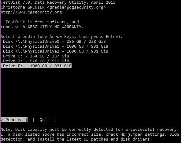

3.- Then, I execute "TestDisk": I select "Intel" an then "Drive E:", here:
Falla dd Hitachi1.jpg (49.56 KiB) Viewed 1802 times

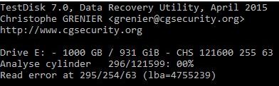

4.- while doing the quick search, show this:
Falla dd Hitachi3.jpg (16.7 KiB) Viewed 1802 times

7.- Both "searches" lasted between 40 to 50 minutes. And only found "read error" in these cylinders: 295 and 296.

The read errors near cylinder 295 and 296 are due to bad sectors.
You should clone the disk using ddrescue to a new empty disk as described in https://www.cgsecurity.org/testdisk.pdf chapters "Creating a live USB" and "DDRescue: data recovery from damaged disk".
Once it's done, remove the original disk and try to recover your data from the clone (chkdsk /f e:)
