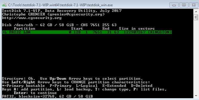

This is what testdisk analysis is returning:

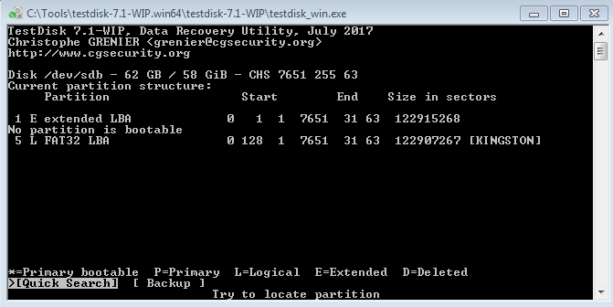

And results of quick search:
Can you please advise what I can do?

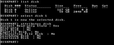

Unfortunately I've tried running chkdsk before and I am getting this:
Windows cannot run disk checking on this volume because it is write protected.
I am not able to take down the "Current Read-Only state: Yes" flag. I have tried diskpart, rmPrepUSB, and registry change. The flag is still there:
Also I did apply change to hidden files visibiity with no luck. I have even applied it for operating system files but there is nothing more appearing.

Re: Kingston SE9 G2 64GB USB 3.0 Partition Recovery issue
Posted: 05 Oct 2017, 20:41
by karko
Sorry you might have missed that but I have tried many options to remove this att. Unfortunately nothing helps...
I am not able to take down the "Current Read-Only state: Yes" flag. I have tried diskpart, rmPrepUSB, and registry change. The flag is still there...
