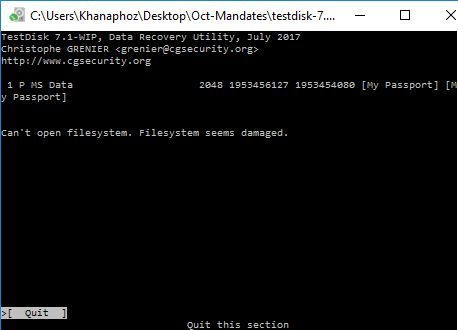

Now my new harddisk (the one bought couple of days back) is behaving exactly the same way as my old one i.e cannot see it in the file explorer. Also attached below the testdisk/chkdsk logs on it :

Should I try the cloning on a 2TB hdd or these errors are not due to that incomplete issue ( 99.99 % copy ). :roll:
Re: WD My Passport turned RAW from NTFS
#10 Post by cgrenier »
Run "chkdsk /f G:" and not "chkdsk G:"
