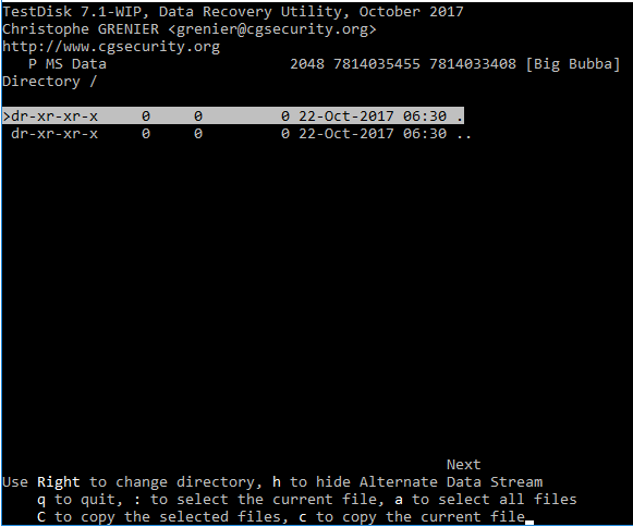

when i use "p" to view files, this is all i see.
Should i select write?
- d.png (12.43 KiB) Viewed 10228 times

Re: ran diskpart on a 4TB drive....
As "Big Bubba" is an empty partition, you should try Undelete and if it doesn't work, PhotoRec.
i tried the undelete (under advanced options) and it said no deleted files but PhotoRec finds the files. is there any other way to recover the entire drive?cgrenier wrote: 16 Nov 2017, 06:57 As "Big Bubba" is an empty partition, you should try Undelete and if it doesn't work, PhotoRec.
