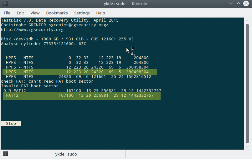

1. Started quick search and only actual partitions are showed. After that I selected a deep search trying to find the old partition.

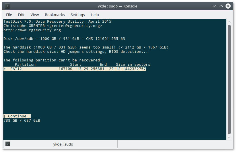

2. After a time, deep search testdisk found the partition that probably I want and and error with fat boot sector.
3. Waiting until the deep search is completed a message "hard disk seems to small and FAT12 partition can't be recovered"
When I press enter to continue, the partition that I want disappear.
How to solve this problem I think message about disk too small is for the bad boot sector showed.

When I press enter to continue, partitions that I want to recover disappear. Only actual partions of my harddisk are shown.

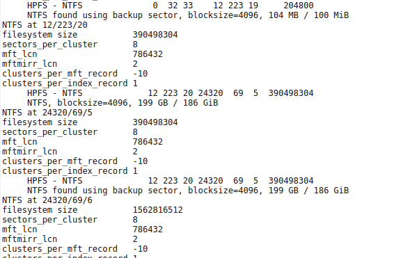

The log file says that partitions it was found using backup sector. I don't know why it disappear when I press enter.

NTFS found using backup sector, blocksize=4096, 104 MB / 100 MiB
NTFS at 12/223/20
filesystem size 390498304
mftmirr_lcn 2
HPFS - NTFS 12 223 20 24320 69 5 390498304
NTFS, blocksize=4096, 199 GB / 186 GiB
NTFS at 24320/69/5
mftmirr_lcn 2
NTFS found using backup sector, blocksize=4096, 199 GB / 186 GiB
NTFS at 24320/69/6
filesystem size 1562816512
mftmirr_lcn 2
HPFS - NTFS 24320 69 6 121601 25 24 1562816512
NTFS, blocksize=4096, 800 GB / 745 GiB
BAD_RS LBA=2684462347 10280596
FAT12 167100 13 29 256881 29 12 1442332757
This partition ends after the disk limits. (start=2684462347, size=1442332757, end=4126795103, disk end=1953525168)
The harddisk (1000 GB / 931 GiB) seems too small! (< 2112 GB / 1967 GiB)
