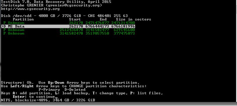

4TB-Disk (GPT, 3 partitions, each NTFS) went corrupt, started TestDisk, said first GPT signature corrupt, read alternate GPT signature, was fine.
I backuped the working GPT signature and wrote it to disk.
System Restart.
Checked Computer Management, showed me this nonsense:
The empty 128 MB are correct, the starting position of (D:) is correct too, the rest is nonsense. I'm saying what TestDisk wrote to the Disk is not correct at all.
(D:) should be around or exactly double the shown size, (I:)'s and (J:)'s Size is correct, but they should be located at the end of the disk. There should be no empty space after them.
This leads to me being able to list the files on (D:) (as the file systems starting position appears correct) but not on (I:) and (J:).
While I do not think it's simply TestDisks fault I wonder what went wrong with writing the backup to the Disk.
Do I have to check for something else before writing the backup to disk? Sector Size or something?
I'm currently unable to come up with a logfile as I'm still running a quick search on the disk.
The green entrys show the content of the backuped data, the white line is just a wrong entry after writing the backup to the disk and can be ignored, I guess.
I also tried to set the "unknown"-labeled entries to GPT EFI/NTFS and also to MS Data/NTFS. Setting it to the latter one showed me the above situation from picture 1.
Really hope someone can help with this problem - it's kind of life relevant.

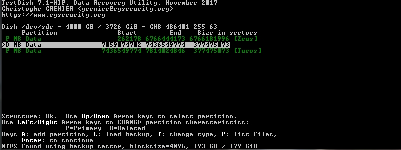

Re: TestDisk wrote backuped Partition Tables wrong to disk
The screenshot from Windows Disk Manager looks like it's using PC Intel partition instead of EFI GPT...
Try to rewrite the partition table using testdisk 7.1-WIP. Do you still have the same problem ?

I first had TestDisk quick scan the drive for about 12 hours and as I was investigating what it found I wanted to check the file systems using "p". On the 2nd partition testdisk silently crashed without any further notice. So all the quick search progress was lost.
Using MiniTool Partition Recovery I was able to get to this current state.
The first partition is now fully accessible again and shows it's proper partition size. (I checked a few files and guess their integrity is fine so far...) The other two are not. The 319,53 GB of "empty space" between the shown partitions are of exactly the space the 2nd partition had, but neither TestDisk nor Minitool Partition Recovery was able to find a partition at this space.
Is there any safe way to declare this empty space as a partition again?
The last partition shown at the end also seems to be my 3rd partition, but it's in a RAW state.
Using Recuva I was able to verify that files my 3rd partition are able to be found here.
What does it make it look like it's PC Intel Partition instead of EFI GPT?
Except for my system drive SSD all my hard disks are detected as EFI GPT by TestDisk (currently been using v7.0).
I have 3 identical HardDisks like the one with the issue; 3x WD Red 4TB - all using EFI GPT. I kind of doubt that I've been formating them in different ways as I did format them all using Windows' Disk Management as GPT Disks.
On the other hand I don't want to put my doubts over your knowledge either...
I thought about trying what you said but as I'm currently able to access the first partition and I don't want to risk losing this access again. I'm about to order a new Drive for this to replace but until then I'm unable to backup the whole 3 TB on it.
Thanks for any help given.
