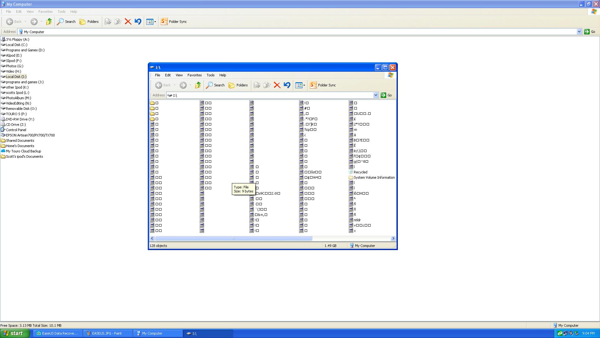

Well I'm not sure exactly how this happened but the primary partition was accidentally converted to FAT12 from NTFS while I was cleaning the keyboard. The rest of the partition, however stayed as NTFS. It became unbootable as the operating system was on the primary (C) partition. I bought a second drive and installed the OS and am using the corrupted/unrecognized partition drive as a second drive. The corrupted partition was relabeled as (I) by WindowsXP but is unreadable and I can't seem to pull any Data. I am trying to use Easeus but seem to be getting nowhere very slowly and don't want to pay $70 for a program that doesn't seem to be getting anywhere . It's been deep scanning for 4 days now and isn't even half done. The Drive is a WD 500gb. Will Test disk do the job? I would like to reconstruct the data first and save it to a backup drive and then after that is done try and make the drive bootable again. It would be great if someone could walk me through the procedure or point me to a tutorial on how to do both opperations. I'd like to be able to keep the file structure intact as I have some cryptocurreny wallets and DAT files that I don't want to have to laboriously search for.
- Idrive
- IDRIVE.JPG (171.05 KiB) Viewed 25826 times

Run TestDisk, Advanced, select the partition, Type, force it to NTFS, Boot, RebuildBS, List.
If you can see your files, choose Write, confirm Quit and restart your computer.
If it doesn't work, please post the testdisk.log file content.

So I ran Photorec because I didn't want to compromise the partition any further by trying to force it to NTFS from the FAT12 file system and it pulled up this (see Photo). All jumbled text and HTML files. What exactly am I looking at and why don't you think it recovered any files/photos/executables?

I don't see NTFS as an option to force the FAT12 to NTFS. The image shows the 3 file systems available.cgrenier wrote: 18 Jan 2018, 18:12 Run TestDisk, Advanced, select the partition, Type, force it to NTFS, Boot, RebuildBS, List.

If you select the partition I: you should select partition type None. There is no partitions inside a partition.
Which one of these Do I choose. I don't see NTFS as a stand alone choice
Re: Accidental conversion from NTFS to FAT12
NTFS is number 7.

During RebuildBS the program just shut down. It looks like it generated a stackdump file. I'm trying to attatch the 2 files but don't seem to be able to.

NTFS, blocksize=4096, 85 GB / 80 GiB
X extended 23840 0 1 34802 254 63 176120595
7 L HPFS - NTFS 23840 1 1 34802 254 63 176120532
NTFS, blocksize=4096, 90 GB / 83 GiB
X extended 34803 0 1 47550 254 63 204796620
8 L HPFS - NTFS 34803 1 1 47550 254 63 204796557
NTFS, blocksize=4096, 104 GB / 97 GiB
X extended 47551 0 1 60800 254 63 212861250
9 L HPFS - NTFS 47551 1 1 60800 254 63 212861187
NTFS, blocksize=4096, 108 GB / 101 GiB
ntfs_boot_sector
1 * HPFS - NTFS 0 1 1 7721 254 63 124053867
filesystem size 4705734185631875073 15087055580947150938
sectors_per_cluster 8 196
mft_lcn 538985805 2639431764
mftmirr_lcn 540160340 3887858461
clusters_per_mft_record -114 48
clusters_per_index_record 123 -106
Status: Bad
Status: Bad
Sectors are not identical.
3 [main] testdisk_win 2580 cygwin_exception::open_stackdumpfile: Dumping stack trace to testdisk_win.exe.stackdump
Here's the stackdump
Exception: STATUS_ACCESS_VIOLATION at eip=0043E5A6
eax=00000000 ebx=20104718 ecx=0023ED66 edx=CA11BE9C esi=0037F62A edi=00000000
ebp=20102AB8 esp=0023B210 program=C:\Documents and Settings\Home\My Documents\Downloads\testdisk-7.0.win\testdisk-7.0\testdisk_win.exe, pid 2580, thread main
cs=001B ds=0023 es=0023 fs=003B gs=0000 ss=0023
Stack trace:
Frame Function Args
20102AB8 0043E5A6 (00000000, 00000000, 00000000, 00000000)
End of stack trace
And here's the log
Wed Jan 31 23:23:48 2018
OS: Windows XP SP3
disk_get_size_win32 IOCTL_DISK_GET_LENGTH_INFO(\\.\C:)=209711706624
disk_get_size_win32 IOCTL_DISK_GET_LENGTH_INFO(\\.\D:)=104855837184
disk_get_size_win32 IOCTL_DISK_GET_LENGTH_INFO(\\.\E:)=110103565824
disk_get_size_win32 IOCTL_DISK_GET_LENGTH_INFO(\\.\F:)=107529053184
disk_get_size_win32 IOCTL_DISK_GET_LENGTH_INFO(\\.\G:)=213010043904
disk_get_size_win32 IOCTL_DISK_GET_LENGTH_INFO(\\.\H:)=254991873024
disk_get_size_win32 IOCTL_DISK_GET_LENGTH_INFO(\\.\I:)=63515579904
disk_get_size_win32 IOCTL_DISK_GET_LENGTH_INFO(\\.\J:)=46587953152
disk_get_size_win32 IOCTL_DISK_GET_LENGTH_INFO(\\.\K:)=85987044864
disk_get_size_win32 IOCTL_DISK_GET_LENGTH_INFO(\\.\L:)=90173712384
disk_get_size_win32 IOCTL_DISK_GET_LENGTH_INFO(\\.\M:)=104855837184
disk_get_size_win32 IOCTL_DISK_GET_LENGTH_INFO(\\.\N:)=108984927744
disk_get_size_win32 IOCTL_DISK_GET_LENGTH_INFO(\\.\P:)=500105740288
filewin32_getfilesize(\\.\Y:) GetFileSize err Incorrect function.
filewin32_setfilepointer(\\.\Y:) SetFilePointer err Incorrect function.
Warning: can't get size for \\.\Y:
filewin32_getfilesize(\\.\Z:) GetFileSize err Incorrect function.
filewin32_setfilepointer(\\.\Z:) SetFilePointer err Incorrect function.
Warning: can't get size for \\.\Z:
Disk /dev/sdb - 500 GB / 465 GiB - CHS 60801 255 63, sector size=512
Disk /dev/sdc - 500 GB / 465 GiB - CHS 60801 255 63, sector size=512
Drive C: - 209 GB / 195 GiB - CHS 25495 255 63, sector size=512
Drive D: - 104 GB / 97 GiB - CHS 12747 255 63, sector size=512
Drive E: - 110 GB / 102 GiB - CHS 13385 255 63, sector size=512
Drive F: - 107 GB / 100 GiB - CHS 13072 255 63, sector size=512
Drive G: - 213 GB / 198 GiB - CHS 25896 255 63, sector size=512
Drive H: - 254 GB / 237 GiB - CHS 31000 255 63, sector size=512
Drive I: - 63 GB / 59 GiB - CHS 7721 255 63, sector size=512
Drive J: - 46 GB / 43 GiB - CHS 5663 255 63, sector size=512
Drive K: - 85 GB / 80 GiB - CHS 10453 255 63, sector size=512
Drive L: - 90 GB / 83 GiB - CHS 10962 255 63, sector size=512
Drive N: - 108 GB / 101 GiB - CHS 13249 255 63, sector size=512
Drive P: - 500 GB / 465 GiB - CHS 60801 255 63, sector size=512
NTFS at 7722/1/2
NTFS at 13386/1/1
NTFS at 23840/1/1
NTFS at 34803/1/1
NTFS at 47551/1/1
get_geometry_from_list_part_aux head=255 nbr=18
get_geometry_from_list_part_aux head=8 nbr=4
get_geometry_from_list_part_aux head=16 nbr=4
get_geometry_from_list_part_aux head=32 nbr=4
get_geometry_from_list_part_aux head=240 nbr=3
2 E extended LBA 7722 0 2 60800 254 63 852714134
5 L HPFS - NTFS 7722 1 2 13385 254 63 90992096
NTFS, blocksize=4096, 46 GB / 43 GiB
X extended 13386 0 1 23839 254 63 167943510
6 L HPFS - NTFS 13386 1 1 23839 254 63 167943447
Change partition type:
ntfs_boot_sector
Status: Bad
Status: Bad
3 [main] testdisk_win 2144 cygwin_exception::open_stackdumpfile: Dumping stack trace to testdisk_win.exe.stackdump
Wed Jan 31 23:26:27 2018
OS: Windows XP SP3
NTFS at 0/32/33
1 P HPFS - NTFS 0 32 33 60801 47 46 976769024
ntfs_boot_sector
NTFS at 0/32/33
NTFS at 0/32/33
filesystem size 976769024
mftmirr_lcn 2
Status: OK
Status: OK
Sectors are identical.
rebuild_NTFS_BS
mft at 16
ntfs_find_mft: mft_lcn 786432
ntfs_find_mft: mftmirr_lcn 2
mftmirr_lcn 2
5 dr-xr-xr-x 0 0 0 21-Jan-2018 14:33 .
5 dr-xr-xr-x 0 0 0 21-Jan-2018 14:33 ..
40 dr-xr-xr-x 0 0 0 27-Apr-2015 18:06 $RECYCLE.BIN
65 dr-xr-xr-x 0 0 0 31-Dec-2016 16:01 @sharebin
64 dr-xr-xr-x 0 0 0 11-May-2017 21:44 @tmp
45899 dr-xr-xr-x 0 0 0 31-Jan-2018 20:58 IphotorecBackup
98228 dr-xr-xr-x 0 0 0 31-Jan-2018 21:17 Itestdiskbackup
45835 dr-xr-xr-x 0 0 0 28-Aug-2014 23:12 RECYCLER
37 dr-xr-xr-x 0 0 0 21-Jan-2018 17:45 System Volume Information
98217 dr-xr-xr-x 0 0 0 19-Nov-2009 00:23 transferwizard
53 dr-xr-xr-x 0 0 0 7-Jan-2018 23:08 winxpbackup
56 -r--r--r-- 0 0 36 7-Jan-2018 23:08 .tourocloudbackupid
35 -r--r--r-- 0 0 7539672 13-Oct-2014 00:20 SetupTouro3771.exe
mftmirr_lcn 2
ntfs_boot_sector
NTFS at 0/32/33
NTFS at 0/32/33
mftmirr_lcn 2
Status: OK
Status: OK
NTFS at 7722/1/2
NTFS at 13386/1/1
NTFS at 23840/1/1
NTFS at 34803/1/1
NTFS at 47551/1/1
ntfs_boot_sector
Status: Bad
Status: Bad
