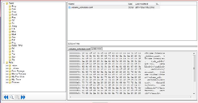

There are about 15,000 pictures in about 1,000 different folders. Below, the first picture shows the folder structure --inside the red circle--of the "BTRFS" that I would like to recover but NEED HELP to ensure I do not lose all the photos of my family and more. :(
Second pic shows the hex data if that helps anyone.
Third pic is the scan from TestDisk I hope to rescue my pics and docs.

The screenshot shows that another data recovery utility has been able to list your files, so why not use it ?
You can always use photorec to recover your pictures but it will not recover the original file structure.

These were all the partitions found by Test disk. Which ones are the ones that have the files and how do I save them? Please in the folders they are in currently.
