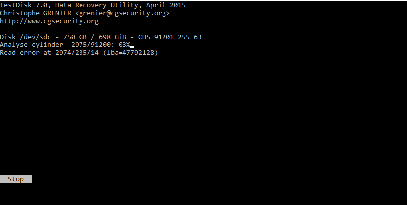

thanks for your reply. I think I tried it as Administrator as well. Right now I run the analysis again but it throws read errors the whole time.
Same settings as before: TestDisk 7.0 as Admin, Disk connected via USB-SATA-Adaptor, Intel-Style.
I attached a screenshot. Looks like there is a readerror at every cylinder.
Something I realize right now: the drive is surprisingly silent. It is spinning but I do not hear the usual rattling noise of a head beeing moved. But if the head would not move we should not see the partitions in windows, right?
Cheers
Max

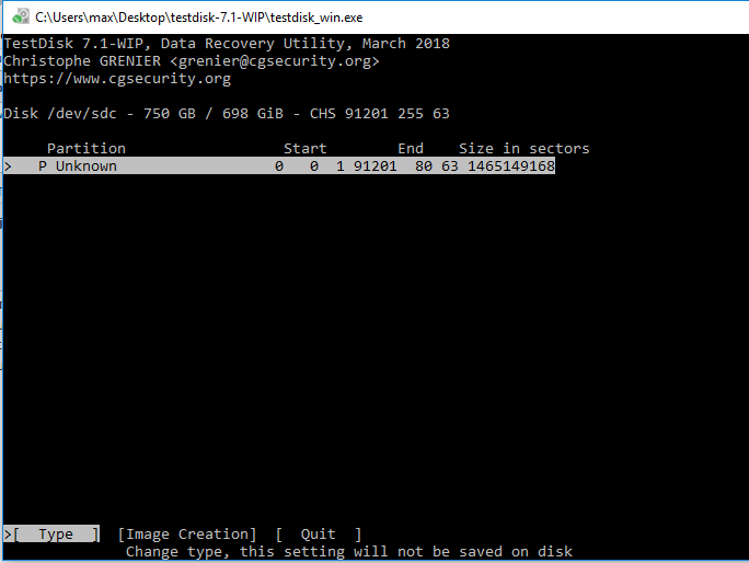

I found another topic in this forum (viewtopic.php?t=2600) where somebody lost data with a synology NAS. He mentioned he found *something* when he ran the search with the partition table style "none". I tried this as well and found this:
Unfortunately I have no idea what these numbers should tell me :/ When I choose ext4 as Type I still cannot find any files. I was not able to find any information which kind of partition table style Synology uses. Do you have any idea from a previous case of lost data?
Sorry for asking a maybe stupid question again but how could windows tell there are some kind of partitions on this drive but TestDisk or Synology or some DiskInternals Linux Reader ext4 driver thing can't read/access these partitions?
