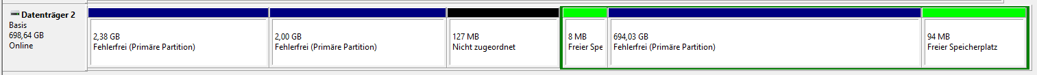

From what I know it should be ext4 file system (because I chose what Synology was recommending). The drive still spins up and is recognised in windows when connected directly via SATA or SATA-USB-adaptor. It seems to be kinda okay because its not completely raw or something. I attached a screenshot of windows' Disc Management.

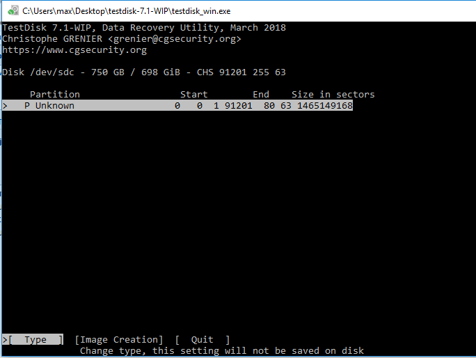

I found another topic in this forum (viewtopic.php?t=2600) where somebody lost data with a synology NAS. He mentioned he found *something* when he ran the search with the partition table style "none". I tried this as well and found this:
Unfortunately I have no idea what these numbers should tell me :/ When I choose ext4 as Type I still cannot find any files. I was not able to find any information which kind of partition table style Synology uses. Do you have any idea from a previous case of lost data?
Sorry for asking a maybe stupid question again but how could windows tell there are some kind of partitions on this drive but TestDisk or Synology or some DiskInternals Linux Reader ext4 driver thing can't read/access these partitions?
