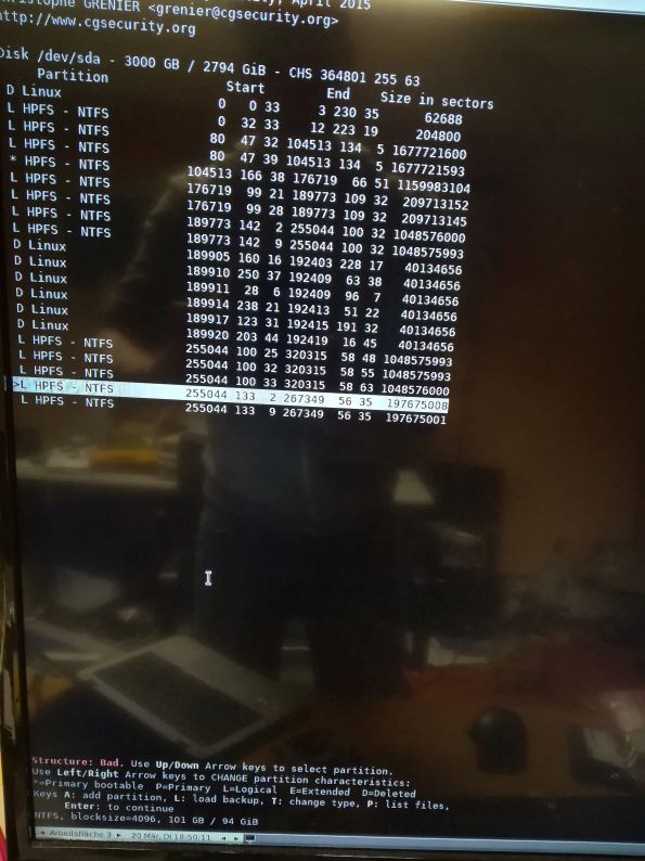

Re: Recover 3TB HDD which was overwritten with 32MB Image
Thanks for your answer.
I attached what I get after scan.
Why I have two or three partitions with same start (and sometime also same end adress)?
There are three partitions with start adress 100 and two of them have also same endadress.
And testdisk writes for some "NTFS found using backup sector, blocksize=4096, xxx GB / xxxGiB" and for some "NTFS blocksize = 4096, xxxGB / xxx GiB. What's the difference and how to continue?
Thanks for helping me!
Ok, the same partiton is listed two or more times 'coz some structures are bad, I got it.
After deep scan I select my 5 partions, bootable partion is recordnized by testdisk correctly and the other 4 I change to logical (at all five part. I can see my files and they are ok).
But I get an error:
Invalid partition structure
What Do I wrong? Log is attached
But I get an error:
