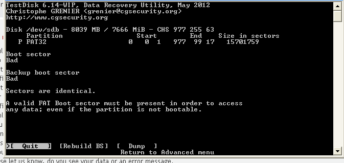

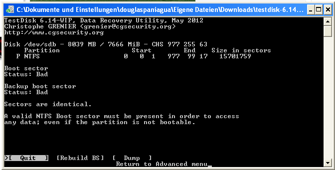

Re: usb: the device is not formated, do you want to format i
Hi Fiona,
if I select any of the other options I get: No Partition Available.
Only by selecting "none/advanced" I get:
Partition: P unknown
start: 0 0 1
End: 977 99 17
Size in sectors: 15701759
Well, here then I selected "type/fat32/boot/rebuild bs/"
=> can't see clusters
then I sarted again and did "type/fat32/boot/rebuild bs/"
=> see atached pictures and logs
Any suggestion about how to proceed?
Best Regards,
start: 0 0 1
End: 977 99 17
Best Regards,
- ntfs screenshot
- ntfs.PNG (22.03 KiB) Viewed 24030 times
- fat32 screenshot
- fat32.PNG (12.88 KiB) Viewed 24030 times
fat32 log
Thu Jul 5 21:28:56 2012
OS: Windows XP SP3
Compilation date: 2012-06-27T08:51:50
disk_get_size_win32 IOCTL_DISK_GET_LENGTH_INFO(/dev/sdb)=8039300608
disk_get_size_win32 IOCTL_DISK_GET_LENGTH_INFO(\\.\PhysicalDrive1)=8039300608
disk_get_size_win32 IOCTL_DISK_GET_LENGTH_INFO(\\.\C:)=85904792064
disk_get_size_win32 IOCTL_DISK_GET_LENGTH_INFO(\\.\D:)=66739921920
disk_get_size_win32 IOCTL_DISK_GET_LENGTH_INFO(\\.\F:)=8039300608
Disk /dev/sda - 160 GB / 149 GiB - CHS 19457 255 63, sector size=512 - ST916031 4AS, S/N:V54CAEHL, FW:0002
Disk /dev/sdb - 8039 MB / 7666 MiB - CHS 977 255 63, sector size=512 - SanDisk Cruzer, FW:7.01
Disk /dev/sdb - 8039 MB / 7666 MiB - SanDisk Cruzer
Partition table type: None
P Unknown 0 0 1 977 99 17 15701759
Change partition type:
P FAT32 0 0 1 977 99 17 15701759
fat32_boot_sector
Bad
Bad
Sectors are identical.
rebuild_FAT_BS p_fat12 0, p_fat16 0, p_fat32 1
fat_find_type(max_offset=122733, p_fat12=0, p_fat16=0, p_fat32=1, debug=1, dump_ind=0)
No FAT found, reserved=0, fat_length=0
find_sectors_per_cluster skip_sectors=718 (skip_offset=367616)
Can't find cluster size
fat32_boot_sector
Bad
Bad

dummytransistor
- Posts: 8
- Joined: 01 Jul 2012, 23:10
ntfs log
OS: Windows XP SP3
fat32_boot_sector
Bad
Bad
fat32_boot_sector
Bad
Bad
fat32_boot_sector
Bad
Bad
P NTFS 0 0 1 977 99 17 15701759
ntfs_boot_sector
filesystem size 1
sectors_per_cluster 0
mft_lcn 0
mftmirr_lcn 0
clusters_per_mft_record 0
clusters_per_index_record 0
Status: Bad
Status: Bad
rebuild_NTFS_BS
Search mft stopped: 65536/15701759
ntfs_boot_sector
filesystem size 1
mft_lcn 0
mftmirr_lcn 0
Status: Bad
Status: Bad
ntfs_boot_sector
filesystem size 1
mft_lcn 0
mftmirr_lcn 0
Status: Bad
Status: Bad
rebuild_NTFS_BS
file_pread(5,1,buffer,15701759(977/99/18)) ReadFile Die Anforderung konnte wegen eines E/A-Gerätefehlers nicht ausgeführt werden.
ntfs_boot_sector
filesystem size 1
mft_lcn 0
mftmirr_lcn 0
Status: Bad
Status: Bad
fat32_boot_sector
Bad
Bad
fat32_boot_sector
Bad
Bad
fat32_boot_sector
Bad
Bad
ntfs_boot_sector
filesystem size 1
mft_lcn 0
mftmirr_lcn 0
Status: Bad
Status: Bad
rebuild_NTFS_BS
ntfs_boot_sector
filesystem size 1
mft_lcn 0
mftmirr_lcn 0
Status: Bad
Status: Bad
ntfs_boot_sector
filesystem size 1
mft_lcn 0
mftmirr_lcn 0
Status: Bad
Status: Bad
rebuild_NTFS_BS
ntfs_boot_sector
filesystem size 1
mft_lcn 0
mftmirr_lcn 0
Status: Bad
Status: Bad
