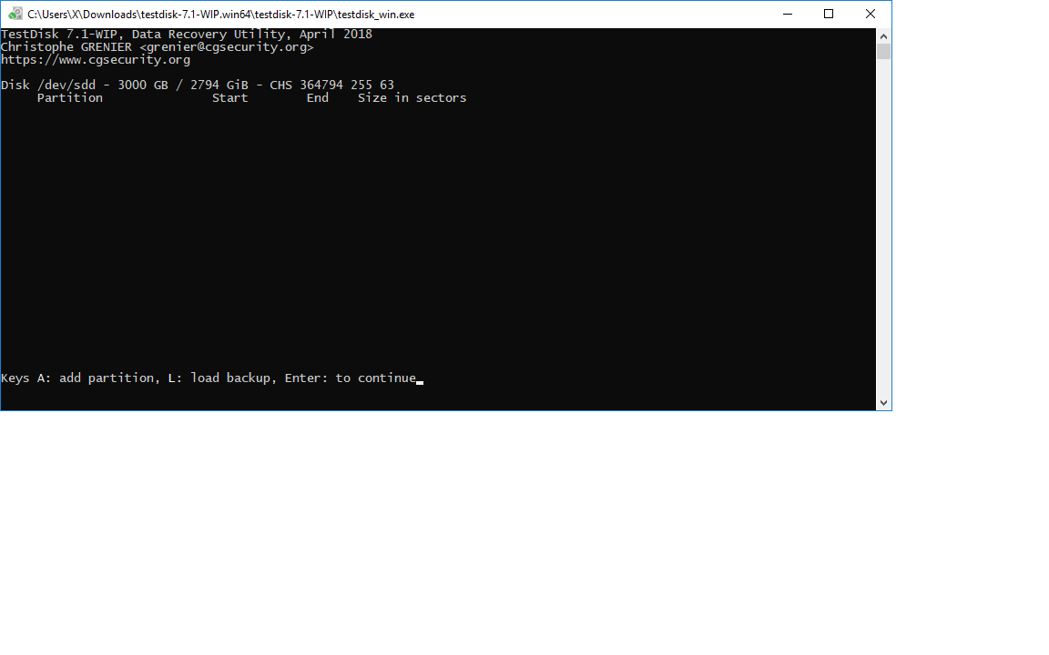

After about 5 days, I completed the TestDisk Analysis. I do not see a listed partition. The choices are A: add a partition, L: load backup, Enter: to continue.
Before completion there were several failed attempts to recognize a FAT partition. This is an NTFS partition.

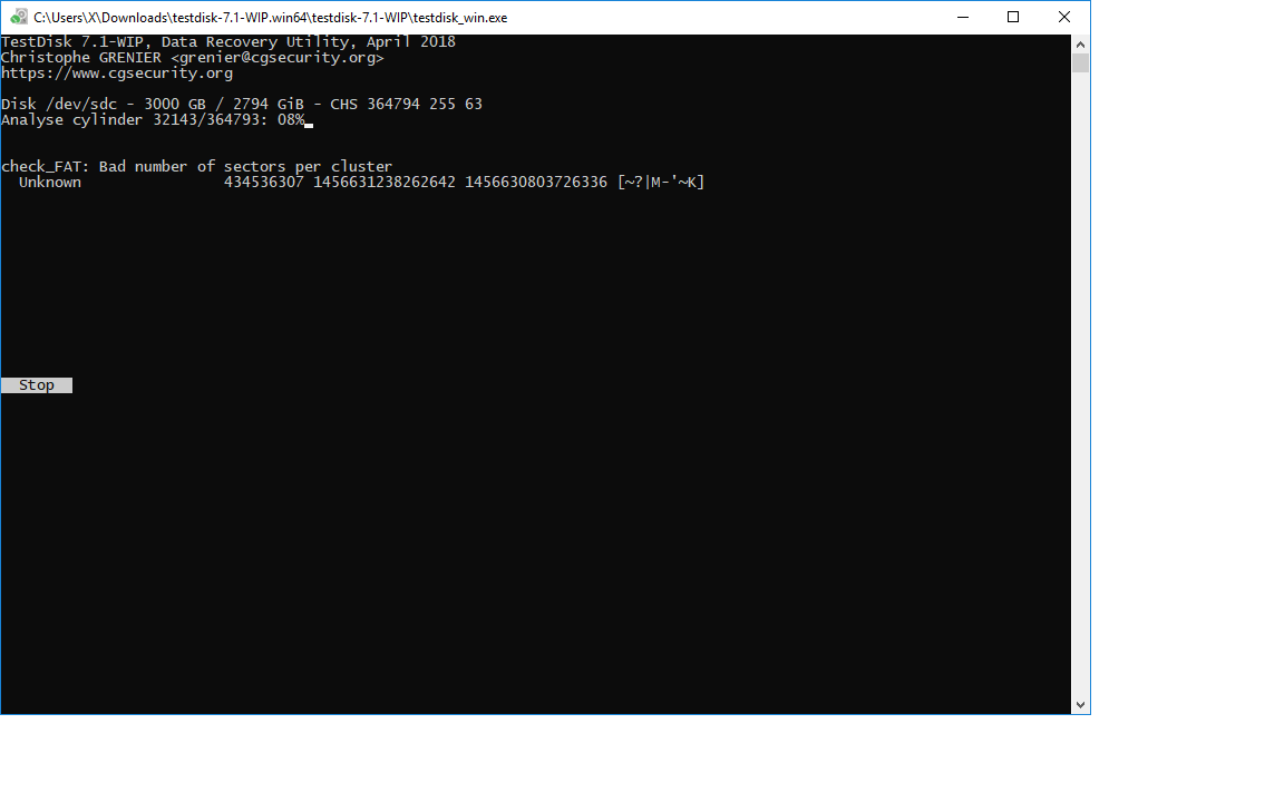

The status message below is confusing. I cursored rightward and chose Backup with Enter, but the "Analyze cylinder..." and the check_FAT messages seem to indicate another Analyze is in progress. I do see a backup.log file created at the right time, but it's size is 1 KB, and it hasn't changed for several hours. Is a backup really being created, or is that contingent on finding the right structures on the fly?
