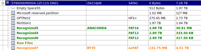

Hello! I've just started using TestDisk in order to recover a lost exFat corrupted partition under linux.
The partition was formatted with exfat-fuse so there's no way of mounting it on Windows and fix it (I've discovered that late).
I might have messed up with TestDisk somehow as now the hard drive only detects HFS+ and fat16 partitions (which weren't there)
With the help of R-Studio I made more light on the situation, after scanning all the sectors..this is the situation of the disk:
The attachment part2.png is no longer available
The partition I'm trying to recover is that exFAT, with the label "BYTE" (Recover7)

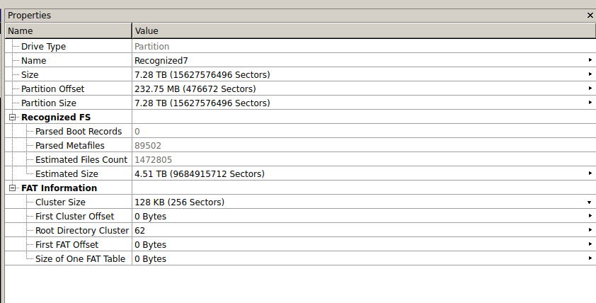

I managed to find out the partition offset and number of sectors involved (see screenshot below)
Is there any way I can recover and keep only that partition on disk with TestDisk inserting the correct partition offset and number of sectors?
Thanks alot I hope you can help :)

If you are using EFI partition table, you can manually add ('a' key) an MS Data/exFAT partition at offset 476672 with a size of 9684915712 sectors.
You can also check the partition listed by TestDisk after Analyse, Quick Search and Deeper Search if necessary.

cgrenier wrote: 18 Jun 2018, 18:37 If you are using EFI partition table, you can manually add ('a' key) an MS Data/exFAT partition at offset 476672 with a size of 9684915712 sectors.
